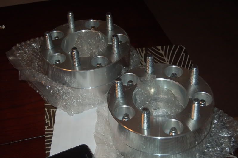

Originally Posted by mrJ View Post
AHHHH!! bad! those are the bad wheel spacers
http://www.spidertrax.com/s.nl/it.A/id.2288/.f
these are the good ones... you need that little lip

Can I ask a question with out being laughed at? Maybe? Okay difference between the silver wheel spacers and the spidertrax wheel spacers.... other then the color? Quality? Construction?

yeah, please explain so i can send them back asap

i run the rough country silver ones pictured above. Zero issues dont believe the hype about sypdertrax. If you have a problem with them then send them back but dont judge before you put them on biased opinion. Alot of people have the conclusion that if there are 2 products available and one is more expensive then that one must be the best. Its a wheel spacer if you have problem rough country will return your money. I see no need in paying $40 more for a "colored" pair of wheel spacers. Just make sure you use lock tight and tourqe them correctly and recheck torque after 500 miles.

The difference is the ridge in the middle of the spacer. With your stock wheels, that ridge will make sure your wheels are centered.

those spacers are fine. your wheels will be centered just the same because the spacers are tapered just like the wheels.....

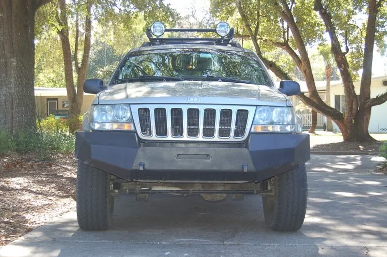

More pictures of the bumper are needed!!

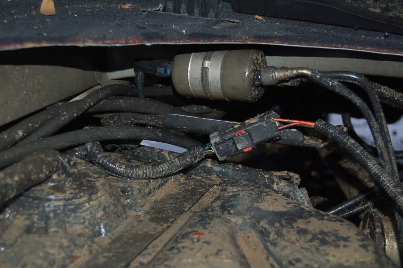

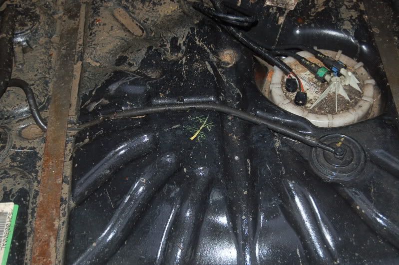

spare tire removal....i'll get some larger overview pics later when i do my wheel spacers...

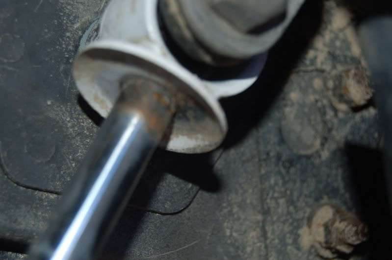

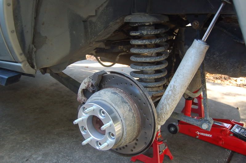

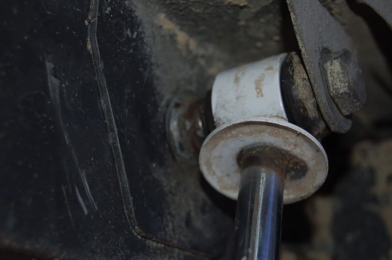

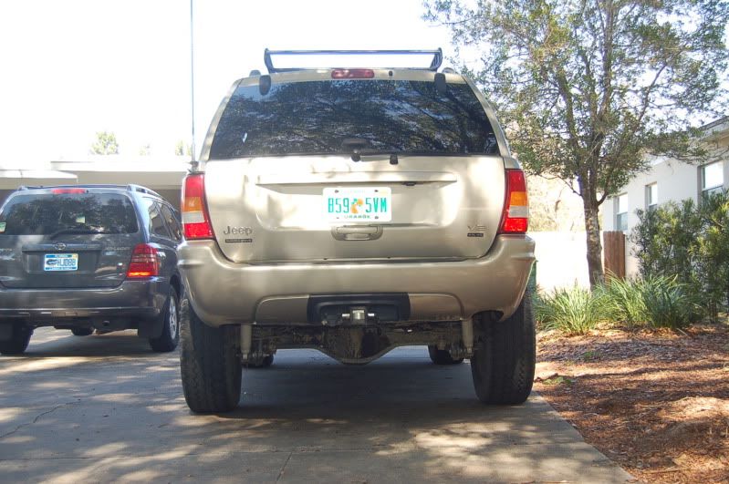

got the wheel spacers on today. now i can turn my wheel all the way and not rub. also checked out the rear shock that was making noise and found the bushing all eaten up. so new shocks and coils will be coming sooner now that theyre needed. here's the stance now too. it's so much nicer to not have the tires tucked underneath. actually looks a little legit now. new meats will help alot too once i get the flow...

also, after installing the wheel spacers, i get random death wobble when im going between 60 and 70mph. if i power through it, it goes away, and sometimes doesnt happen at all. going to get an alignment tomorrow once the shop opens. any ideas? it's obviously the wheel spacers i put on, but why would they make me wobble?
