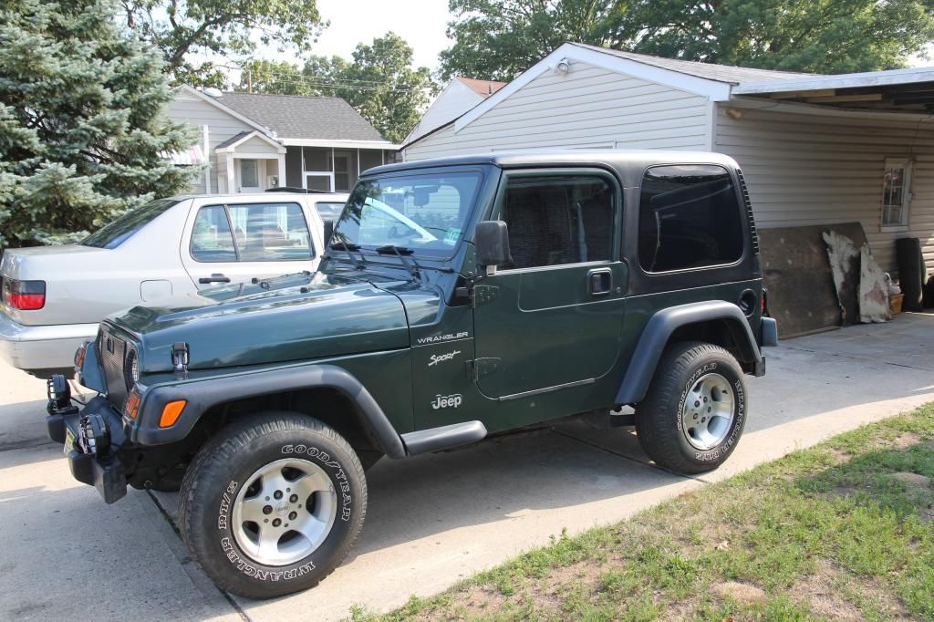

I'm new to the forum but not to the jeep world. Had my first one (YJ) 8 years ago. Got out of jeeps for a while, because life got crazy, but I just sold my pickup and picked up a previous salvage TJ 4.0L on the super cheap. It drives perfectly straight, has zero rust, except for a quarter size spot under the rear license plate and surface rust on the front bumper which i plan on wire wheeling and rustoleum truck bed lining. It was in a front end collision and the grille and hood are just slightly out of whack. I plan on straightening that out better.

Snow Jeep by Larry Fopps Photography, on Flickr
I want a 4 inch suspension lift, i know i need a sye, and rear driveshaft as well. Anyone have suggestions on lifts? I don't want to go long arm, its overkill for me. This thing is a daily driver with occasional trail action.
I'm thinking about the Iron Rock Ultimate short arm kit, Rough Country X series 4 inch, Zone 4 inch, Rugged Ridge ORV 4 inch kit, and the RCD 4 inch kit. Does anyone have experience with any of these or have any better suggestions?

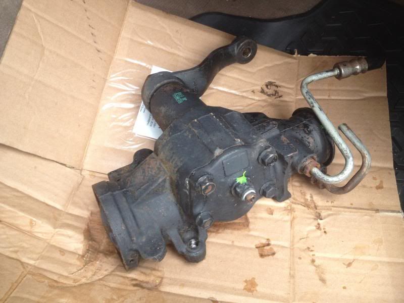

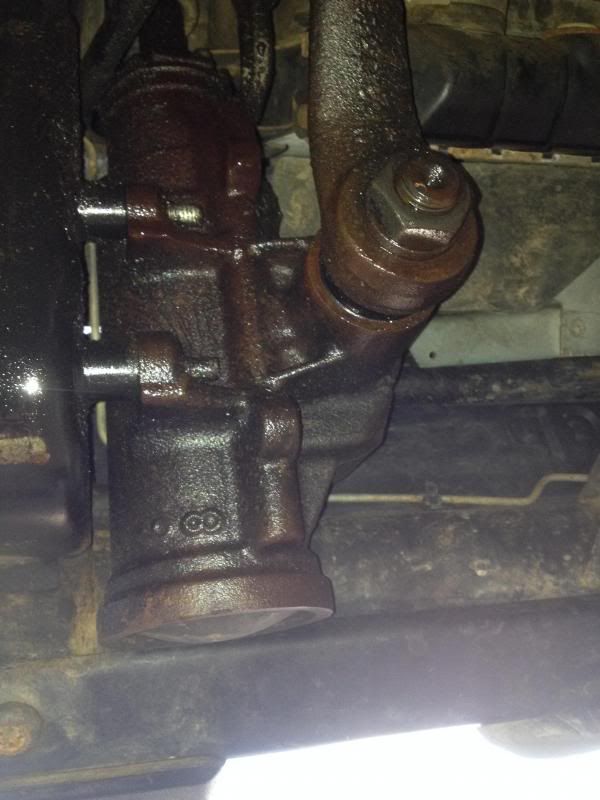

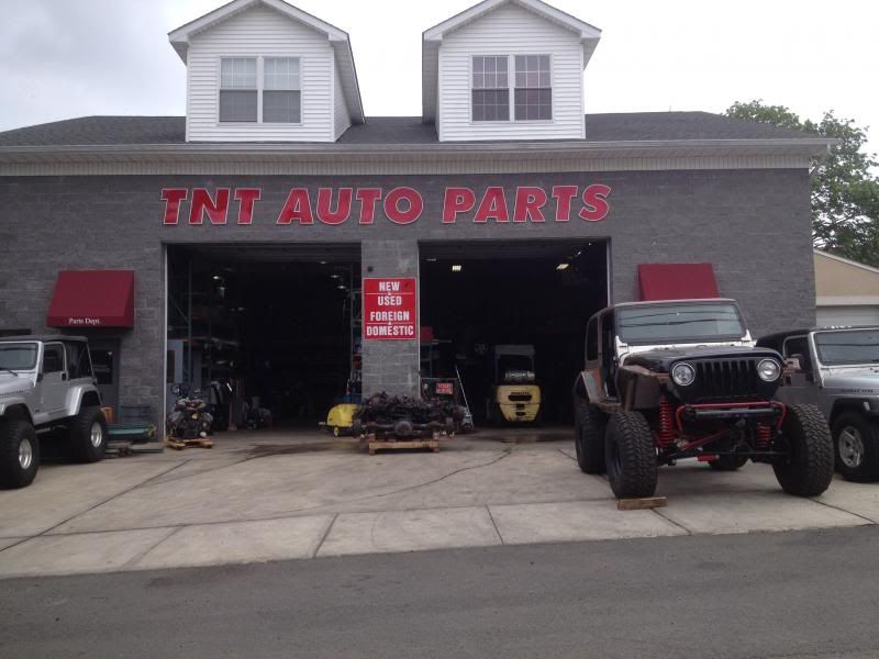

My Steering box is leaking like crazy so i just stopped at TNT and grabbed one that seems to be practically brand new on the cheap

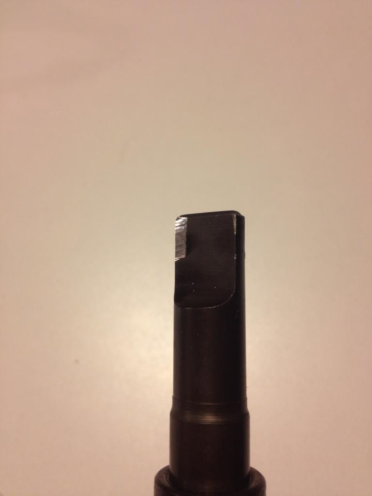

Also, found the source of my vibrations. Rear passenger axle shaft was bent as well as the wheel. Picked up a set of wheels and tires temporarily, also cheap for now until its lifted. Also got a new sailcloth replace a top.

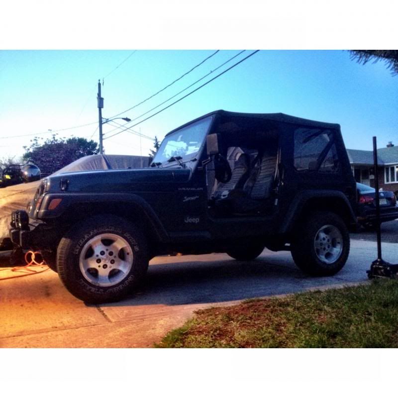

And here it is with the new top and temporary wheels.

Replaced the steering box today, so that's finally taken care of. Now i have to do the front axle seals as i have some seepage from the shaft on the front driver's side. Other than that still been collecting parts for the lift. I got in the JKS track bar and crown HD steering kit. At this point i just need extended brake lines and tires and i'm good for install.
