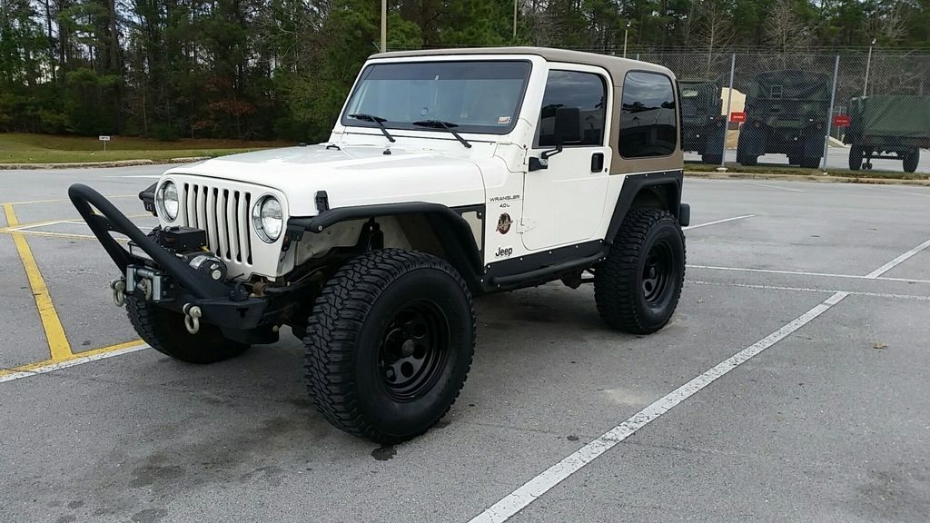

Hey guys, I posted a build thread on my local jeep forum. I figured it was time to show off my jeep on a bigger forum!! Here is my list of parts that I already have and what I am ordering. I am including the best prices I could find on the parts as well. Feel free to tell me what you think of my list and what you would change (If any) I have edited my list as my build has changed!!
What I already have:
- Treadwright 5x315/75R16 MTR knockoffs with BFG A/T 3ply sidewall ($873)
- Rugged Ridge 8500lb Winch ($280)
- Rubicon Express Hand Throttle Kit ($35) Yet to be installed!
- MetalCloak Front/rear fenders with rocker guards ($1900 shipped)
- 5x BlackRock 16x8 wheels ($365)
- ORF Fab Stinger front bumper ($380)
- LOD Xtreme Duty tire carrier rear bumper ($500)
- JKS 1.25" Body Lift ($121.50)
- JKS 1" MML ($72)
- 2 Inch BB lift (FREE!!)
- Currie Adjustable control arms ($1000)
- UCF engine/trans skid,ultra high Tummy Tuck skid, Aluminum Gas Tank skid, and lopro mount ($900)
- Riddler Differential Covers x2 ($210)
- SYE with local built driveshaft ($500)
- zone 2" nitro shocks ($160)
- 4.88 gears for Dana 30 and Dana 44 w master install kit ($485)
- spartan locker for dana 30 ($260)
- grizzly locker for dana 44 ($550)
- Novak cable shifter ($150)
- pro comp steering box skid ($58)
- Cree 12" led light bar ($50)
- cobra cb radio w/mount and firestick ($200)
- Flowmaster ($80)
- ZJ steering ($60)
- 2" wheel spacers ($80)
What I am going to get:
- roll cage
- Bump stops
- power adder
- trail gear (welder, compressor, etc.)
- pull carpet and line the tub
Well, That pretty much completes my list for now. I plan on doing most of the work myself. Just scroll down to see all the build. Like I said if you guys see anything outta place or something I should change, don't hesitate to comment! I plan on doing a full write up on this so keep posted for pics and review!

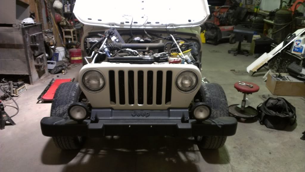

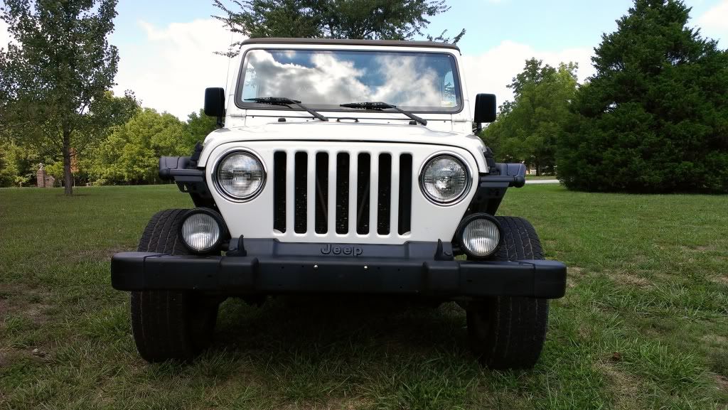

How it looked when I brought it home

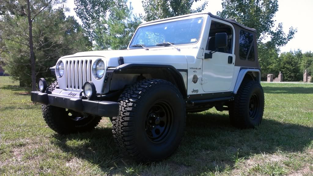

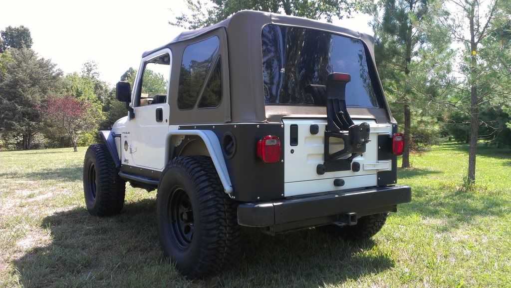

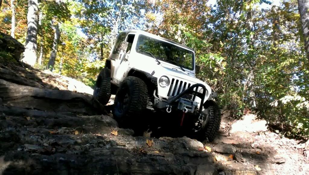

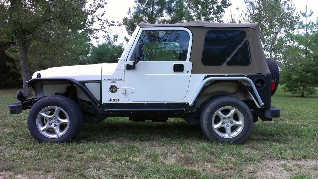

How it looks now
01 TJ 5spd 4.0 Metal Cloaked on 35's

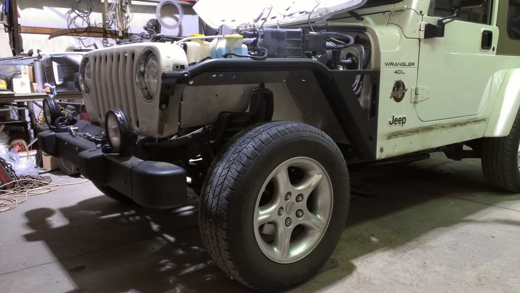

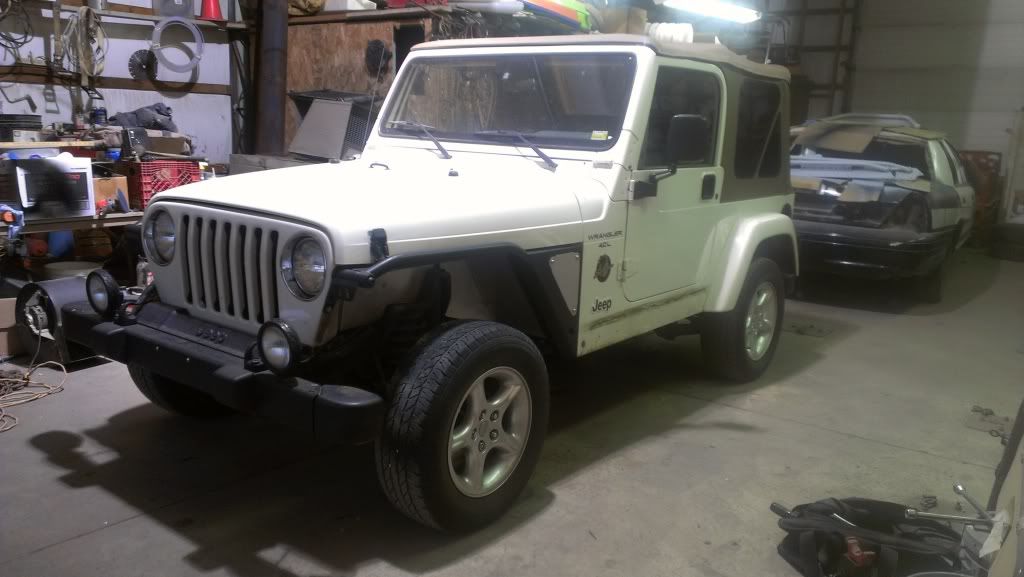

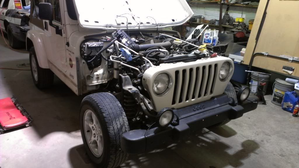

I planned on putting a bigger lift but fell in love with the metalcloaks and I love the idea of staying low and stable but having the clearance for 35s. So I got metalcloak front/rear and rockers. I opted for the 4'' fender flares. The instal was very easy!! The hardest part was drilling into my virgin tj!!
About to start!!
Don't mind the primer rear flares. They are painted now, haha!!

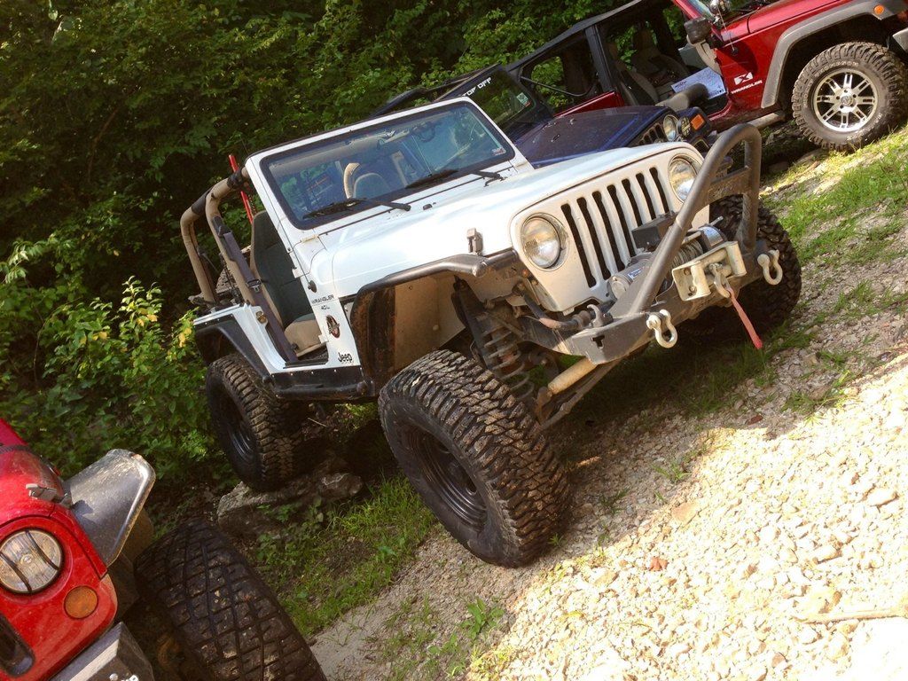

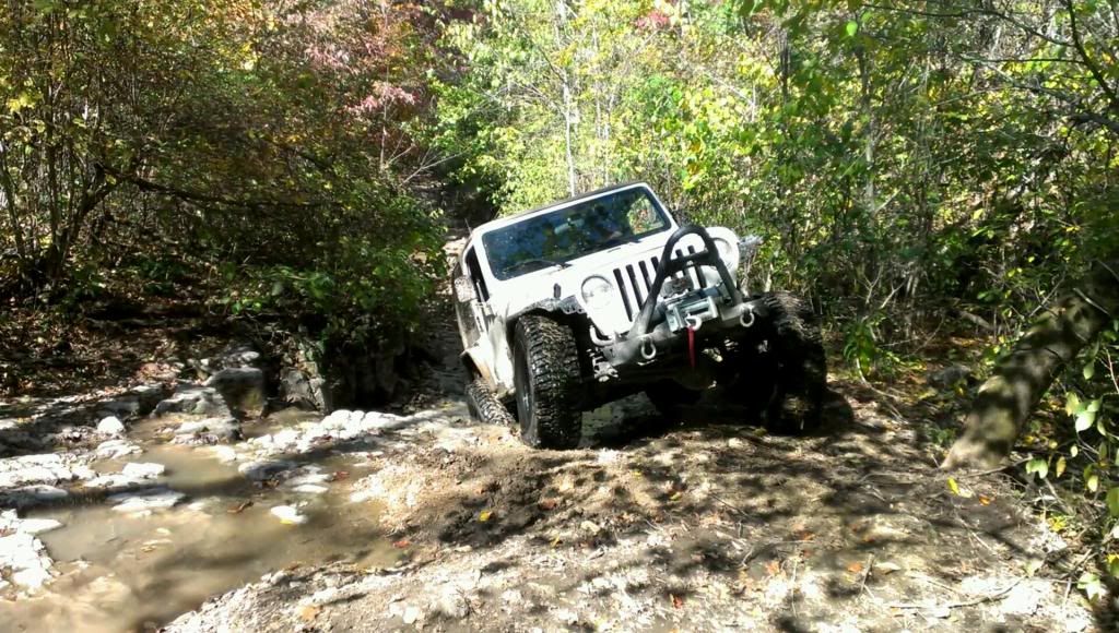

I went to SMORR last week and had a blast!! I met some great people and did some awesome trails!! Thought I'd post a few pics up! I didn't come out unscathed though. I bent a front lower control arm!! Which is just a good excuse for me to order some adjustables!! Just got to decide between Currie or rokmen!! (Opinions?)I also need engine,trans, and gas skid. I was trying to decide between rokmen or UCF.(opinions?)
