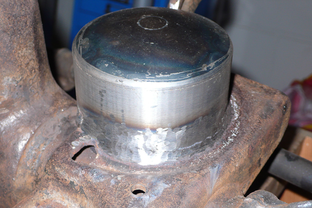

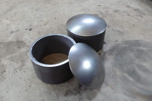

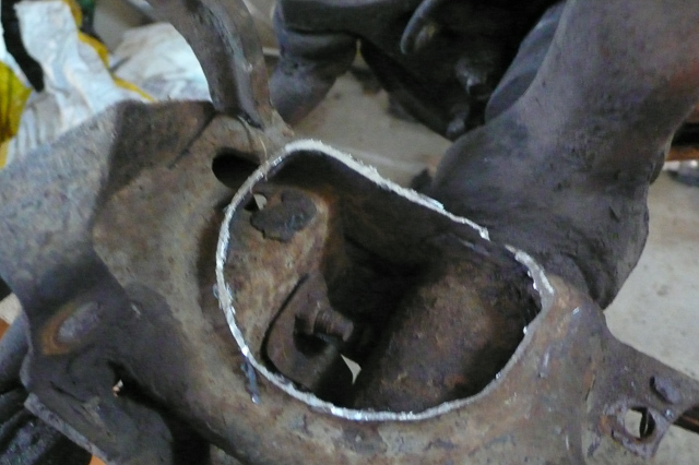

Dana 30 coil spring locators rusted
Finally got some stuff done...
Removed the axles, tranny and bumpers.
When the axles were out and I started to remove the old paint, I recognized that my Dana 30 was heavily rusted:
Cutting away the rust left me with this:
So I needed to fab some replacement from steel tube and weld-on tube endcaps...
...and weld them to the axle:

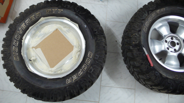

That was the major stuff... also did some paint works:

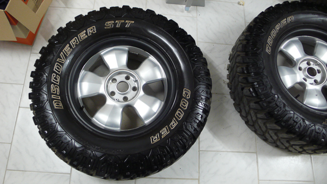

Plasti dipped my rims...
...and painted some stuff red:
Next step is finishing the axles... Paint them black, rebuild the brakes and store them until I finally got the MetalCloak control arms.

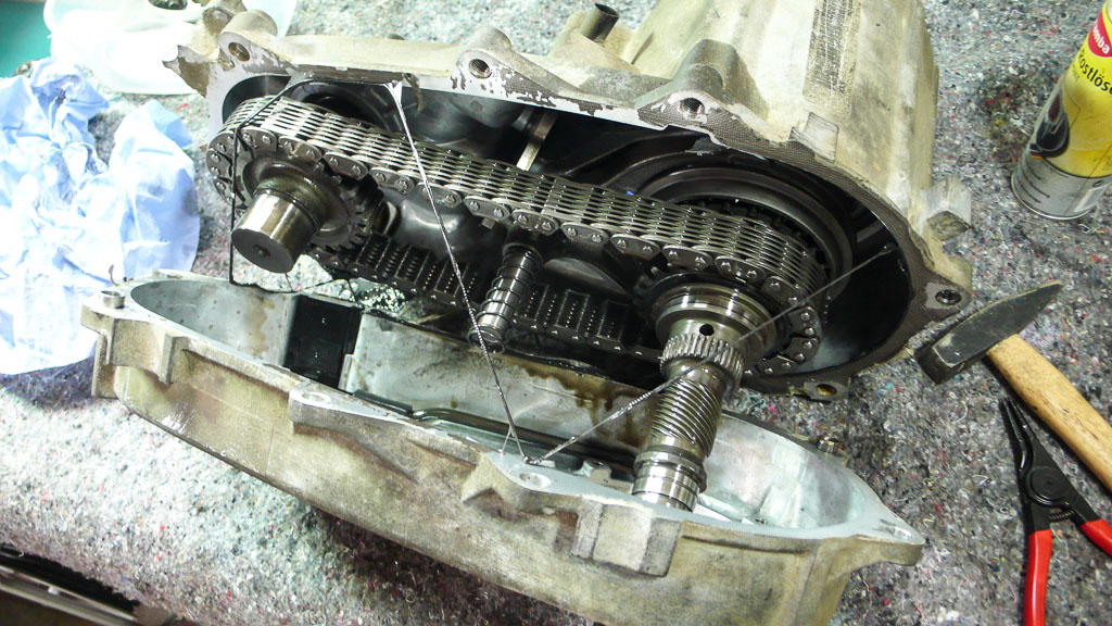

NP231 J rebuild questions...

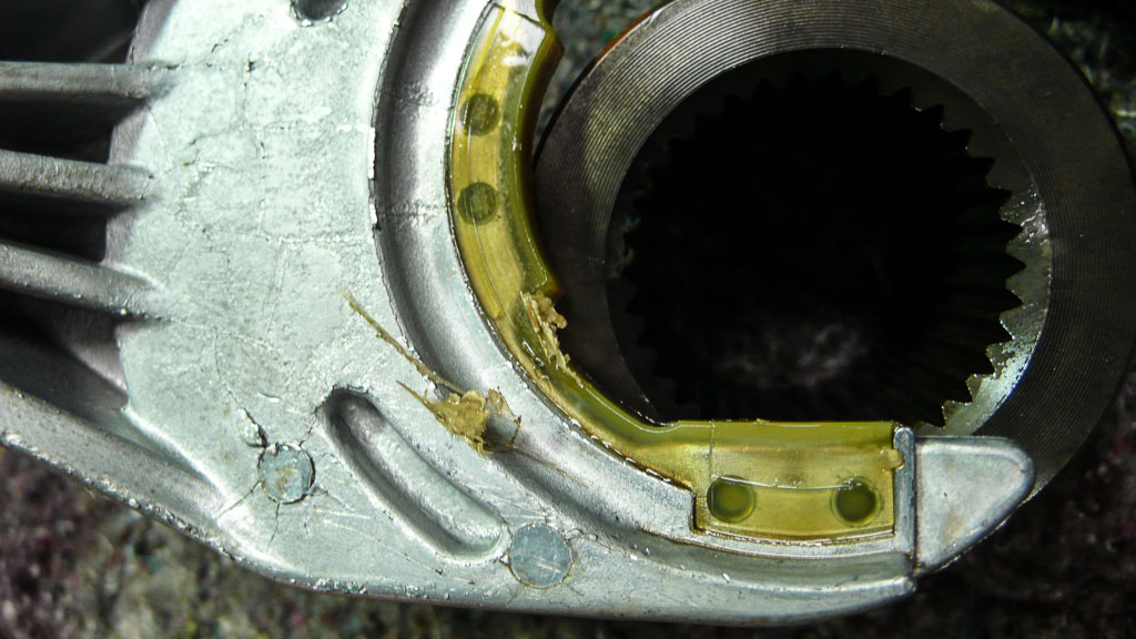

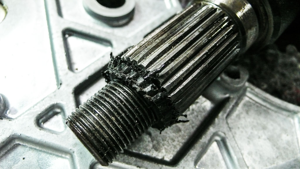

And again some progress. Took apart my NP231J for rebuild and SYE installation:
And here are two questions for you...
Is this shifting fork still ok? The plastic part looks quite worn to me, but i have no reference of how it SHOULD look like when new.
And this rubber part... what is it for and is it supposed to look this weird?
ckdotnet is offline
post #11 of 14 Old 01-16-2014, 10:26 AM
dayriesw
dayriesw's Avatar
1987 MJ Comanche
Location: Louisiana
Posts: 6,140
Shifting fork and rubber part both look fine. Just put them back in where they were when you assemble.

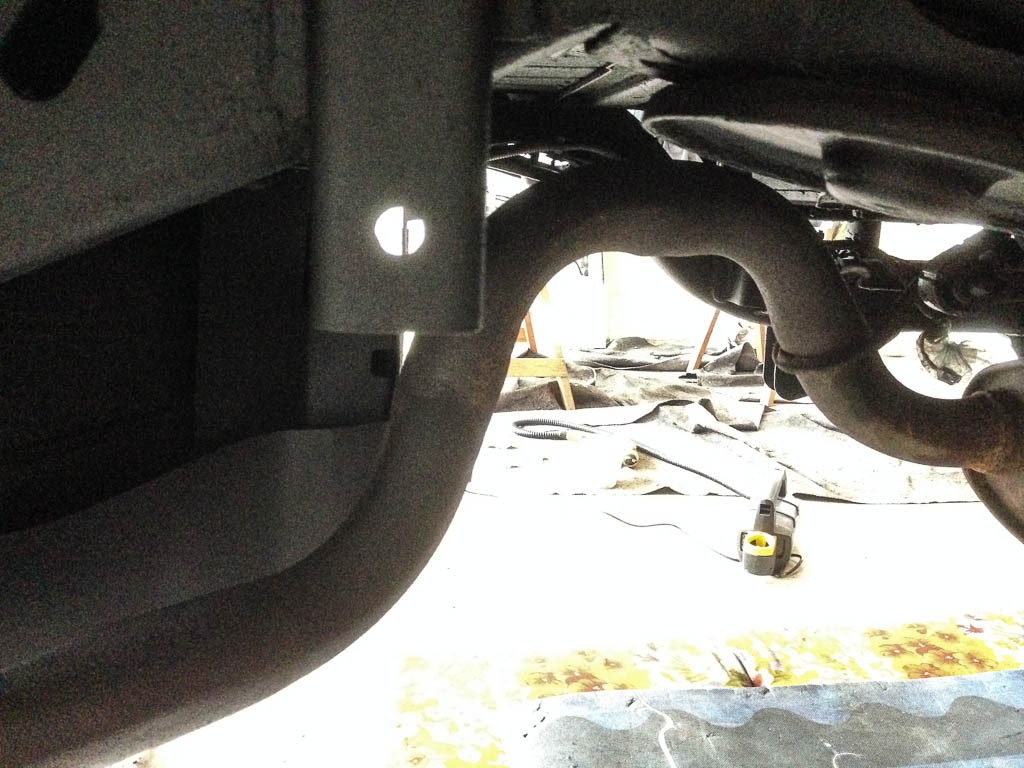

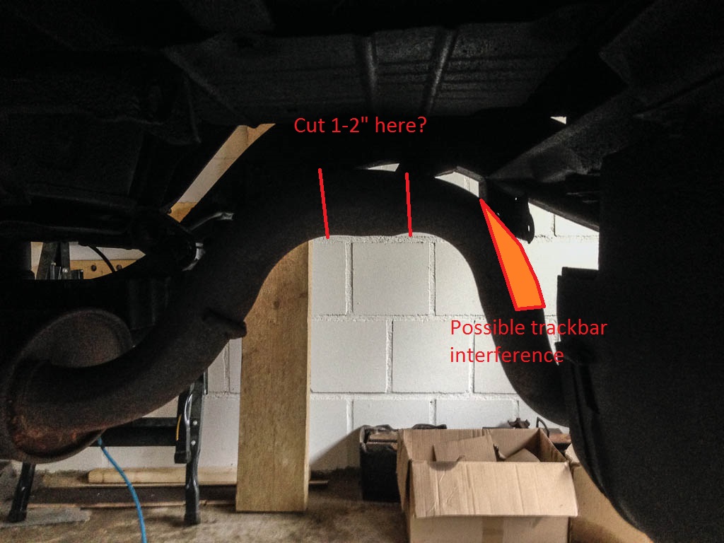

[TJ] Exhaust/Trackbar interference after belly up install
Finally made some progress again, but ran into some difficulties I have no experience with...
I installed the Teraflex Belly up, the modified NP231J and a 1" MORE Motor lift. Now I am seeing/expecting some Trackbar/Exhaust interference...
What do you think? Should I cut a piece of the exhaust and weld it back together like this to make some room for the trackbar?
Some input on this would be great... Unfortunately I have no idea how much room I need to make for the trackbar.
ckdotnet is offline
post #13 of 14 Old 05-02-2014, 05:30 AM
84jeepcj7rock
Location: Marietta
Posts: 1,496
I can't see very well on the phone but the only real way to know you have enough room is to pull the springs and set the jeep on the bump stops.
84jeepcj7rock is offline

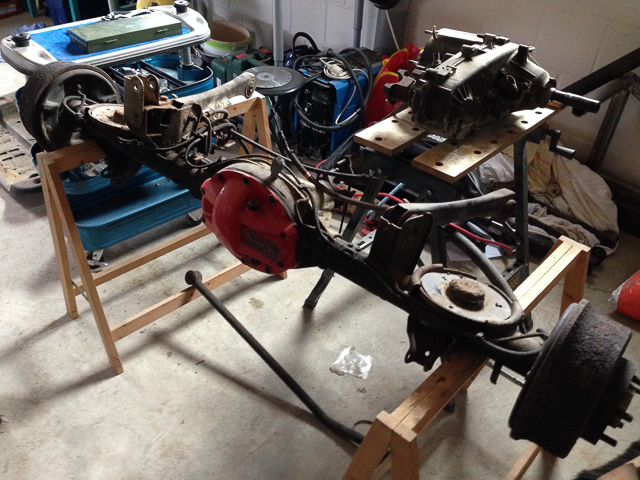

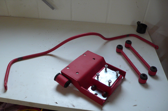

[TJ] Rear Axle is back in...#metalcloak
Update: Reinstalled the fresh painted rear axle.
Together with my new Metalcloak control arms, rebuild swaybar and trackbar, new RE trackbar bracket and Tom Woods driveshaft to fit the SYEd NP231.
So I had a very motivating Sunday with good progress on the Jeep, sunny weather and BBQing with friends.
ckdotnet is offline
