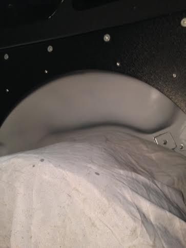

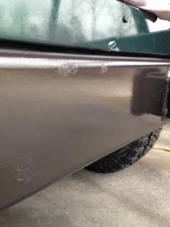

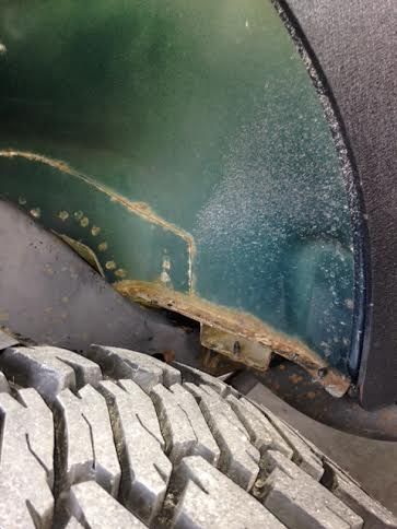

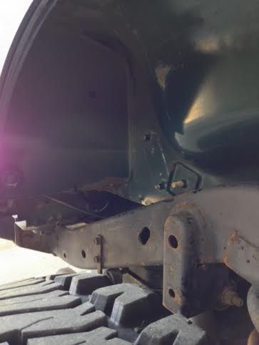

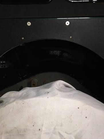

We've had acceptable Spring weather for the past couple of days so I've taken advantage of it by performing the below. I am pleased with the results, as hopefully most of the surface rust is now stopped.
-Shampoo seats (no pics, but the water came out pretty dirty so they're much better than before)
-Sand, prime, paint the gas tank skid
-Sand, prime, paint the rear inner fenders
-Sand, prime, paint the rear bumper + tire carrier
Gas tank before, during, and after:
Rear inner fenders before, during, after. Apologize these pics are not the best as it's dark in the fender well.
Bumper during and after the first coat of hammered black. I put 2 thicker coats down after this pic and many of the imperfections are better masked
This is the type of care this Jeep needs. The frame and axles look terrible against new paint, but I am waiting until Spring when I have several days of good weather to address those.
