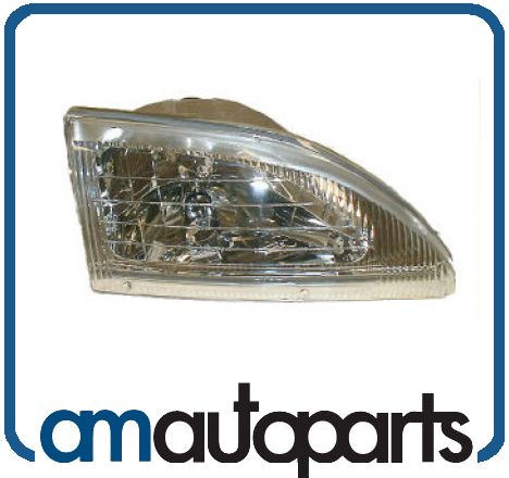

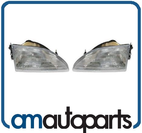

I have hid's in the stock housings on my 2002 explorer and have absolutely no glare issues at all. It even passed mass state inspection and the guy new what was in there because he asked. He put the truck against the headlight aiming board to see the aim and pattern and was surprised to see that there good to go. I have put hid's in regular rippled housings with bad effects, but have never had issues with a factory clear headlight lens housings.
Certain housings do respond better to hid's but they still need to be aimed according to light output. No housing or hid bulb is exact. They all need to be aimed after installing hid's.
I put some in my mustang with factory headlights and ended up selling them because of glare issues. It had the rippled type housings like these:
The reason is the inner reflector is not designed to spread the light output efficiently, so the lens has that rippled effect to help spread the light output evenly and efficiently. When you add a bulb that creates a crazy light pattern into this type of housing, it gets even worse. There is no aiming to these that could eliminate all glare, because of the rippled housing. Even though you aim them down, the light still hits the ripples and bounces back to the reflector or gets it angle changed and exits the housing.
I put some in my 02 explorer with factory clear housings and have had "no" negative effect with glare. I even had to aim them up a bit after the install. this is a pic of the factory housing:
I've been driving with these installed for about a year now and have "never" had anyone flash there high beams at or been pulled over because of them. It even passed mass state inspection with them on.

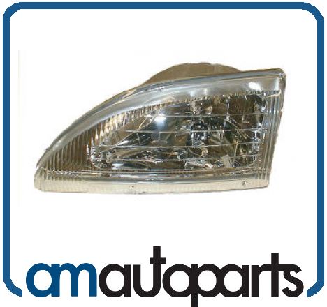

The reason is the inner reflector is not designed to spread the light output efficiently, so the lens has that rippled effect to help spread the light output evenly and efficiently. When you add a bulb that creates a crazy light pattern into this type of housing, it gets even worse. ....
That being said, I wonder how the Cobra version of the above lens (shown below) would perform with an HID bulb? It has the smooth surface with no outer refractor.
