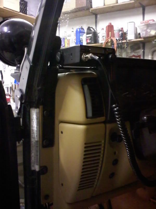

Here is how I mounted mine. I made some metal brackets, took some measurements, bent em 90 degrees and bolted them to windshield frame using the bolts for the visors. Extremely sturdy, I can just about stand on it. Doesnt move or wiggle. Bottom speaker is easy to hear at speed with the top off.
For the Antenna mount I made a fender mount. Small peice of metal, rounded the edges, drilled two holes, put a backer plate under the lip of the fender and drilled a 3/8 hole for the mounting stud.

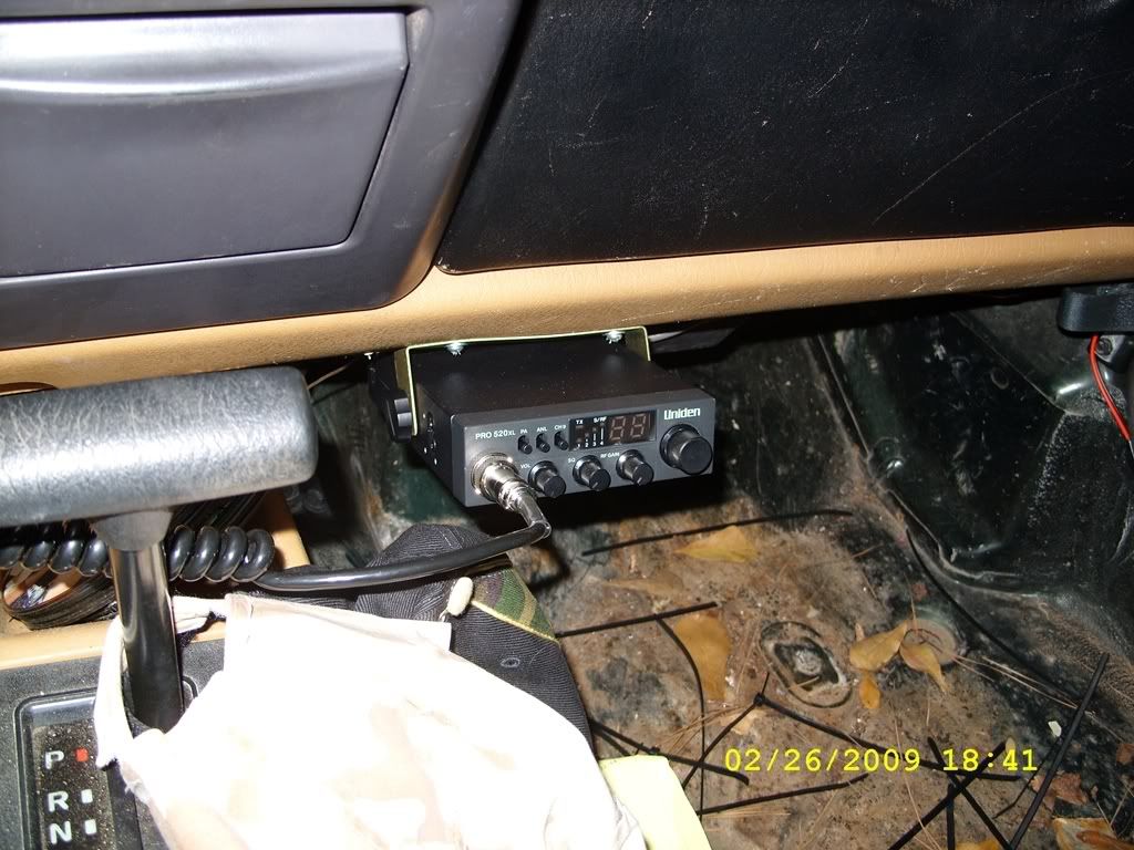

I feel like I'm posting this everywhere, but I just moved mine.
I copied the Jeep Outfitter mount
