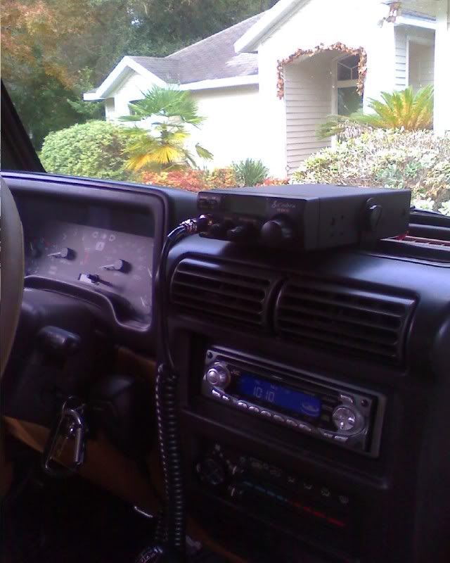

I was going to cut out the dash on the passenger side and flush mount it into the empty space were the air bag was. I will get some pics up when im finished. I havent found an antenna for my liking yet. Any thought on the 4' firestick.

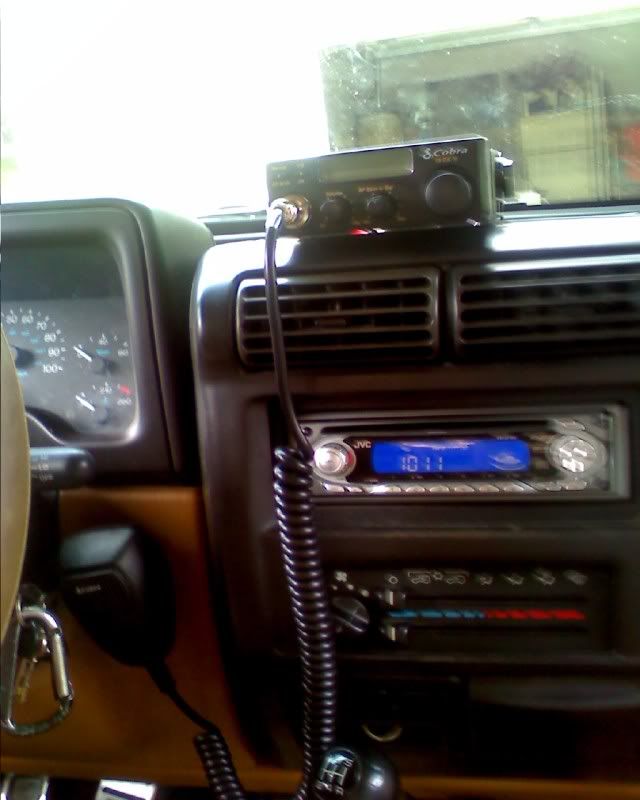

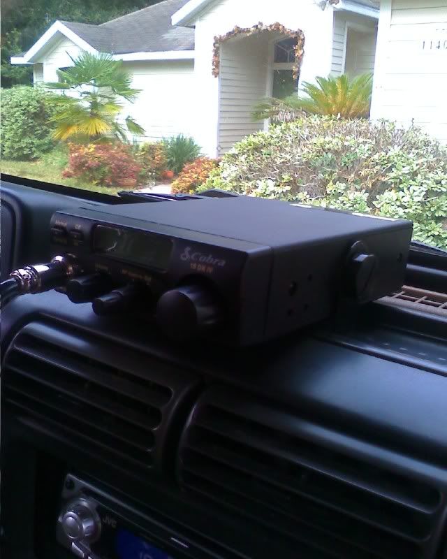

Posts: 727

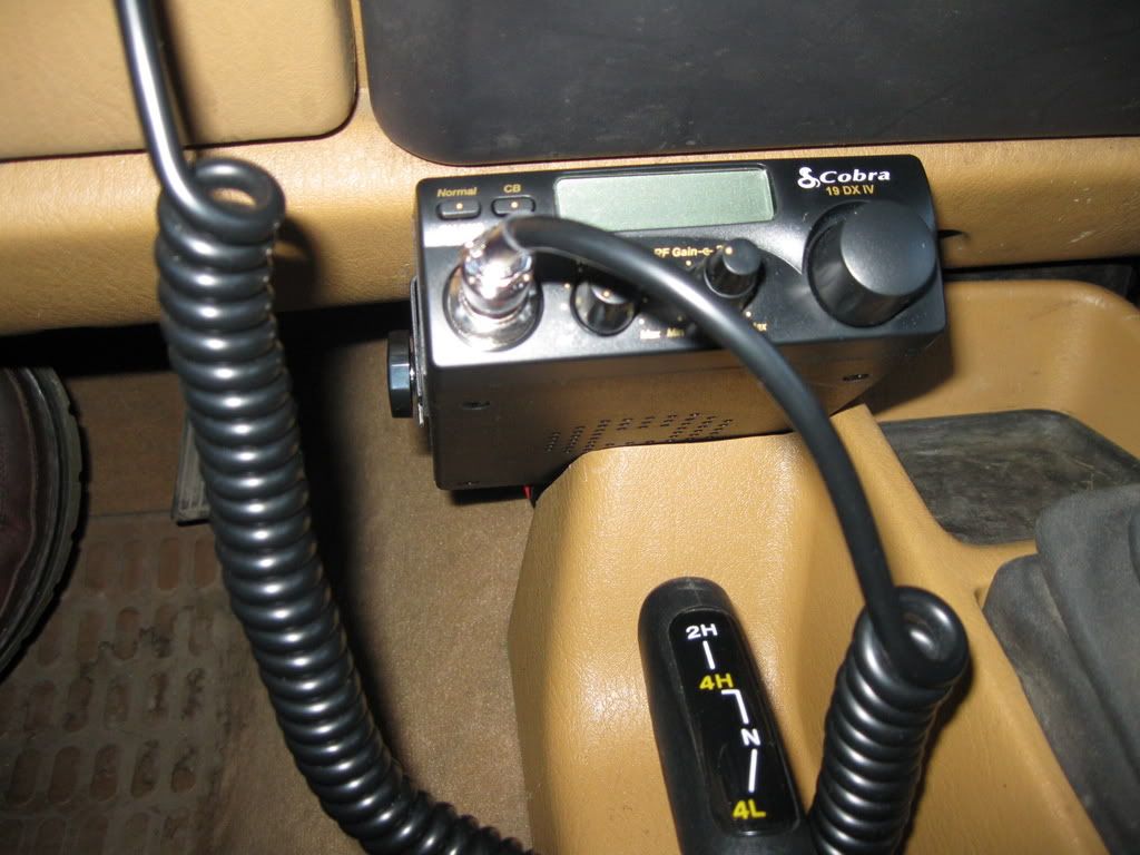

This is the first place i mounted my CB. now it sits a little lower and angled next to the t-case shifter.

Posts: 1,211
that's how I mounted mine, tho direct over the skinny pedal and I use the driver side dash speaker to hear it.

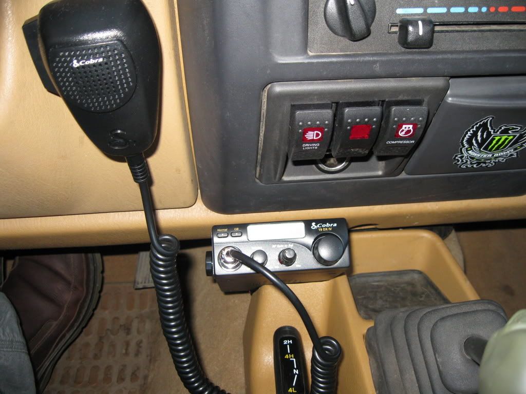

This is how I roll! Just Notched the console and mounted the mic with one of the factory screws

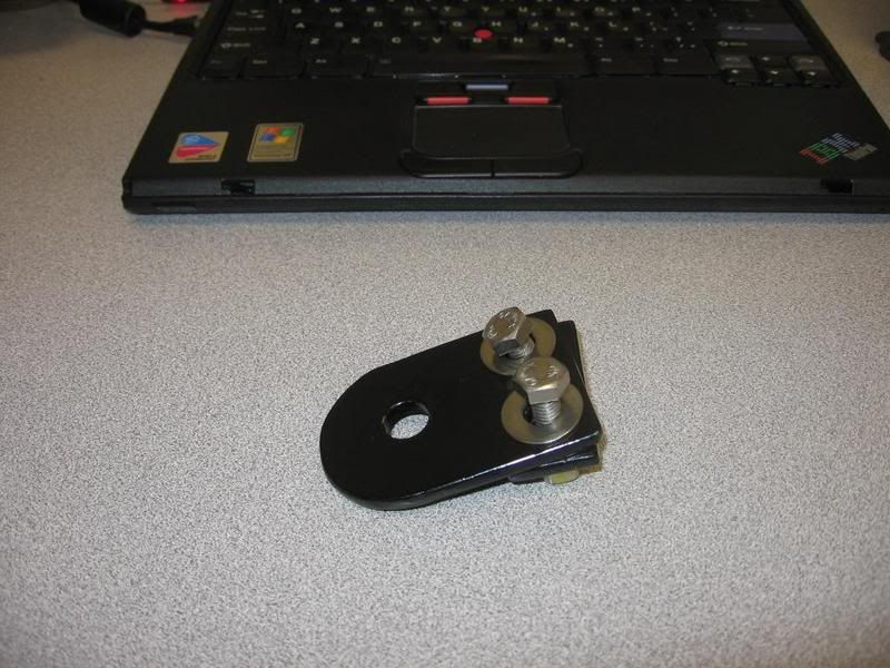

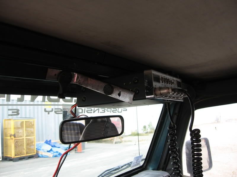

Here is how I mounted mine. I made some metal brackets, took some measurements, bent em 90 degrees and bolted them to windshield frame using the bolts for the visors. Extremely sturdy, I can just about stand on it. Doesnt move or wiggle. Bottom speaker is easy to hear at speed with the top off.

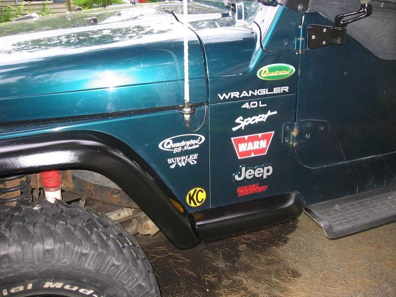

For the Antenna mount I made a fender mount. Small peice of metal, rounded the edges, drilled two holes, put a backer plate under the lip of the fender and drilled a 3/8 hole for the mounting stud.
