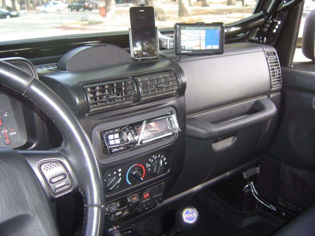

With a quality set of neutral speakers it should be fine to have the speakers in your ears (don't go with anything bright). I don't recommend separating the tweeters from the woofers like that if they are a pair. If powered correctly you should have a balanced sound coming from the front to match the rear speakers. Replace the front speakers and match them with what you put in the pods above your head. What are you powering the subwoofer with? Personally I like Focal and run an Alpine SWRT10 subwoofer in my center console. Here are a some pictures of what I did (and do for a hobby business).
Sierra Mountain Enterprises' Slim line Subwoofer Console
Alpine 9855 Receiver
Sierra Mountain Enterprises JeePods housing a pair of Focal PC165 speakers
I Removed the stock speakers from the dash pods and replaced with a set of Focal Polyglass CVX 100 speakers (4"). I had to cut a hole out of the back for them to fit but they sound great. If your model doesn't have pods you can find a set on Ebay fairly easy.
All powered by an Alpine PDX 5 (75 watts RMS x4 plus 300 watts RMS mono) located in my glove box. I recommend sticking with Coaxial speakers in a TJ, makes things easy and the sound can be positioned/properly directional (the tweeter centered in the speaker is the best location for most applications). Alpine makes a reasonably priced power pack that is small and will fit in your glove box or behind your dash, puts out 45 watts RMS and really all you need (something to consider). Hope this helps, you can check more out on my website if you like.
