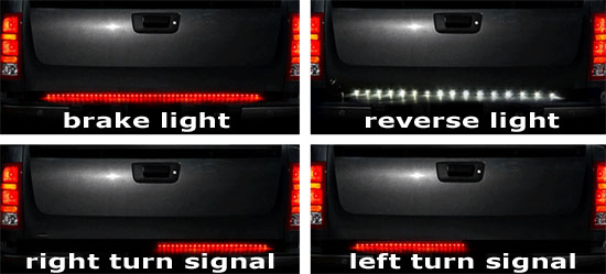

Tailgate LED Strip for Reverse Lights Only?
I was just curious is anyone knew how to set up one of those LED tailgate stripes for reverse lights only. The previous owner smoked the taillights and my windows are tinted so I really can't see much when backing up at light. Also, I don't think the LED stripe would look too good with running lights, brake lights, or turn lights, so I just want it to turn it when reversing. It looks like they typicaly just plug into the tow harness. Does any one know how to set this up?

I have one on the rack of my ZJ. Honestly it doesn't throw much light. I'd recommend finding another led source if you want some use able light. But for wiring, my Recon plugged into the trailer plug, hard tapped the reverse line.
