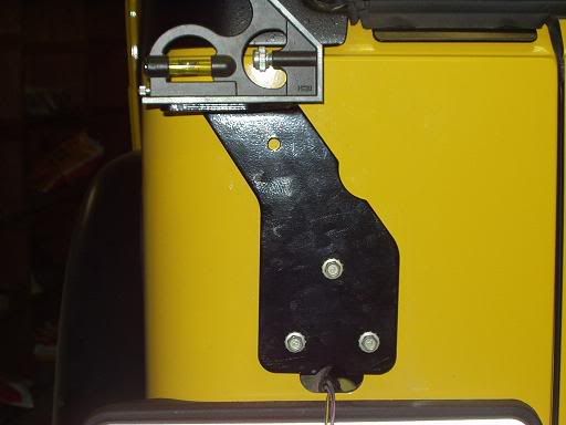

Do you have a picture of the grommet? I was thinking of installing it on the passenger side so I can wire it through the hole in the tailgate.

Yes I posted it in another thread about grounding I think It,s in the driverside corner by the roll bar. Where the wires for the taillight go through.

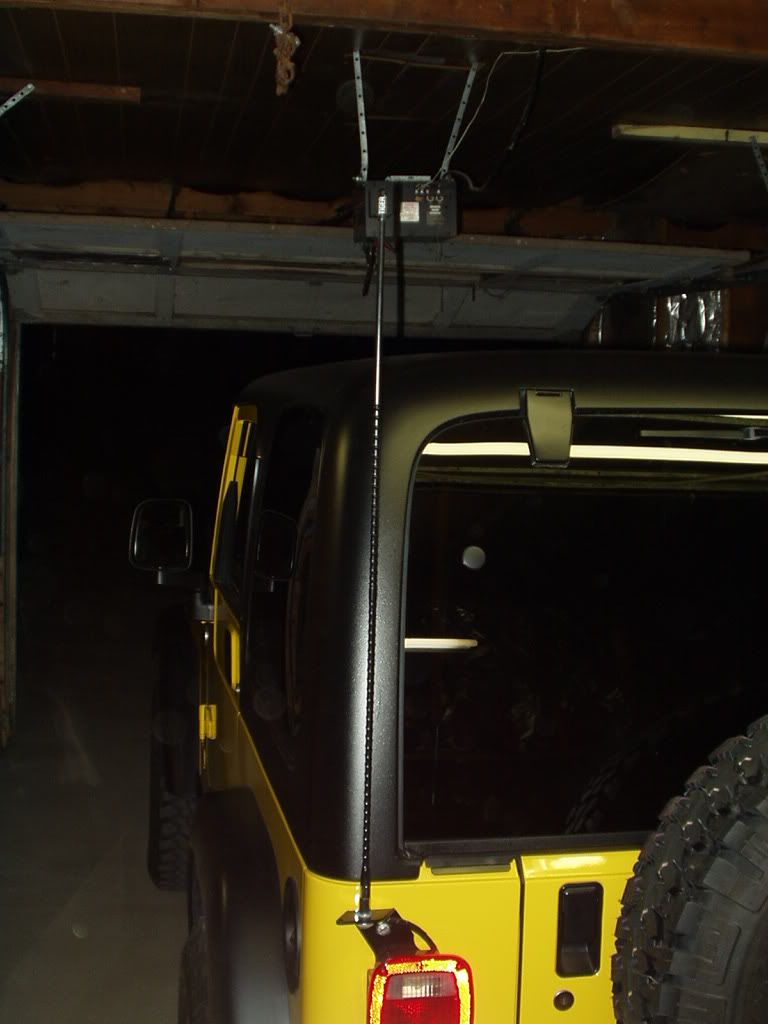

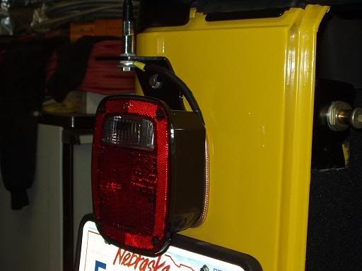

Yeh, goes through a hole at the taillight.
Up through the wheel well (its protected by a plastic drop down cover) up through that grommet. Along the tub and to the radio.
The other end comes out by the tailight and goes up to the antenna.
Here the whole thing

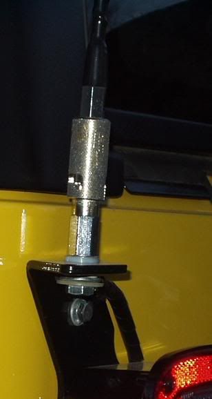

Yes you can run a regular stud mount and a quick disco. Here is the one I use. Picked up from a truck stop.
