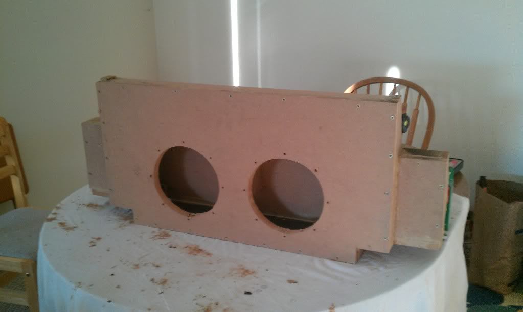

i don't think there's any way to fit 2 10's under the seat let alone having the right internal volume for the enclosure. I'm sure you've looked at plenty of pictures so far but here's how big mine is with two shallow mount 8's

Is your box height 3.5" or 4.75"? I think I could easily fit this box under there if I raised the seat a bit.
3.5 but you have to add a bit for how much the subs hang out too. Could work, I've just never seen it done. It's not that bad gutting the seat. And if you screw up or want to take it out later there's always Craigslist. Seen seats go for 75 bucks.
