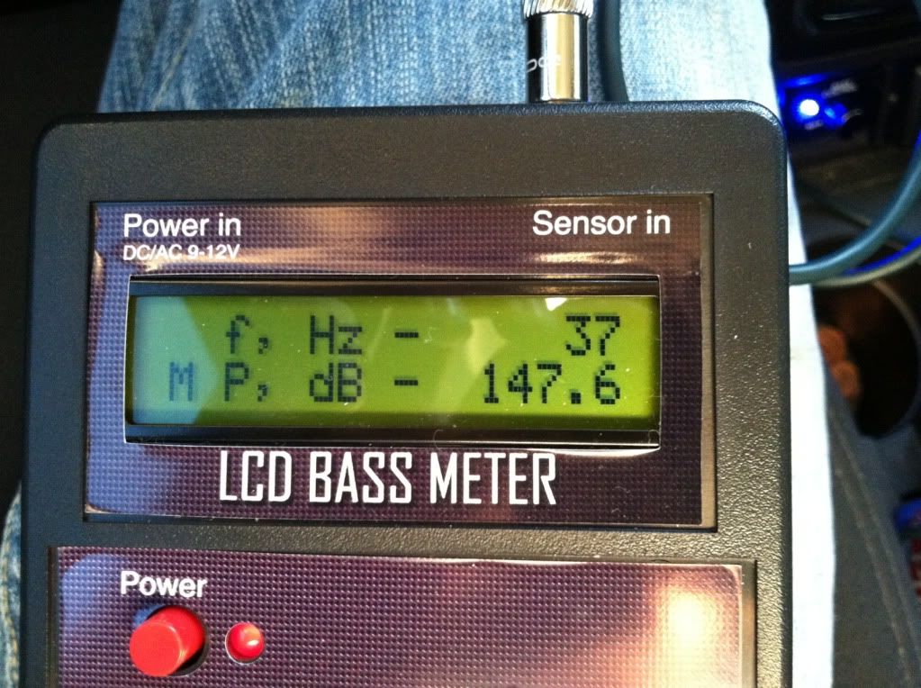

Yea these newer woofers are starting to get a little crazy. They have a fair amount of suspension travel. They have a nice amount of motor force as well. So if you don't have crazy power, you can use cone area to your advantage and put them in an efficient enclosure and they'll play pretty low. All those woofers are about the cone area of two 15's. But being in a 6 cubic foot enclosure with tuning down in the low 30's, it gets down. It did 147.6 dB yesterday peaking at 37hz.
And that's with the amp gain at about 9 o'clock. She's got more in her.
