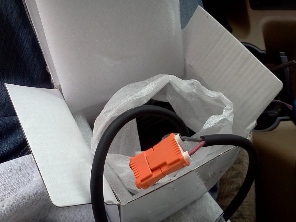

Well recently I purchased 2in led fog lights from Seward Offroad. They are a fairly new company I think only a year or two old. They have light bars all the way up to 50in for a little over $500. I was told they are suppose to be releasing their aqua series and light brackets at Jeep Beach this year I can't wait to see their brackets they will probably be a fraction of the cost from other companies. They are $124.99 plus shipping. Jake and the guys down in Florida are really awesome guys and are jeep enthusiast. Well first off they were packaged very well with Styrofoam around all sides.

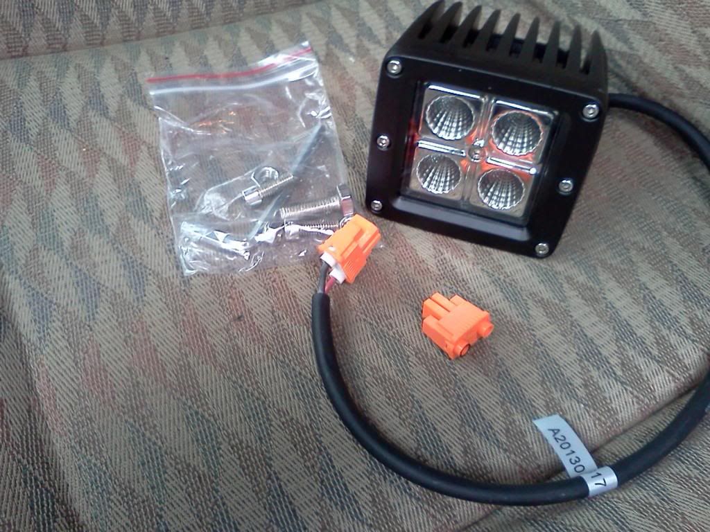

They give you all the mounting hardware and I was very surprised they even supplied me with the other end of the connector. You can see on the end of the connector the one opening is black and im sure you all know what that means thats where your negative wire goes.

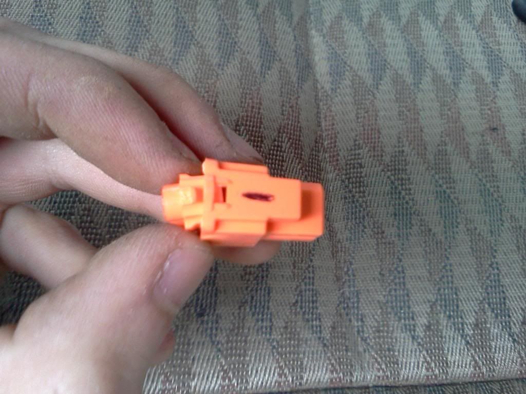

Now before I took the connector apart I went ahead and made a black mark on the outer shell of the connector on the negative side to make sure I put it back together right if that makes sense. I used a very small screwdriver to get the connector apart.
Once I got the connector apart I pushed the wire through and bent it over the connector and when you put the connector back together it smashes the wire on the terminal and makes a good connection. You could probably solder them together for more security but my gun wasn't working. Another reason I didn't solder them was because I pulled the connector apart that they did and that was how they did it and it was in there pretty solid. When I installed the connectors on my jeep I went ahead aput silicone around the wires just to make sure water would stay out then I taped the connector and zipped tied it up.

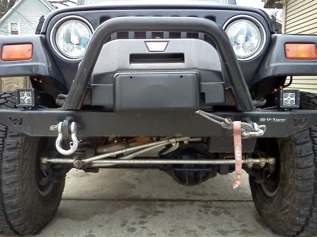

I think they look awesome on my jeep next thing is a 30in on the hood.

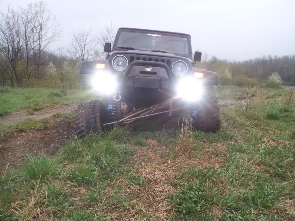

Out playing today with them on I think it looks a lot better than with the regular fog lights on the bumper.
I will get pictures posted up of them at night. They are so bright I can barely even tell my low beams are on. My brights are quite a bit brighter and shine farther, but these are the fog pattern and not the spot pattern so I kind of expected that
