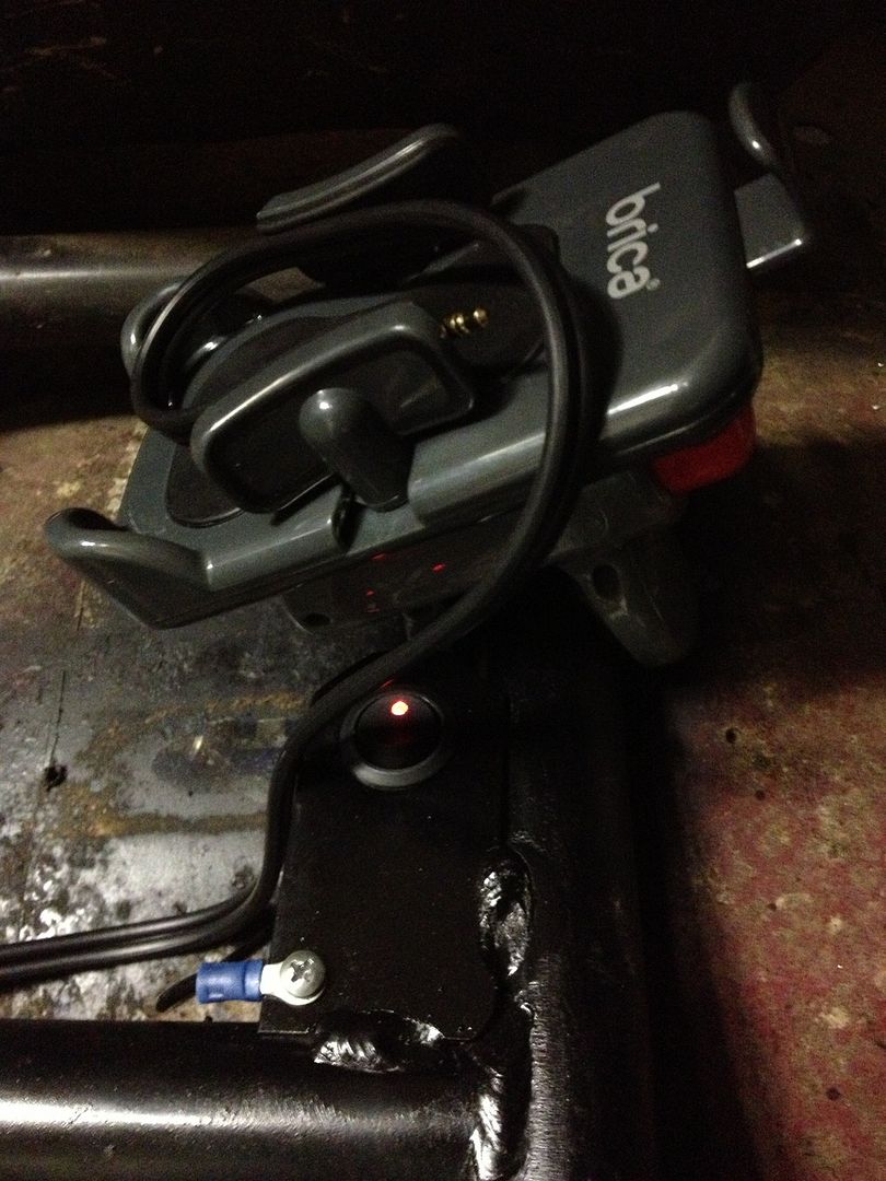

I added a switch between the seats to turn the amp on and off. You can also see the phone holder that clamps to the seat mount. All the wiring for the amp and speakers is contained to the cage except the power wire of course.

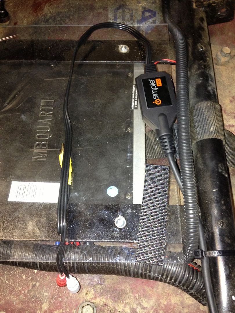

Since the initial post I've done a couple small changes. I installed some wire loom over the exposed wires on the side of the amp. Then to better protect it from water/mud I bent another piece of lexan 90 and vecro'd it to the top of the amp. This is easily removable to access the terminals on the amp. but completely shields the side of the amp from the elements, and really makes it so you can't even tell the amp is there.
That was all done before the first wheeling trip and everything worked well. Just recently I decided to upgrade the cable I was using to connect to the amp. I initially used the headphone to RCA cable and it was fine, but I wanted to charge the phone as well and figured I'd rather just run a single cable to do both. I ordered this cable from Amazon. http://www.amazon.com/iSimple-IS76PR...ywords=IS76PRO The install was simple. I just Velcro'd the base to the top of the amp under the seat. The power and ground were connected to the remote and ground wires on the amp so it switches on and off with the amp.
When it came time to test this install (at 11pm) I found 1 issue with the new cable. It disables volume controls on the phone. I purposely turned all the volume options down low, and suddenly got an extremely loud blast of music in my ear. LOL Tried it one more time thinking I missed the setting on the phone but no dice. This time my wife (who was at the other end of the house) came to the garage to give me disapproving looks. LMAO
To resolve this issue, I had to order an in-line control knob. Not a big deal at all, other than needing it for a Saturday ride (on Thrusday night). Thankfully Amazon Saturday delivery saved me and I got one of these at about 10am to finish the install. http://www.amazon.com/PAC-Remote-Amp...vel+controller

Here's the level controller I installed. So far it works great. I also swapped in a waterproof power switch.

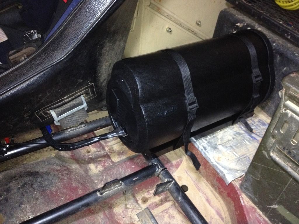

Just got a little upgrade for my sound system. Nothing huge, just an 8" 100w powered bazooka tube to get things thumping.

Got bored this weekend and worked on the bazooka tube install.
It was really simple to wire this into my existing setup. Power, Ground, and remote, and plugged in the RCAs on the bass tube to the "line out" on the amp.
A quick test in my garage indicates it will sound great in the Jeep, and not really make much of a difference outside the Jeep. That's probably also a result of the tubbies being so loud. I had to turn the gain on the amp down about 20% to balance the bass tube with the other speakers. I still didn't turn it up past 1/2 way and it was plenty loud. I was waiting on the paint to dry on my mount so no finished pics yet. The mount is just 1-1/4" square tube and the bass tube will be held down with a couple lashing straps.

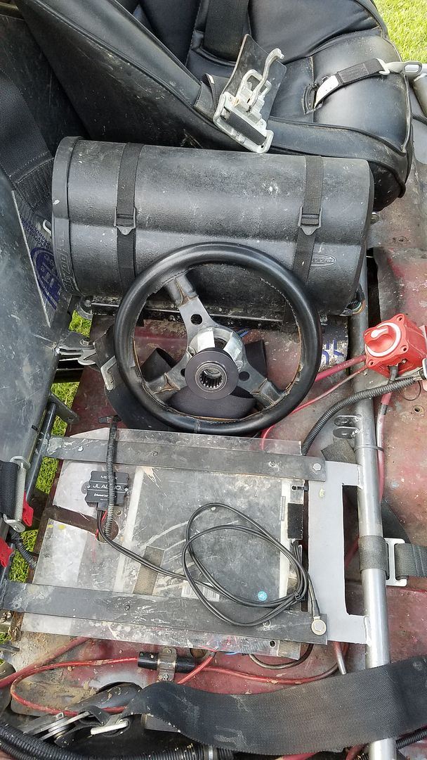

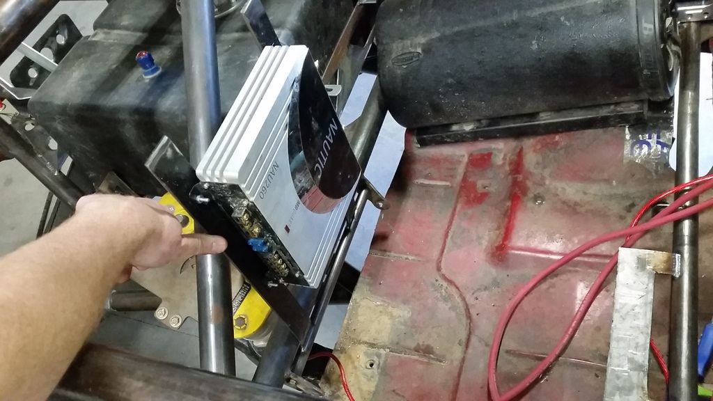

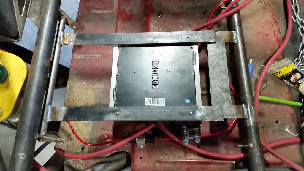

My Jeep is going through a bit of a transformation right now and I finally got to the point of re-mounting the amp. Taking a lesson from what I learned on the original mount, I came up with version 2.0. The amp still mounts in the same location and orientation (upside down under the passenger seat), but I made the mount both removable and hinged. With the previous fixed mount, I had to use a 1/4" drive socket wrench with a screwdriver bit due to the tight clearance. This new setup will make wiring a breeze.
Since these pics, I drilled a couple holes and added 1/4" threaded inserts on the front of the mount. Remove the front 2 bolts and loosen the rear and it hinges up. Remove the rear 2 bolts and the entire mount comes out.
