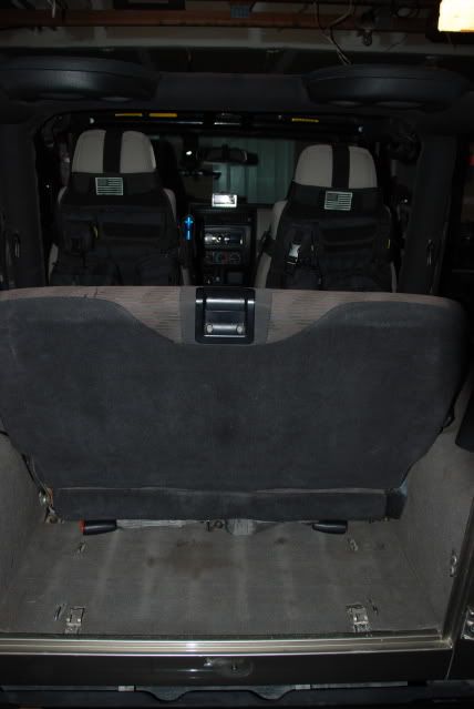

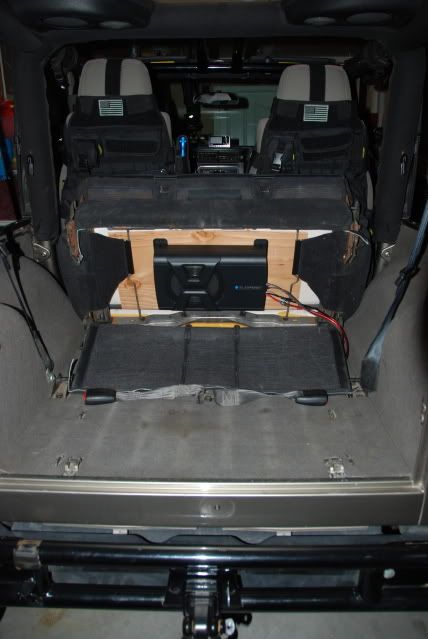

This is what I did with Blaupunkt Thb 200A....

Originally Posted by CarolineC View Post
I like this, but I don't want to cut open my back seat...
You don't have to. If roll your seat forward you'll see the bottom cloth has a zipper (at least mine does).
You'll have to cut out two of the support bars though (no problem because you'll replacing the support with ply wood). A thin mount powered sub will fit. Far better than the stock sub between the two font seats (if you had that option). However the bass still gets lost at hwy speeds with the top off. Around town and on the trail it's a great addition and it doesn't loose any valvable space in the back.
