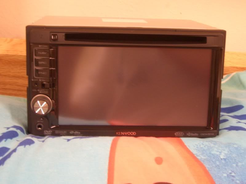

Looks like it'll be a little while longer until I can start ripping stuff out. For now, my setup will consist of:
The new radio (Kenwood DDX-514)

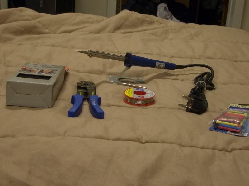

Well today was a very nerve-wracking day. I had time to go to OBI and pick up the tools I need to solder up my radio harness adapter.

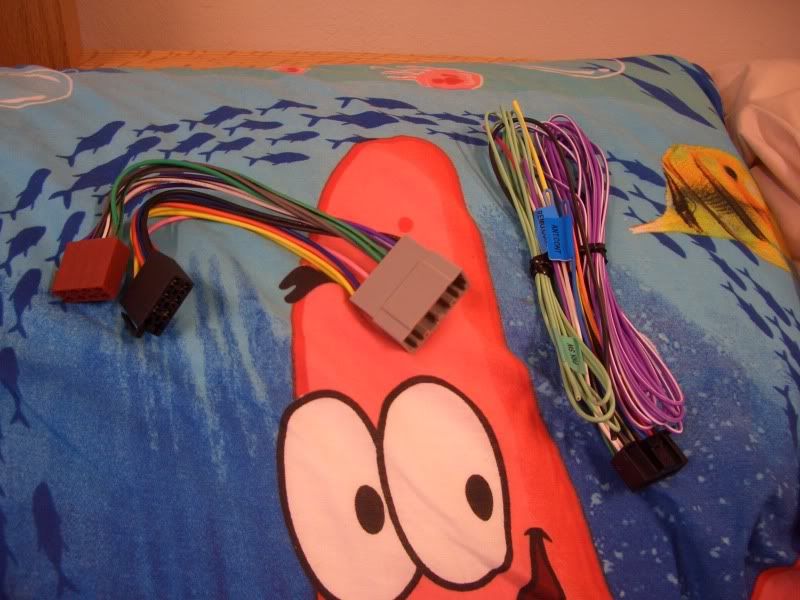

I was able to pick up a new adapter harness this afternoon. It cost me something like 7.50. Pretty cheap.
The other 2 connectors are for the radio end. German purchased radios ALL use these 2 connectors for simplicity of installation. It's rare to purchase a radio from an audio shop that includes it's own pigtail. Pretty good system if you ask me

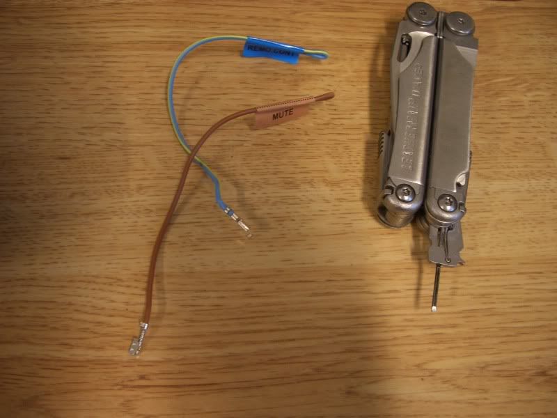

I pulled out the wires I will not be using such as mute and steering wheel control adapter turn-on lead by compressing the little lock tab on the molex. The wires just pull out after that.

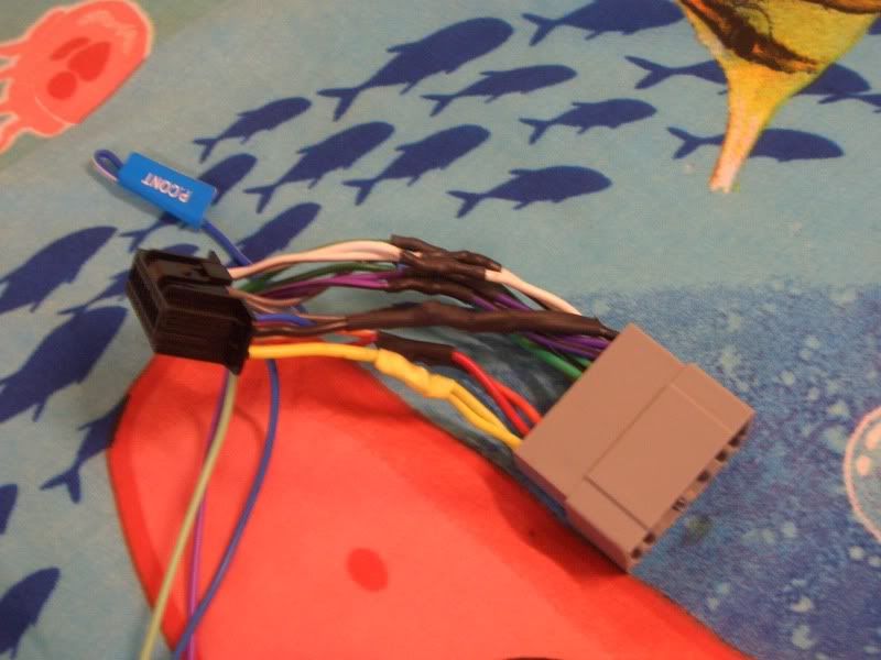

And here's the finished product! It's been a while since I soldered anything, so I had to get the hang of it first. This is the shortest harness I've ever made. I'm sure I could go shorter, but separating the wires from each other to solder the 2 pigtails together gets pretty difficult.
