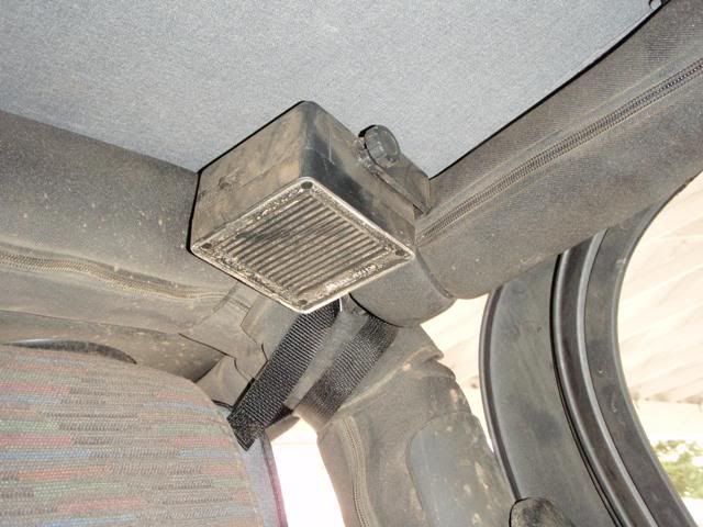

The Cobra75 is great at being a space saving radio, but its speaker is pretty small. I wanted to be able to hear my CB with no top and doors doing 70mph on the highway, so an external speaker was a must. I chose the midland marine cb speaker (since the Jeep tends to get wet), and it also has an additional noise filter with an on/off switch and matched the factory colors pretty well. I attached it at the corner of the roll bar with 3 heavy back zip ties, 2 on the windshield support bar and one on the main hoop, its mounted solid. It also is not noticeable on the driver side from outside the Jeep. I ran the wire down the inside of the roll bar padding and joined it the factory wiring loom that runs under the plastic cover of the driver door. The speakers wire was not long enough to reach all the way to the glove box so I purchased an extension at Radio Shack.

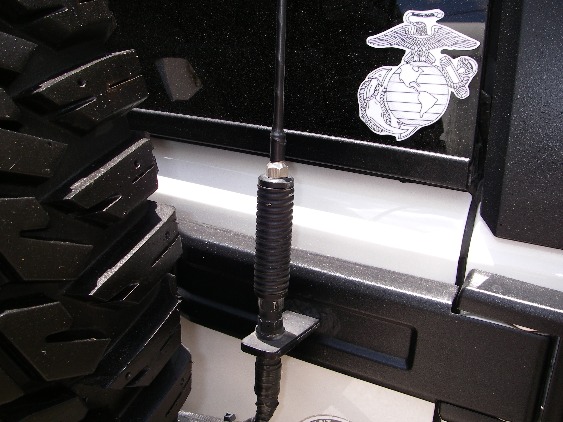

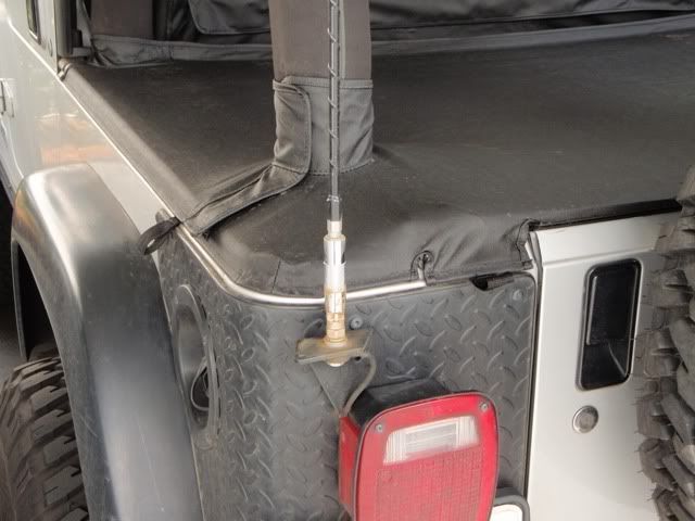

For the antenna mount I used the Terraflex tail light mount. I think this is a very clean and simple mount for the TJ, it simply installs behind the taillight using the tail light bolts. No need to drill. There is an optional drill hole, but I did not use it. Since I have corner armor, I opted to get longer bolts for the taillights, as I figured the addition of the terraflex mount + the corner armor would make likely make the stock bolts to short for a solid mount.

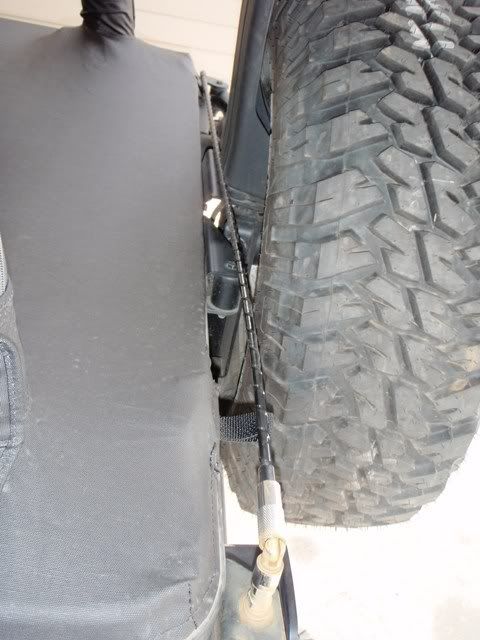

I park in public garages with low ceilings frequently, so the ability to raise/lower my antenna easily was important. I did not like the concept of the quick release base, as then I would need to carry my antenna in the Jeep. I found a fold over mount and it works great. The antenna neatly tucks in-between the spare tire and the rear window. (Note: the mount isn't rusted, just dirty).
I chose the Firestick Firefly because its light weight and flexibility. Firestick claims that the 4' firefly antenna can safely be mounted on a mount designed for a 3' antenna. In retrospect a 3' antenna would be adequate. I joined the coax to the factory wiring loom on the inside of the driver side tub and secured it with a couple zip ties, so it all looks factory.

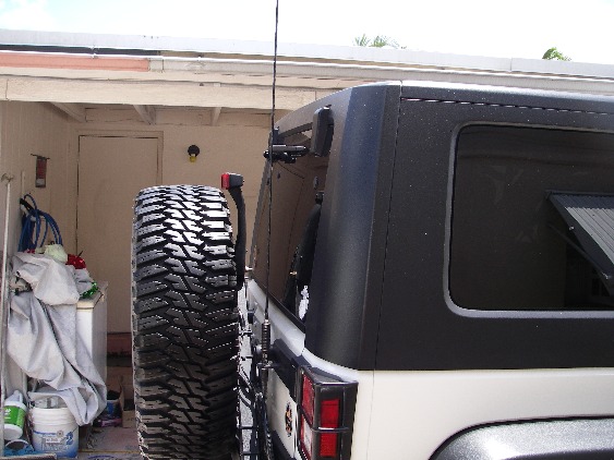

Nice! This is how mine looks.
2007 JK 4 Door, 33" BF Goodrich MTKs, River Raider Ram Air Snorkel System with a K&N flat filter, Cool Tech Exhaust, 410 Gears, Auto, Front & Rear Lockers with OX covers, TF 2.5" Suspension Lift with Heavy Duty Gas Shocks, Piaa Yellow Ion Fog Lights, LOD/Custom Built Steel Front Ram Bumper with White Fog Lights, KC Slim Lights with Windshield Mount, 10,000 lbs Front & Rear Removable Winch, LOD Rear Bumper, Garmin Jeep Trail Guide Navigation System with Topo, Hypertech Max Energy Programmer, ScanGaugll,Sirius Satellite 6 disk in dash changer Infinity 7 speakers with sub system, Cobra 75 WX ST with K40 Whip Antenna, Full Rubber Floors With Jeep Slush Mats and Custom Fit Neoprene Seat Covers and Grab handles, Daystar Switch Panel. See my Jeep in action @
http://www.aaof.us/jeep.htm

do you have a better picture of that antenna mount? where does the cable connect to?

I don't have any other pic but the cable is the bolt though kind that come in under the tab and in to the antenna. If you pull the trim off their are two bolt on the tail gate the tail gate is grounded so I made a bracket to fit over the hinge then welded a tab to it cut a slice in the trim put the trim back on. Then put the antenna on and used puddy to fill in the slice and had it tuned.. Hope this helped.

...Do all antennas fold flat like yours or just the firefly? Looking to get a CB setup and being able to fold the antenna would be nice when its not in use...

The antenna isn't what dictates whether it will fold flat or not, it's the mount. He didn't say what exactly he was using, just that it was a fold-over one. Check walcottcb and see if they have one.
Originally Posted by XWind View Post
...Ah yes, showing by noob status very well on this one... - I suppose I also could have looked and saw the fold-over mount. Oh well, still a nice setup. I'm gonna get the fold-over mount for mine.
It is the 203EZ fold over mount, name doesnt seem to do much good (I think its pretty generic) so I didn't bother to mention it. I did list the product link at the begining of the writeup (with the other products) that takes you to the 203EZ page on Walcottcb, where it can be purchased.

This is a noob question, but if you use the fold over mount do you still need the spring and stud mount?

yes you will still need a stud to make the connection to the cable. The fold-over mount goes between the stud and the antenna. Walcott is a good outfit, they can make sure you get the right stud for the type of cable you get. I went with the Firering Cable and stud combo from them. Though I kinda wish I had gone with an RG8 cable instead.
