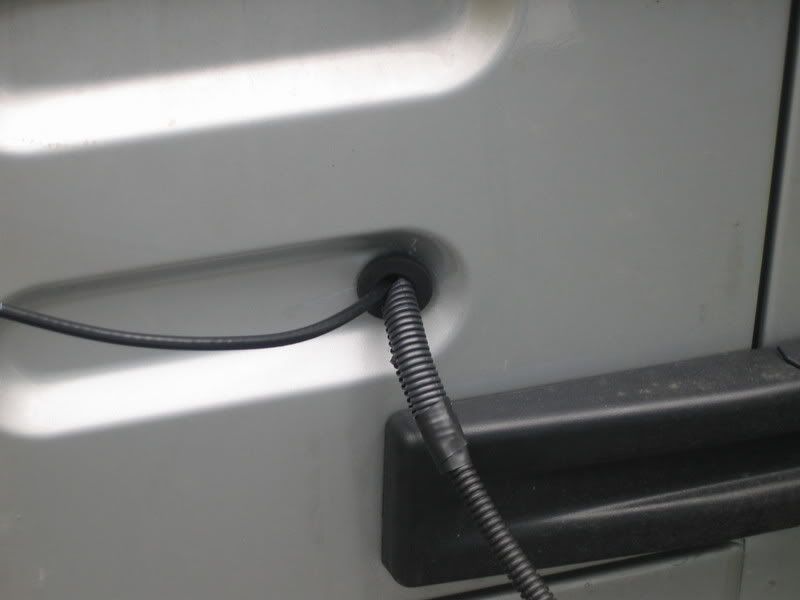

Just out of curiousity, how long did it take you to get the coax through the rubber grommit? I did this too, and I though after cutting of the PL259 connector (I soldered a new one on) that it would go right through, but it took me at least 20 minutes (and some dish soap as lubricant) to get that coax through that damn rubber hole.

That's actually not the original grommet. I spent some time in Autozone trying to find new grommets and ended up buying that piece, which came with a set of washers for a brake overhaul (can't remember what exactly it was for). After that, it was smooth sailing. I did spend about 20 min trying to get the coax through the stock grommet. Here's a close-up:

Where did the coax go?
After you ran the coax cable through there, where did you run it and still be able to open the rear door?
I just ran it under the carpet. I notched a spot in the plastic cover of the brake light connections, so that it sits flush. I should have added that that I also had to enlarge the hole, using a dremel and a couple of grinding bits.
