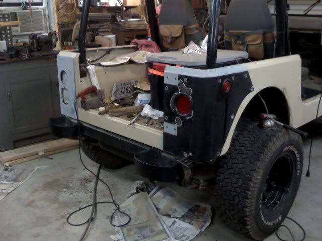

I'm in the process of doing mine with Poison Spyder trail corners and some side marker lights I rigged up from NAPA. There will be a write-up when I finish the install. I still have some painting to do and all the wiring. The corners will be tan to match the body, and I still need to make a license plate bracket.
Here's a teaser pic...
That looks awesome! I like the side markers. Post up a link so we can see it when its done.
