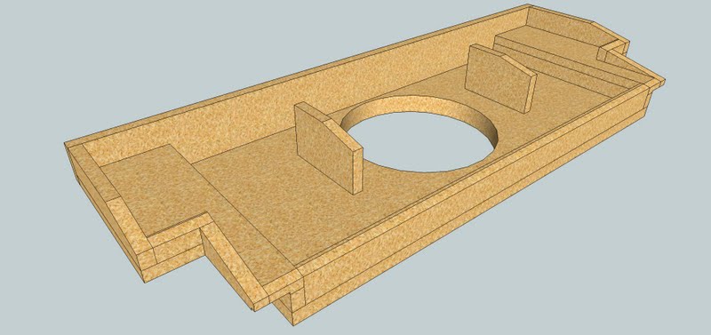

I did a quick Google Sketchup of the box. What a great design btw! From the specs on the JL site it appears this sub JUST fits and I do mean JUST. I had to move it all the way to the front of the box to get it to clear on the inside. I also changed the bottom face piece to 3/4" MDF to get the clearance. This works out because JL recommends a 3/4" front baffle thickness anyways. Net volume including drive displacement is 0.521 cu ft which is pretty darn good. JL says 0.5 is ideal.
I'm not box building expert, what do yall think of the driver position as well as the brace locations? Are they acceptable? I want to do this right the first time. Hoping it's strong enough to pound and also not get damaged from people sitting in the back seat.
Also, for the people who've built this box. I see the notch in the two "L" shaped pieces in the SirGCal plans online but nothing about notching the triangular pieces adjacent to them. I've gone ahead and notched them in the drawing as it appears the notch is there to fit it over something in the seat. Is the notch needed on the triangular piece? Do I even have the notch in the correct spot? Not sure where else it would go. (You can see what I'm talking about best in the 4th picture)

Thats one complicated box man. Props on tackling it. I don't have any input on the placement of notches but i wouldn't worry about the strength. As long as you're using MDF (at least 3/4" or 1/2"), use some adhesive glue and brad nails to hold it to together, you can pound it all you want.
