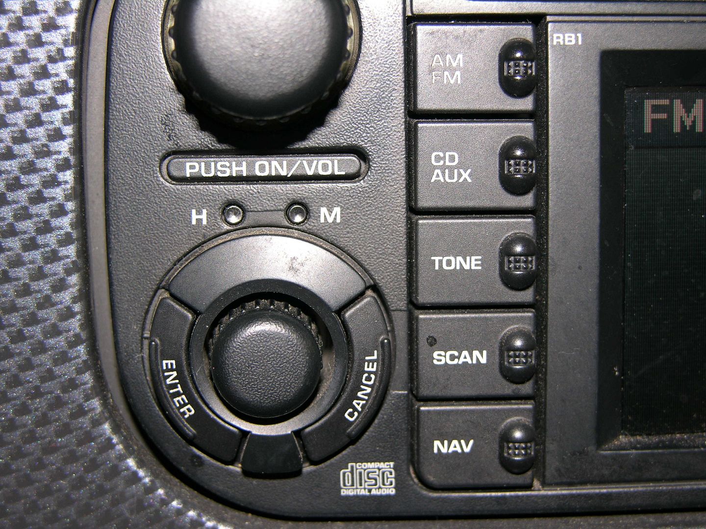

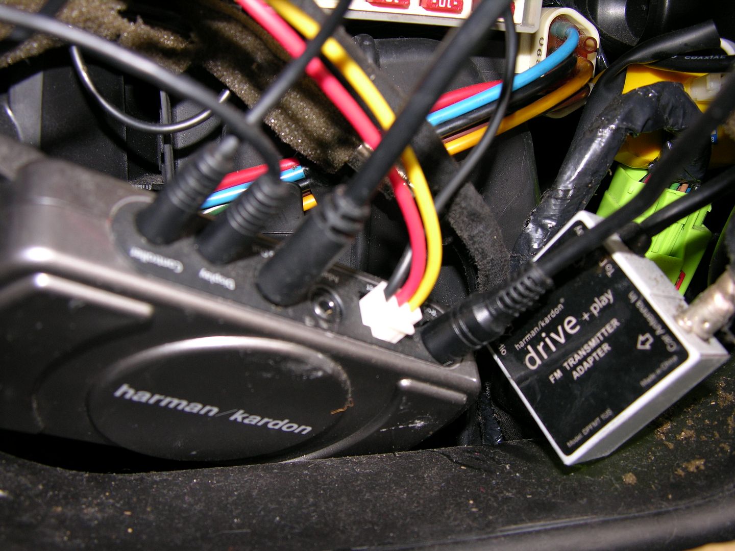

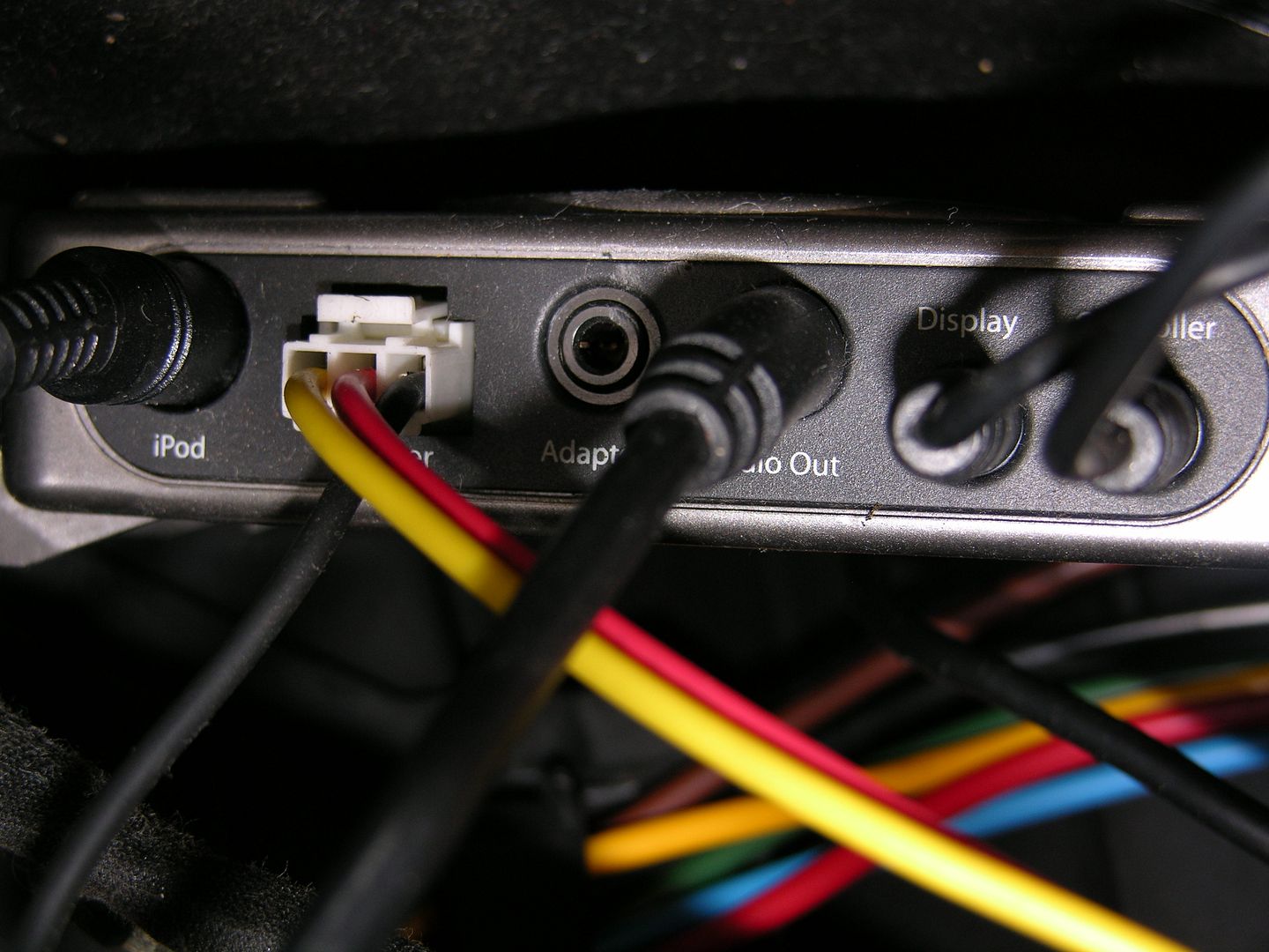

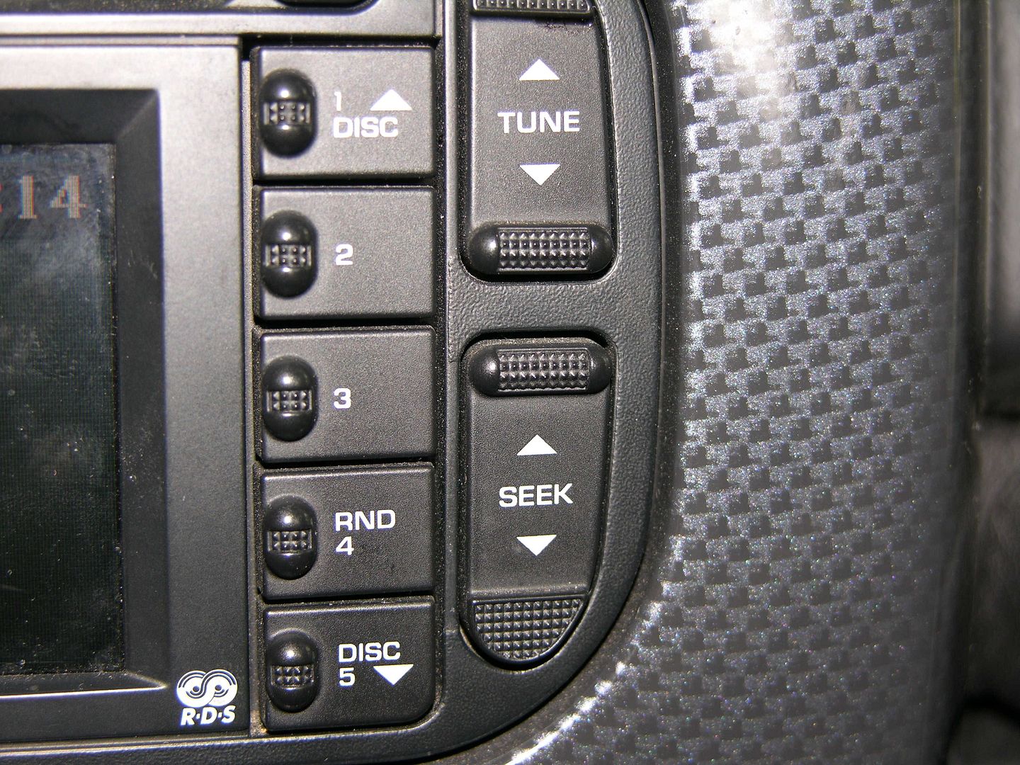

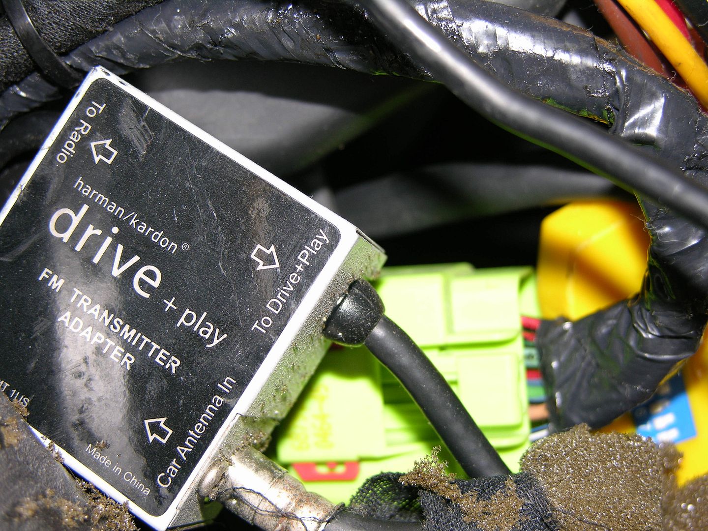

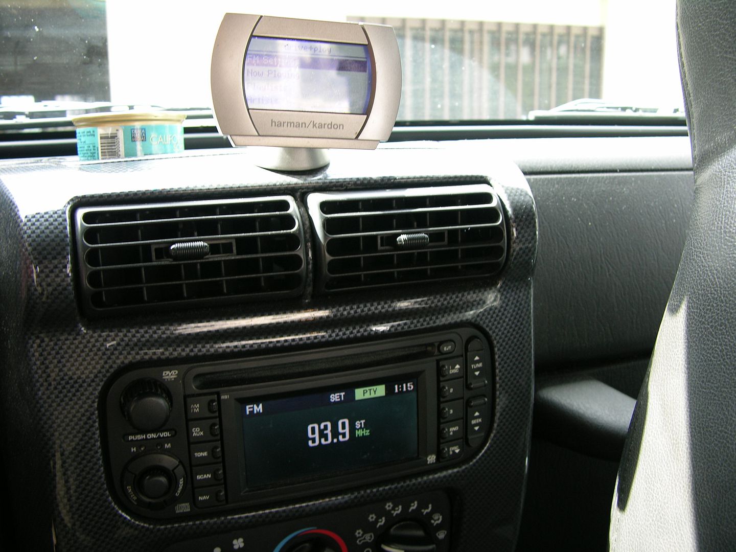

Okay, now for photos, just so the experts can see what it is I am working with:

If you just plugged the iPod cable in, I would run that for a little while to see if you (and your kids) are happy with the performance/sound. If not, the USA Spec. or factory iPod interface adapters are a good choice if you're keeping the stock (you have a RB1) radio. They plug directly into the CD changer port on the back of the radio, and the iPod usually can be controlled via factory radio controls (USA Spec. or other aftermarket sometimes can do both radio & iPod).

Reading into more of these products, I am not certain what this means, and how it applies or doesn't apply to my factory radio:
"Radio must be CD changer ( radios with Mode button )"
It would be nice if they stated that it works or doesn't work with RB1 Radio, but I suppose that would be too easy.

Okay folks, I have downloaded the owner's manual, read thru it a few times and then run it by my children. They tell me they want to be able to control their music selections from the iPod itself, rather than from the Jeep stereo unit.
My Jeep doesn't have the Nav unit, or the 6 CD changer unit, so it doesn't matter if what I get disables either of these.
Does anyone have a line on a unit that will accomplish this? The goal is provide an input to the RB1 factory radio that will allow plugging in an iPod and you still control the playlist from your iPod. There have got to be a few of you out there that have done this. Thanks for any input.
Edit--also, does anyone have a photograph of the BACK of the RB1 unit?? (yes, I have one, but I don't want to pull it out merely to look at it)
