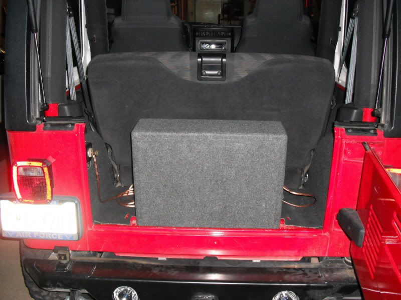

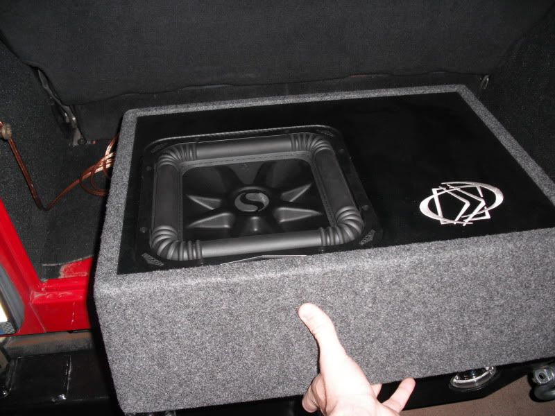

Oh today I bought a new subwoofer for my Jeep its the L5 Kicker slanted box with a port, OH MY WORD! more on this when I get a chance. Gotta put the babies to bed.

The Kicker L5 sub, crazy bass in a small space. You wont regret it! This is neigbor hood bass with 500 watts rms, you looking for something substantial this is it. The port adds 3dB, essentially the same as doubling your amplifier power.
