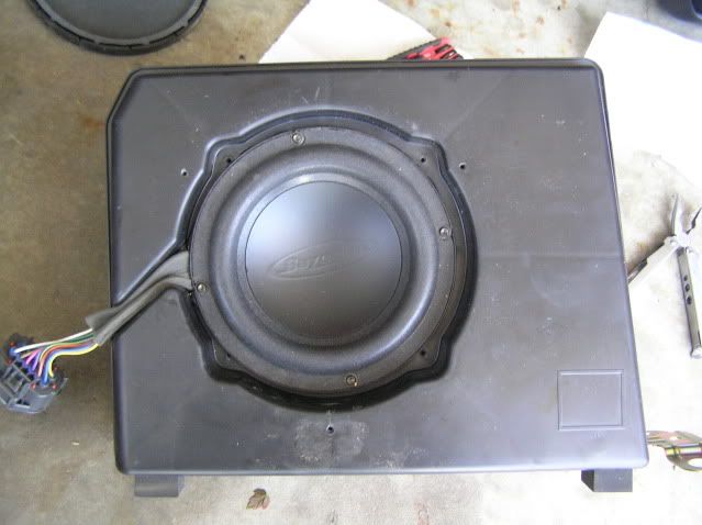

I installed the Bazooka WF621.5DV last year. Much improvement over the factory sub. It does not 'hit hard' like the cars at the local high school, but is louder and more clear than the factory. It is a dual voice coil so there is nothing perplexing about the wiring either!
Factory Vs. Bazooka:
Cutting Required:
I attached the wires just as the factory sub was. Red/black up top and the others at the bottom.
Fitted box, sealed with RTV around the edge:
I just used the same sub, wow it's much better. I had already upgraded the other speakers and now it sounds like it.
