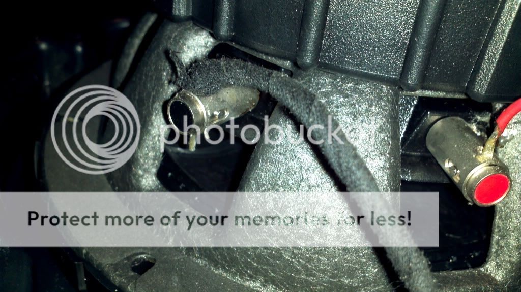

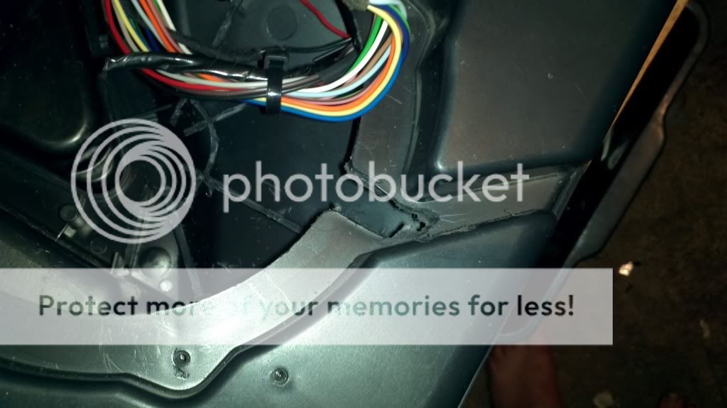

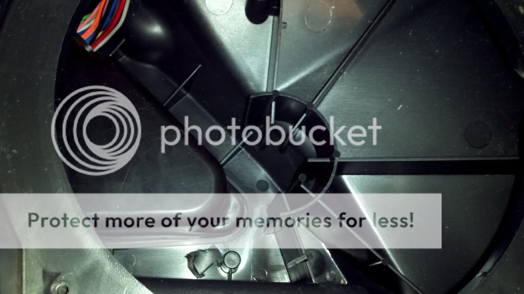

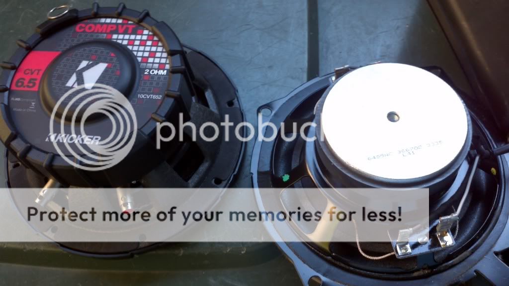

I replaced my stock sub with the Kicker CVT652 CompVT Shallow 6.5" 2 Ohm sub today - piece of cake. The red and black factory cables worked on the corresponding terminals on the Kicker Sub.
Here are some photos
I reamed out the inner plastic reinforcing with a pair of tin snips and a dremel
Cut a notch for easier cable routing
Baseplate is offline
