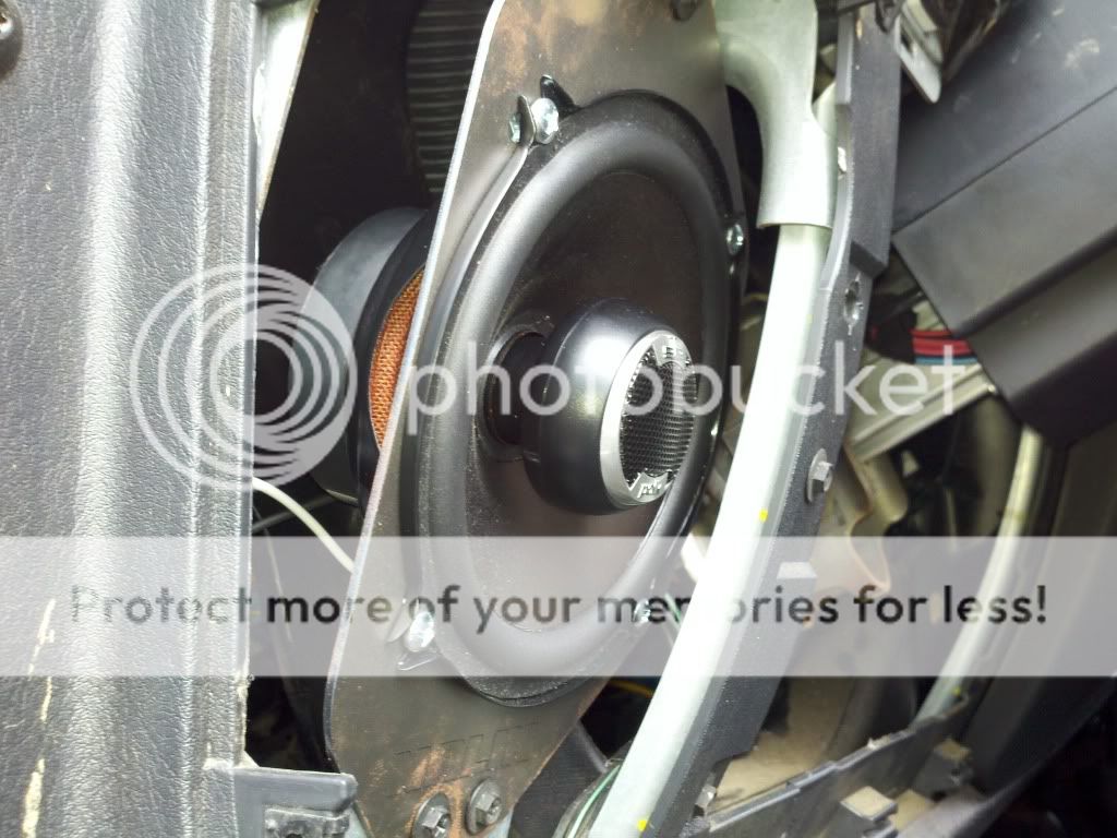

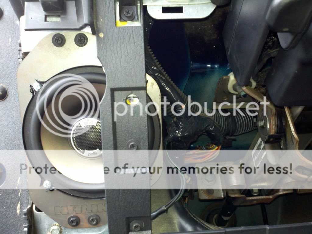

post #23 of 29 Old 09-26-2011, 08:21 PM
rubibluejay
Posts: 1,663
In the meantime, I have a pic of my driver's side cavity as well as a couple of pics I got from a Google search.
Driver's side cavity.
Cut line and pic of install.
I'll try to get some pics of my Jeep with the knee panel removed so you can see what's going on inside.
Looking at the pics from Google, I do see that the vent tube appears to have a connection point, which my '04 doesn't have. I wonder if once you pull your knee panel (the one under the steering column), you will be able to see where the interference is?
Jay

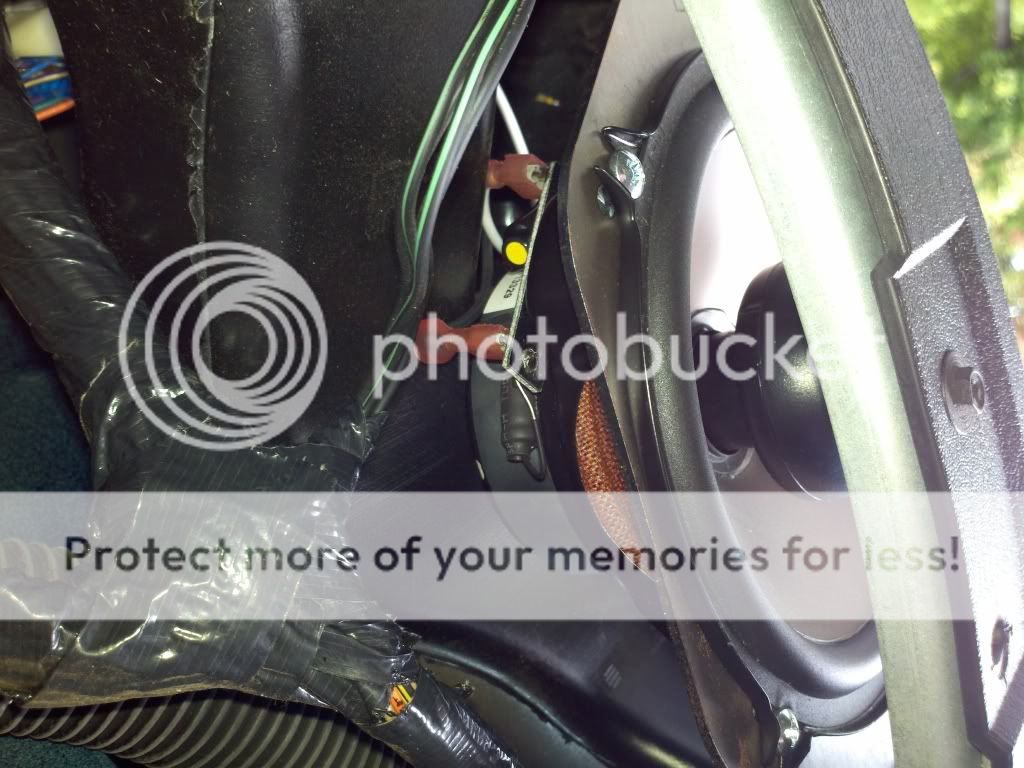

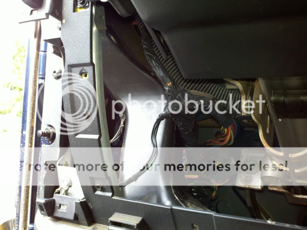

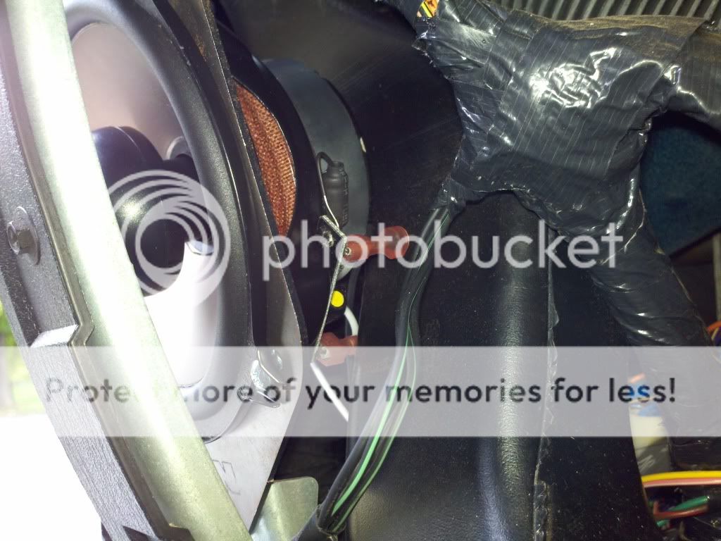

post #24 of 29 Old 09-28-2011, 03:21 PM
rubibluejay
Posts: 1,663
Sorry for the delay.
For some strange reason, Photobucket is un-flipping the pictures below. I took the pictures with my Droid X, so the lens was upside down when I was taking them inside the knee panel. They're pretty much the same as the others, but I was trying to show the slight gap behind the magnet, which didn't work anyway.
Looking back, I probably should have unplugged the wires before I took the pictures...
Jay

post #25 of 29 Old 09-28-2011, 08:44 PM
NalinMFG
Join Date: May 2007
Location: Evansville
Posts: 2,047
Is the magnet rubbing the tube? If it's just the terminals you could try rotating the speaker in the mount so that they are on the opposite side.
If that doesn't work, perhaps try adding a washer between the speaker and adapter.
