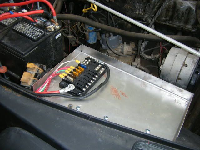

This thread will be used to show my build-up of a new Batt tray, fuse block and relay box under the hood of my YJ. Here is a pic of my current setup with the Blue Seas Fuse block just bolted to the fender.

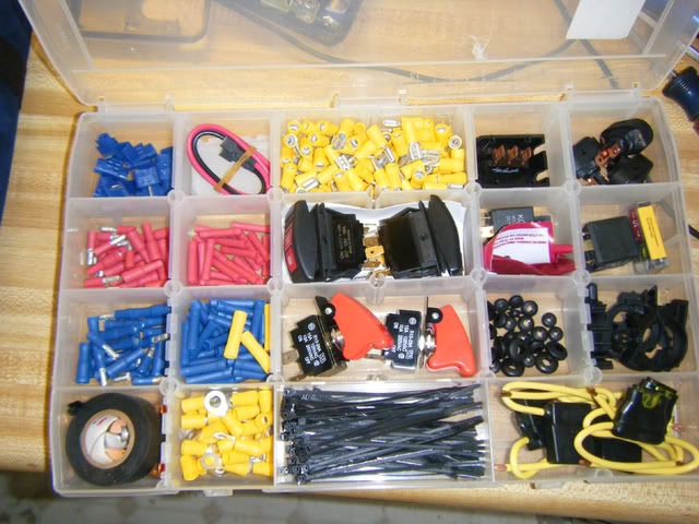

And here is a pic of what I collected up after cleaning out my basement work area. Holy crap I have alot of electrical crap layin around.

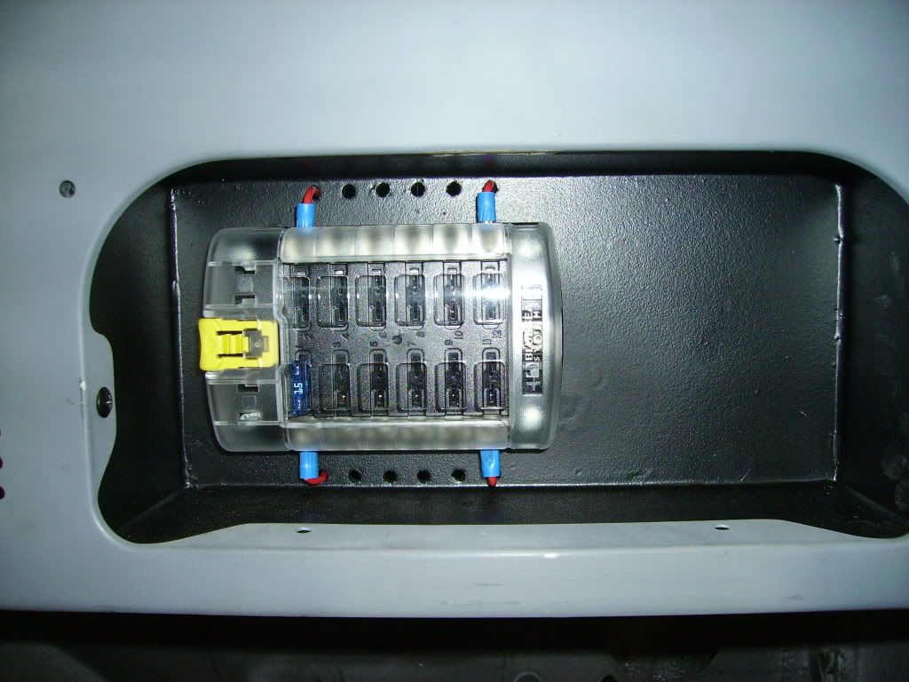

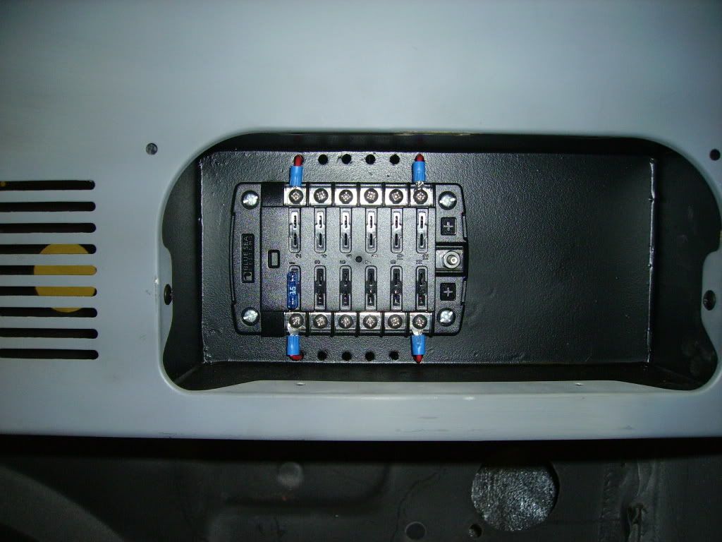

I just set mine up in my cj7 last night. I am not ready to run the wires yet but when I do the only question have is what size wire did you run from the battery to the block?? Here is where mine is going. I also think I am going to add a 12v outlet in there on the right.
[IMG][/IMG]
With out the cover.
[IMG][/IMG]

I hope you debured or are planning on adding some gommets to those holes the red wired are going through. Especially on the unfused supply wire you're going to add later to the block. JMO

It might look ruff but it is made of wood so there isnt anything there that should be a problem. But I did run a dremel through there before I painted it just to be safe.

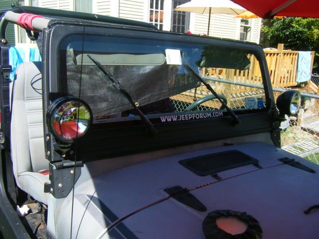

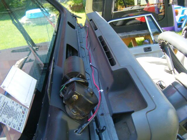

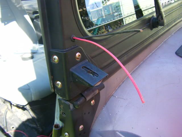

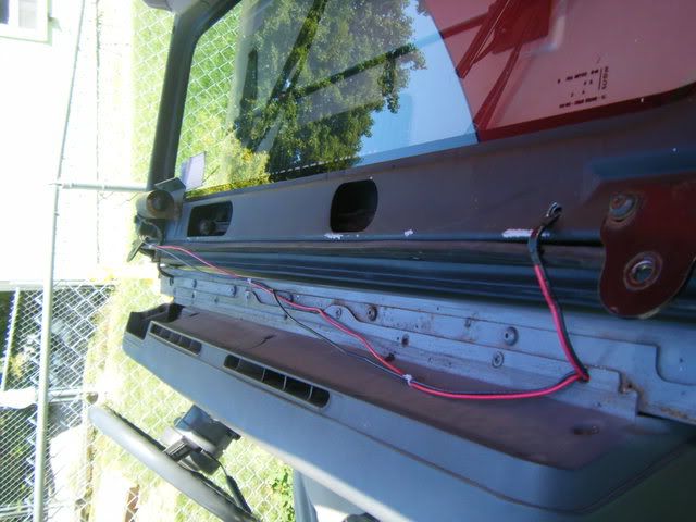

Small side add to this project. I finished up getting my windsheild lights wired up the proper way and running the wires into the windsheild itself. Here are a few pics below. Before, I just ran them around the moulding and into the cab at the door edge. This is alot cleaner. I have yet to run them into the engine bay but that is part of the current project. I will have more project pics after this weekend when I finish up under the hood.

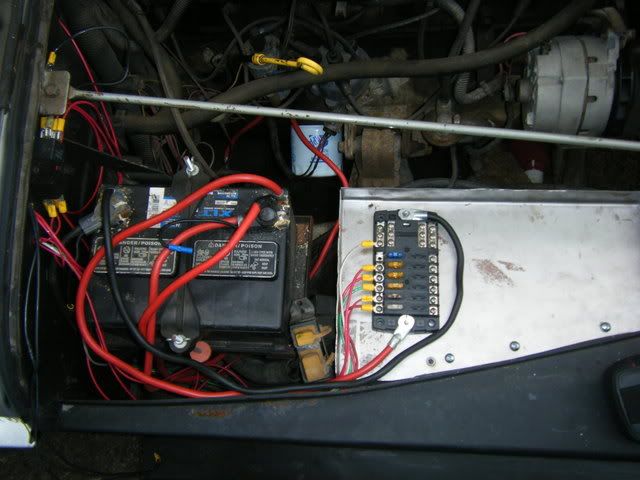

small update: I have a prototype that I have been test fitting. I think it will clean things up nicely.
alot of what is to the left will get moved to it
