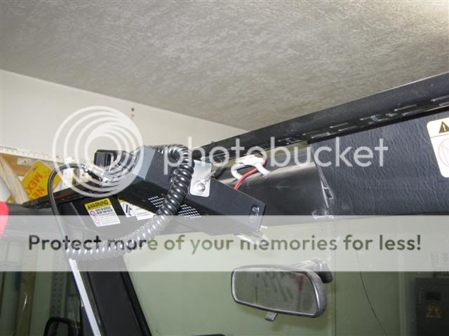

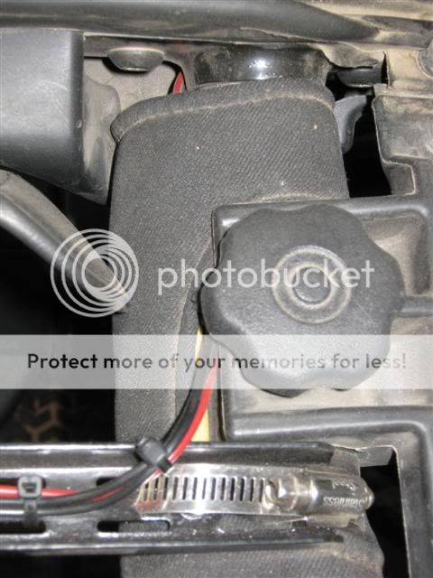

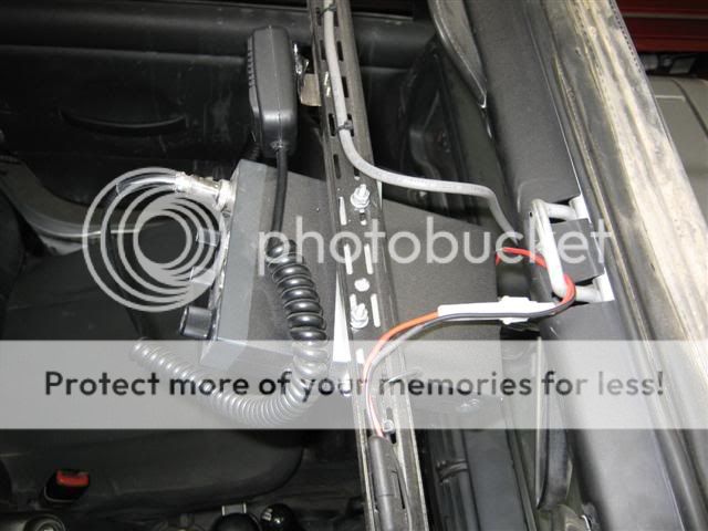

I put mine overhead using a shelf mounting rail from Lowes...less than 10 bucks in parts and it's out of the way. It's been in for about 4 years...
It's just secured with hose clamps to the side bars. You could easily cover it with pipe insulation to clean up the look a little.
