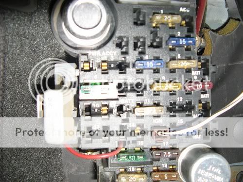

'94 XJ fuse panel actually looks like this:
The flasher devices are the silver cylinders on the upper left and lower right. Only a couple bucks at any auto parts store.
