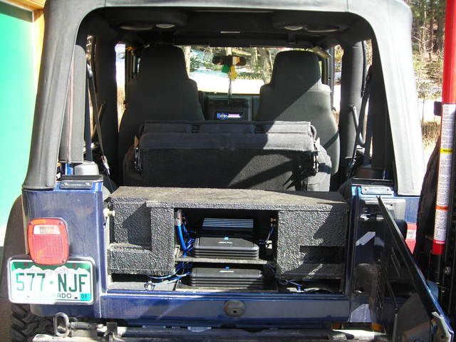

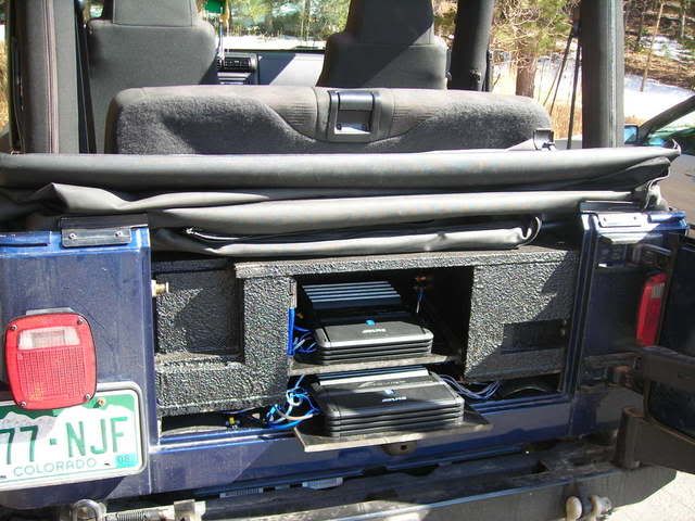

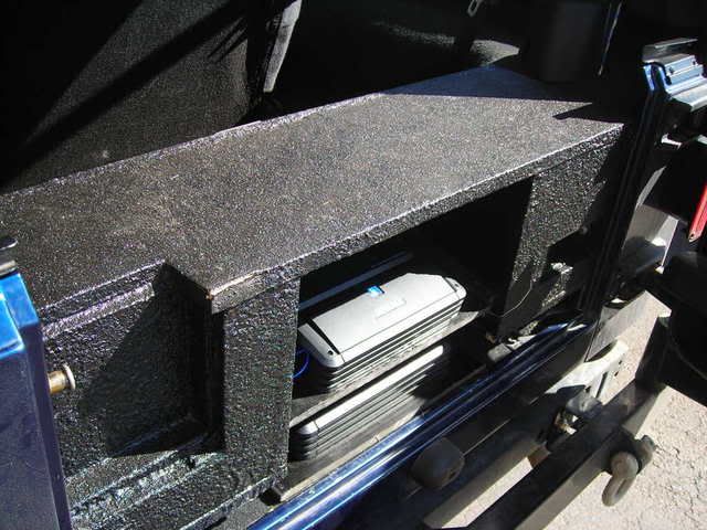

Here's my box:
Alright, so that should give you a good idea of how it works. This box has cutouts for the 3rd brakelight, door handle, and has an upper shelf for an amp, as well as a lower slide out shelf for another amp. It's missing 2 legs which I need to fix. As it sits right now, the bottom amp just sits in the tub, but is supposed to slide out. I'll get that fixed later. It's not too big of a deal right now. The box is stuffed with polyfil, liquid nailed, spray with undercoating (sub chambers), and covered in herculiner. It is air tight. No doubt about that. With the top down and the seat back, the box is invisible. The amps are out of the weather, but airflow still flows through the bottom back portion of the box.

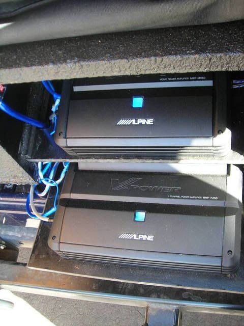

My system pushes 200 watts to each sub, via the Alpine MRP M450. The bass is very clean, rolls off nicely, and is easy to differentiate sub notes. It has a good amount of punch, and doesn't break a sweat at highway speeds. I pulled the top off and ran doorless today (very windy) and at highway speeds I can easily hear the bass, and there is still a good amount in reserve. Tailgate parties, trail rides and camping will be all the better with the great sound.
It gets loud too. Very loud. Upsetting the neighbors kind of loud.

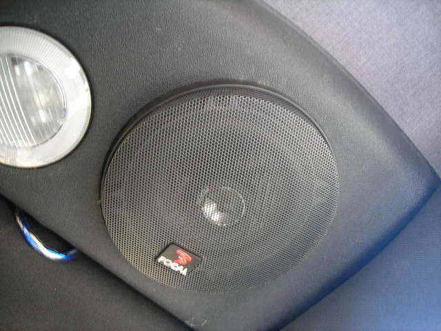

As for the speakers, I went with focal. I was wanting good midbass and these deliver past my expectations. The Focals have smooth highs, not ear piercing though. I can honestly say that half of my bass comes from these speakers. They have a little bit of bump to them too. I'm 100% satisfied with the Focal speakers. There are very few brand name speakers that could out do them. Worth every penny to me.

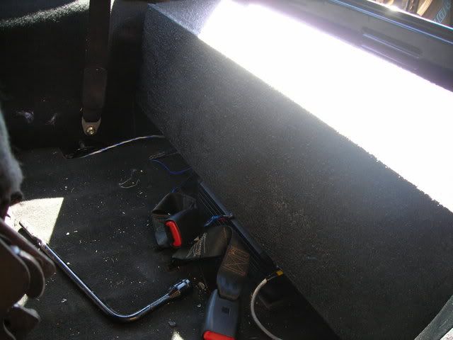

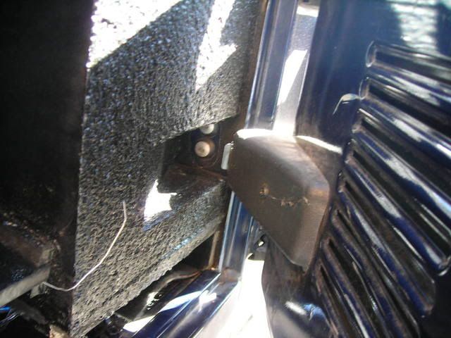

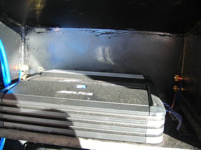

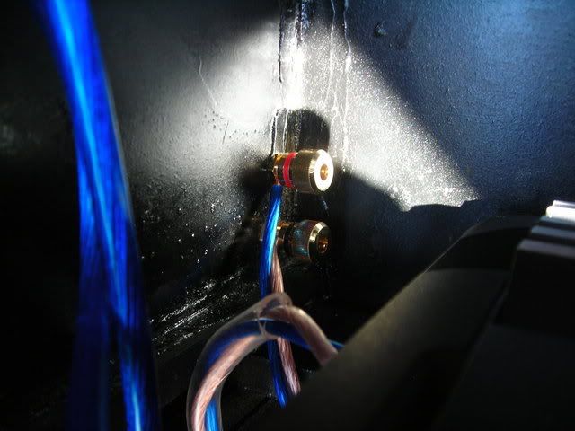

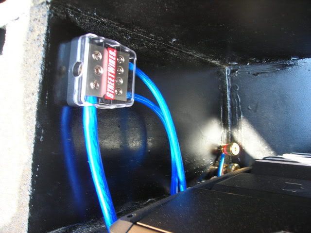

Here's some pics of the wiring, and sub terminals. The last picture is the ground wiring.

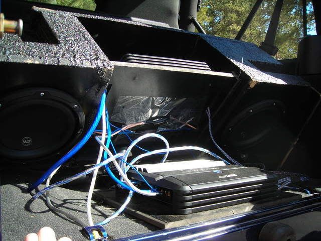

And a jungle of wires
My system sounded pretty good just adding the subs, but the stock speakers couldn't keep up, even with the alpine head unit pushing them. The Focals transformed the music. Just echoes coming off of the microphone from a singer come through. They get much louder than I will ever need, and all the details shine through even at high volumes. These speakers are being amped via the MRP F250 and see 40 watts per speaker. My system pushes ~560 watts rms.
I really had to be creative with how I was going to pull this off, but it works amazingly well. The sound is breathtaking. I run a soundboard at my church, and I'm familiar with deep, smooth bass and didn't think I could get that kind of quality in car audio, but I have.

I'll tell you that the Focals have better bass in the sound bars than they do in the front panel. Of course this is due to the pods providing an enclosure of sorts. I stuffed both the front panel with polyfill and the pods as well. Try some polyfill before you swap them out.
I like mellow speakers. Something with warm midbass, yet clear highs. I hate sharp speakers, they seem very 2 dimensional to me. The focals are very warm throughout the spectrum, but at the same time, they aren't so warm that the bass flattens the higher end of the spectrum. The highs, and the higher notes still shine through. They are all around a great speaker. I got a set for $130 from www.woofersetc.com.
I was thinking that maybe the subs would handle the midbass, but that just is too high for them. My subs hit all the notes that a bass guitar puts out, and the speakers hit the lowest notes of an electric guitar, that kind of thing. It just works really well. The factory system is somewhat confusing to the ears, IMO. You increase the bass and that muddies the stock speakers and they lose their clarity. On my system, I have the bass set low, the treble set high and the subwoofer (another setting on my head unit) set high. This makes the music sharper, yet doesn't get rid of the bass. The stock system makes it so you have either good sound coming from the speakers or good sound coming from the woofer. Finding a supreme balance was hard. Increase the bass on the stock system and the woofer started to pound a little (very little compared to my new subs), yet the speakers were choked and became muddied and loss clarity in the higher end of the spectrum. Increase the treble and the speakers got clearer but the woofer was close to non-existant at this point. That was my biggest complaint with the stock system.
Focal can be found at cartoys. They get $200 a set of speakers, so don't buy from them. I run the basic access line. You could even step up to the polyglass line if you like them more, but I thought that the highs were a bit much for me.

Nice work. Be sure to secure those wires so they don't slap the subs or box and what not.

It could look a lot more clean if you secured the wires
