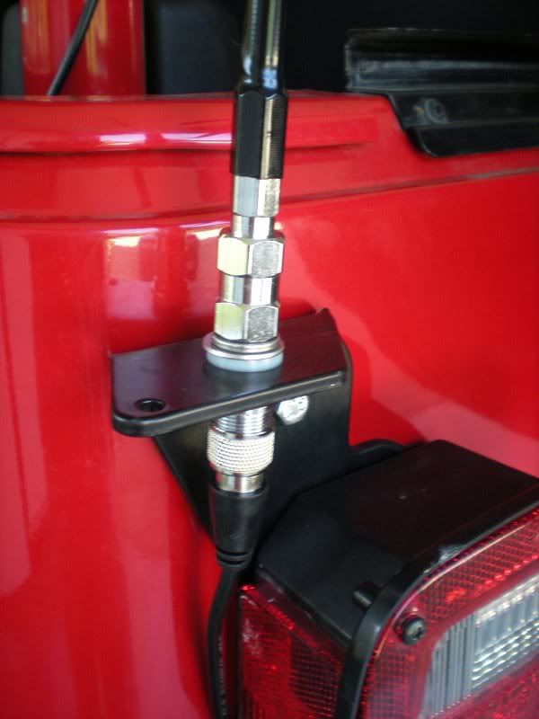

IMO I would stay away from that mount and cable.
I have heard stories of that type of mount causing stress cracks in the metal around where it mounts. Especially since your wanting to run a 3/8" antenna on it.

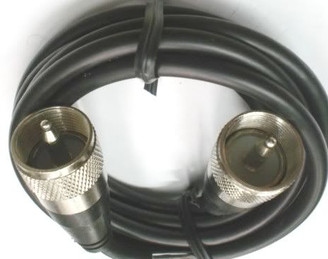

The cable I would go with a RG-8X (aka: mini-8 ) cable which have much better shielding then the smaller RG-58 (whats pictured) and dont have that funny fire ring on the end. Which is harder to run because of its big head and doesnt get near as good of a ground as the ring type connections.
If you really want to run that style of mount I would suggest one of wilson's 1/4" antenna's or an Everhardt Tiger. Due to their lighter weight and some decent cable.
Antenna length: the longest antenna you can get away (ie: not banging it into everything) with the better. I run a 3 foot most of the time even on the trails and a 4 foot when I know I am going to spend allot of time on the highway.
As for not seeing the cable. I run the Tera flex mount and if you take your time and do it right the only places you can see cable are the 3 inches between the light and antenna
and the 2 inches going into the back of the radio.
Nowhere else in my Jeep can you see coax.

However I would still stay away from the firecrap wire. That stuff is some of the cheapest rg-58 there is. Get some RG-8X, its heavier wire and has a lot better shielding then the rg-58 stuff.
Grab something like This Stuff and cut the pl-259 connector off the end. Run your wire where you want and install some plain ring terminals on it. You can get a box of 6 3/8" ring terminals at wal-mart for like 1.59
Or better yet find a local CB shop and get some RG-8X in bulk then you can have enough to run coax for the power wire and the antenna. Makes for a nice clean install and cuts down on the noise also.
Yep, I like that Teraflex mount myself. Looks nice and clean there newjeeperguy.

I've also heard from a local ham shop that the RG-8X is superior to RG-58... although I myself just went to radio shack and bought some cheap RG-58 with a PL-259 connector on both ends like this:
Then I bought a firestick k4a stud like this (no spring needed):
A teraflex mount... here it is:
My firestick is 4', which just goes above the soft top by an inch or two. No problems so far. I ran the coax along the roll bar... a bit easier that way imo.
Don't forget to scrape away the paint on the underside of the teraflex mount where the stud touches the mount... that part of the stud has to ground to the mount (plastic washer must go above mount... that part cannot touch). The mount then grounds to the tub, so also scrape away the paint on the tub behind the light and on the bracket where it will touch the tub. I put a metal washer in between the teraflex mount and the jeep tub so as to ensure good contact.
You will also need a simple SWR meter to calibrate the antenna.
It doesn't have to be professional grade. It won't be anyway because you've got a lot of interference from the roll bar and jeep tub. The main function is to communicate with other jeepers, and that can be done without ideal conditions. Install it and then use an SWR to see if you're close enough on signal efficiency.

This is a very good way to go & jonalexdeval's recommendations are right on.
RG8x has a little less loss than RG58 but with the short length of cable needed for a Jeep, there is zero benefit to going with the slightly heavier RG8x cable. RG58 works just as well in a Jeep, is easier to route, and costs a little less too.
I would not go with a ring style connector like shown above in post #2. They are more easily damaged than the PL-259 type of connector and more exposed to the elements. It's real hard to beat the screw-on PL-259 connector recommended by jonalexdeval that is on both sides of the cable in the photograph. The mount and Firestick antenna is very good too.
Finally PolloLoco, a 3' antenna length is fine. Even my 2' works very well on the trail after replacing my 3' with it due to Jeep height reasons. I can hear everyone I need to and everyone always says my signal is as strong as anyone else's is.
