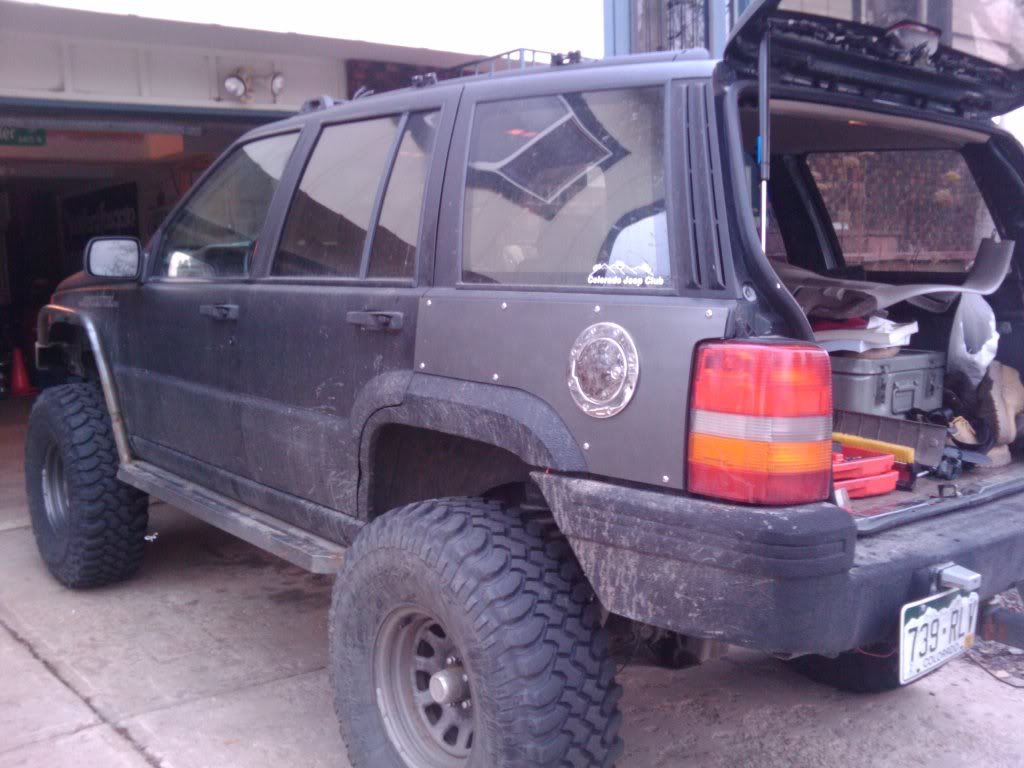

you'll need support behind the anchors

2X on that, alot with 33-35's. there's not much behind there.

Youll def need to support the inner fender behind the mounting point. No way it would hold a tire otherwise.

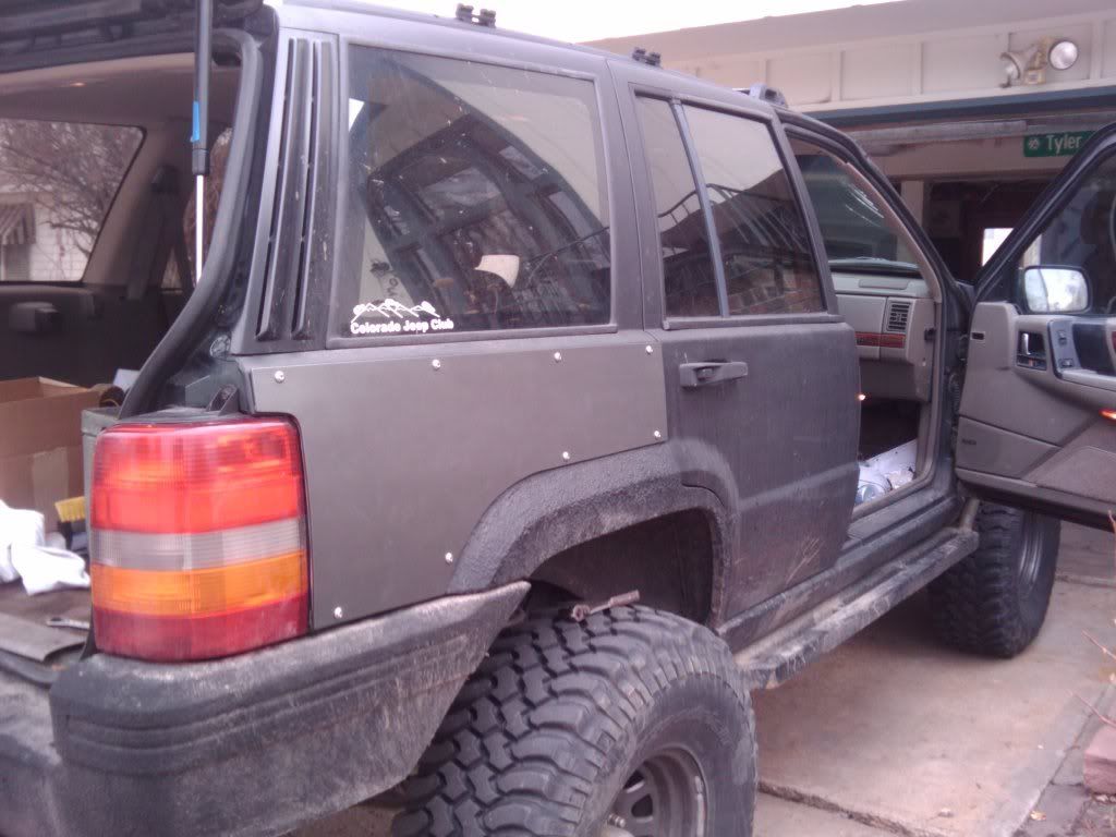

you need something like my rear quarter panel armor i just made for my jeep that would hold that tire carrier very nicely .. it is plated on the inside as well for bracing
outer plate and inner plate are both 3/8" steel
