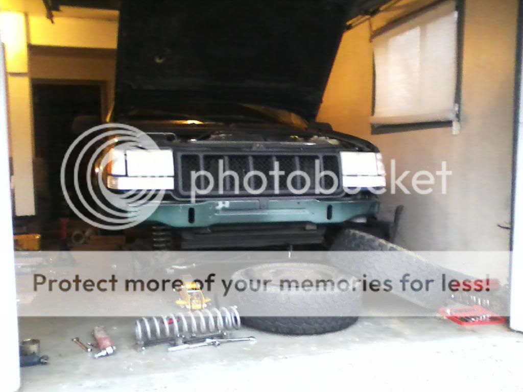

other then painting the cladding and rear bumper, everything suspension and exterior wise is set up for right now. still have a lot of interior work to do. some pics from today.
front bumper cover trimmed and getting paint.
my build/wheelin/picture thread

See how your control arms sit crooked in the pic of your jeep straight on? Is that normal and does that effect the ride or anything because my RE rear lowers do that too. Or is it just because of the flex joint?
