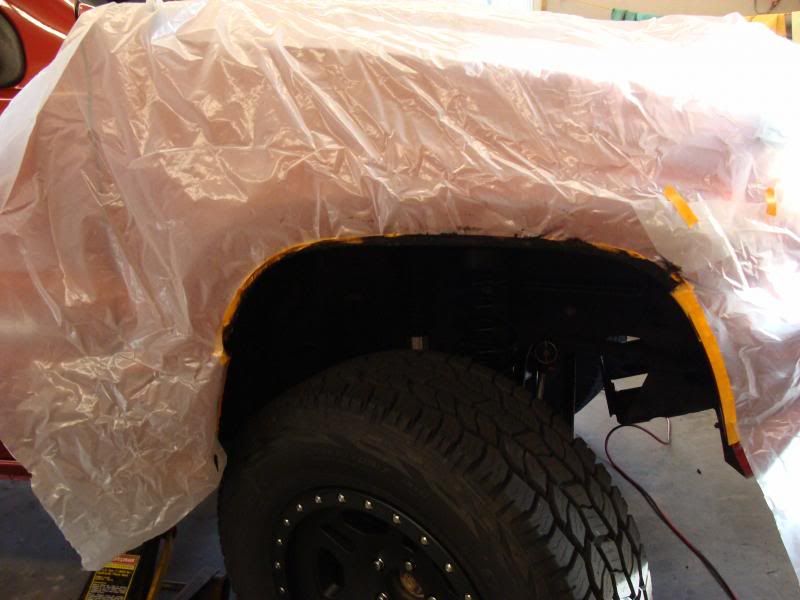

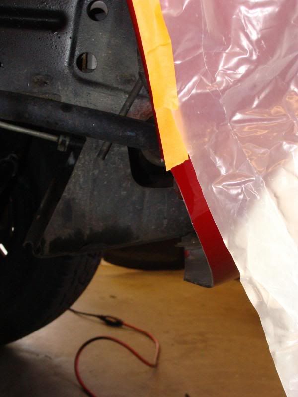

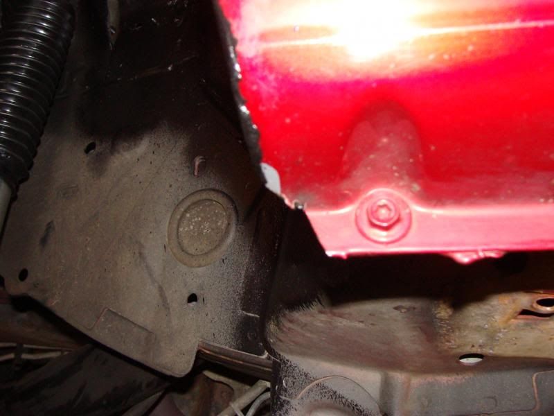

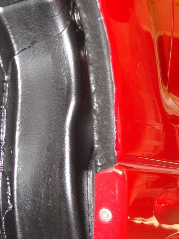

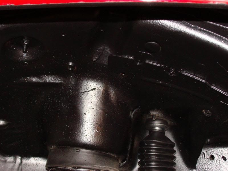

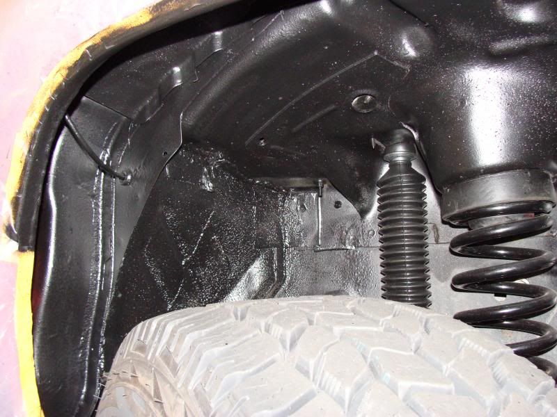

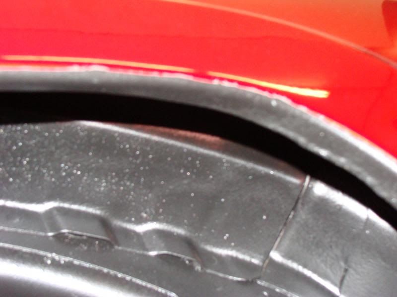

Here are some pics of the minor trimming I have done as well as spraying undercoating in the wheel well and along the downward facing portions of the fenders. I did this to protect from rubbing and rock chips. rust is our enemy here in the north east.
