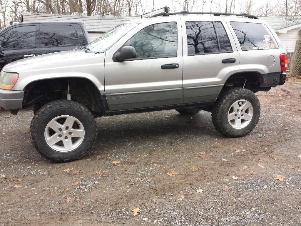

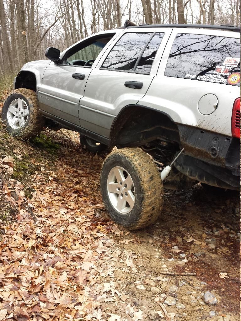

i got the 6.5 coils put together so i could start measuring for the arms.
im also selling my OME coils here on the forum.
http://www.jeepforum.com/forum/f127/.../#post19373825
now for some giant coil, short arm, and tiny tire pics

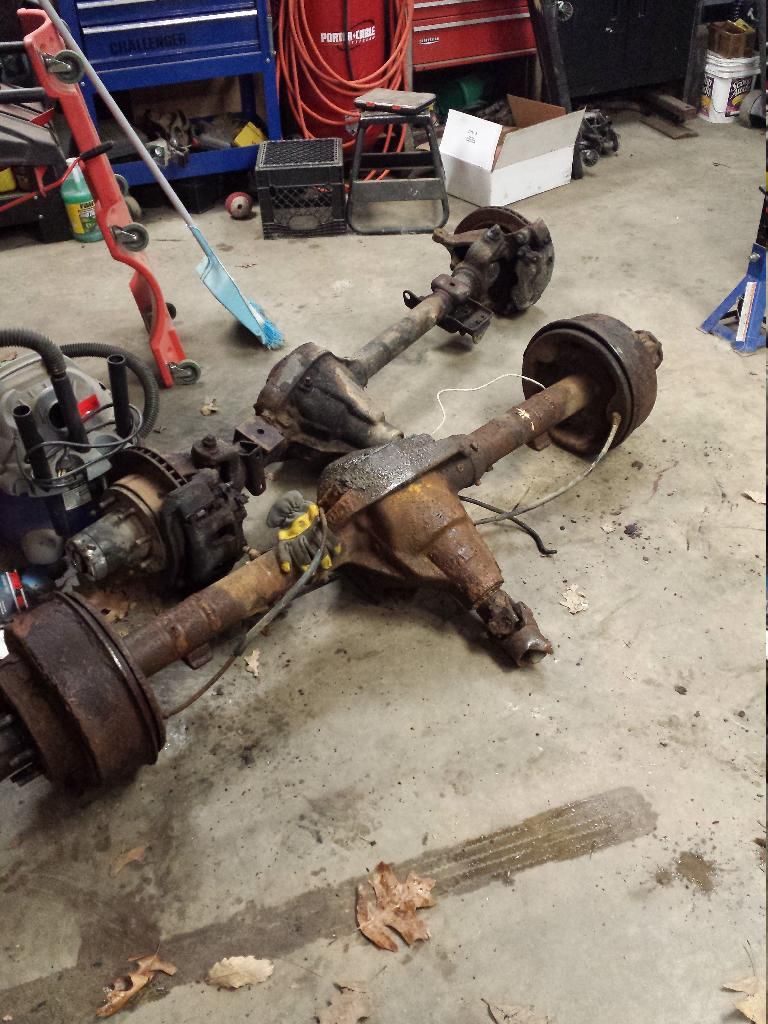

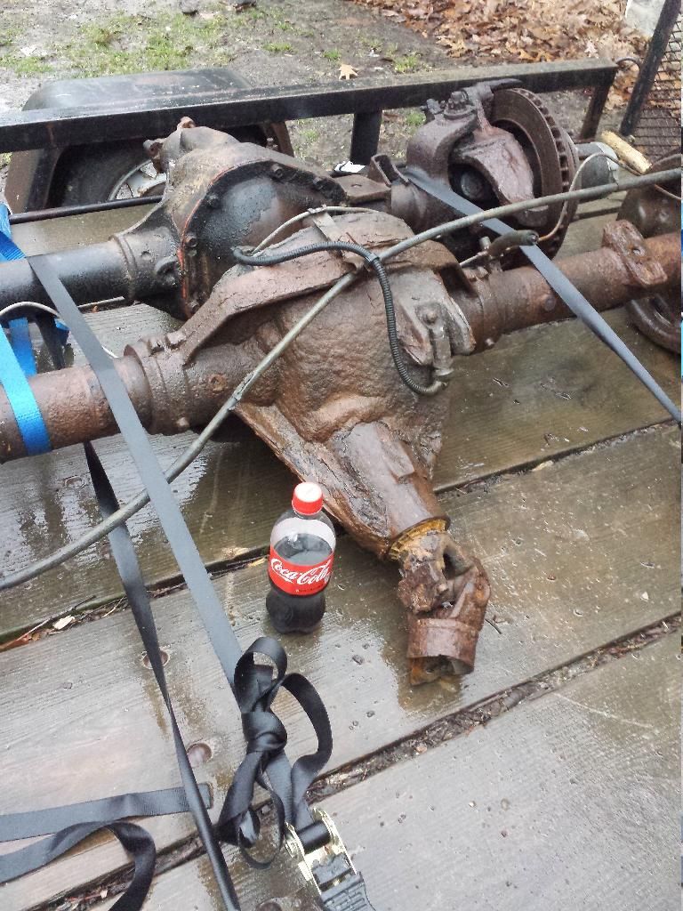

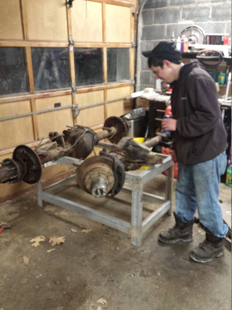

well. its been a while since i have really done anything to the jeep. I've been working like crazy and have been out of town for quite a while. I did manage to stumble across a killer deal on a set of axles. Thursday I'll be picking up a Dana 60 front and a Ford 10.25 rear from a 95 F-350. The deal was too good to pass up and I've been in search for a front end for a while anyway. They are loaded from hub to hub with brakes and everything and came right out of a truck that the guy drove to his house before tearing it down. The plan is a lunchbox locker front, welded rear, and either 5.13s or 5.38s. at this point this is cheaper than finishing the 9 and a whole lot stronger. plus i can bolt on Hummer wheels and tires no problem which saves a ton of $$$. ill update this with pics at the end of the week when i have the axles in hand. on that note ill have a bunch of ford 9" stuff up for sale if anyone is interested

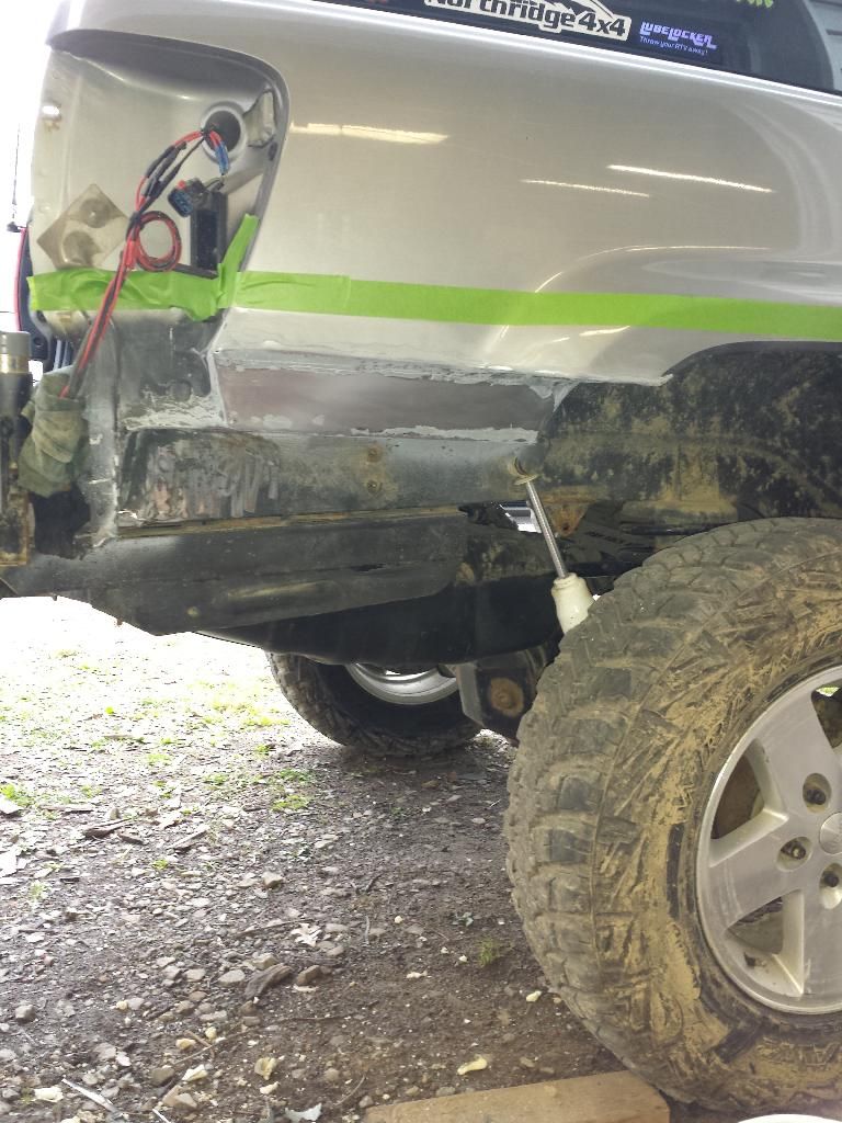

here are some pics of the goods. also the start of a well trim to the rear wheel wells. plans are to move the tank back as far as possible to make room for the sterling. possibly moving the upper spring perches depending on the placement of the 37s when its all in place

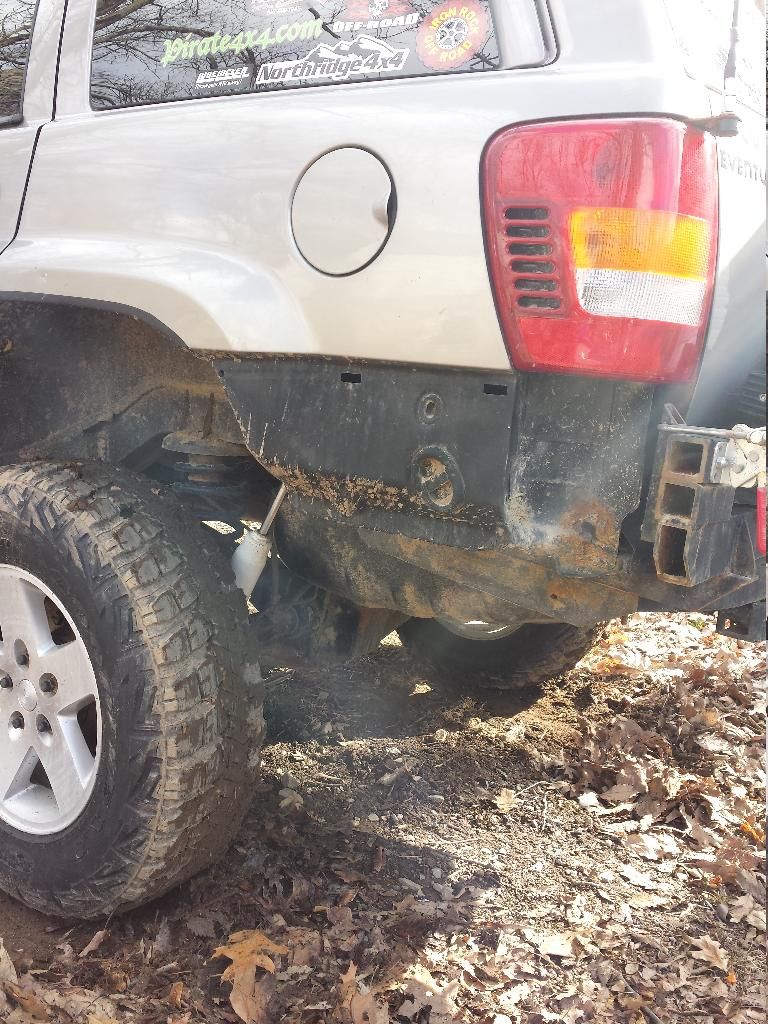

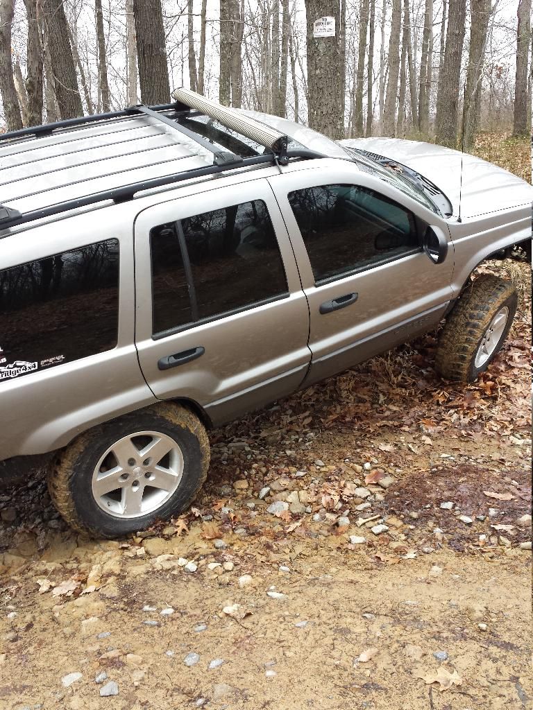

I got some days off finally and the weather has been nice so I got some work done on the jeep.
I've been in North Dakota doing a lot of this
But I finally got around to finishing the rear trim on the passenger side. It started to rain about 10 seconds after I started painting but I didn't let it stop me
I also continued on my cross member + link mounts for my long arms that are in the making.
I got a new battery for my trusty steed so I can enjoy some of this warm weather.

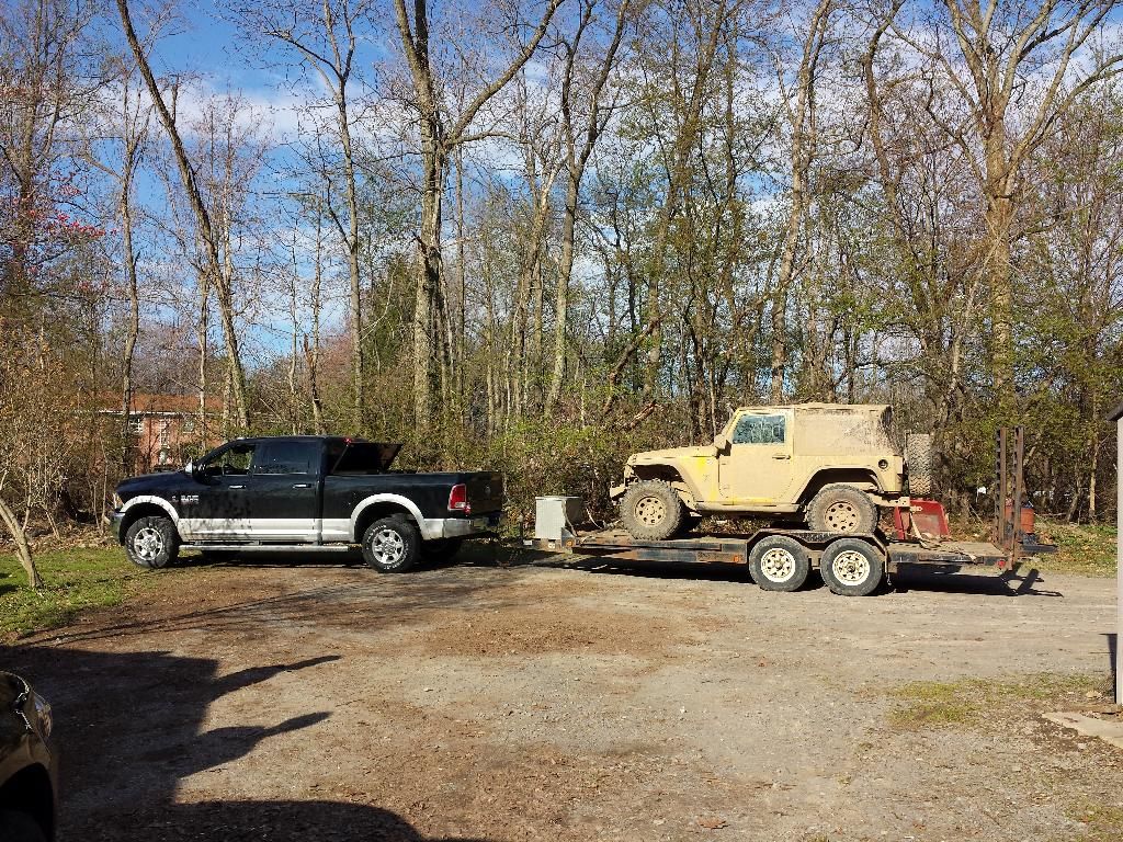

Then on Sunday after some light wheeling Saturday night I got to load up the Tow pig. I had to pull a friends JK home and he let me use the trailer to pick up another truck that a family friend was giving away. specs on the truck are 1995 GMC 3500 6.5L Turbo Diesel 4x4, 5 speed, power everything. I'm not sure what to do with the truck, I guess Ill see what happens when its up and running. It needs a little work to be road worthy.
