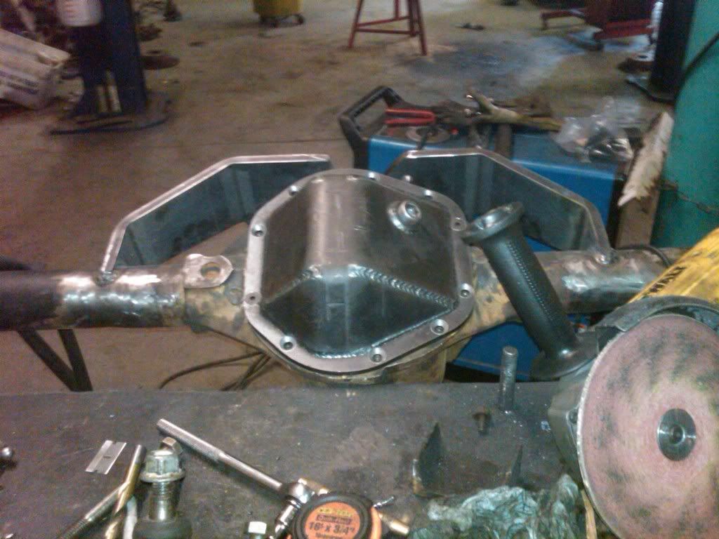

Iron Dana 44 Install
Here are some pics, more to come,
truss going across top
Iron Diff with tubes welded on it
Going to go with a steel cover and weld a support from it to the back of the truss to prevent rotation

couple more
going to have a plate across the back of the truss and then the cover will attach to the truss as well.

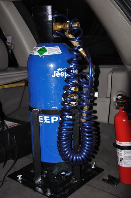

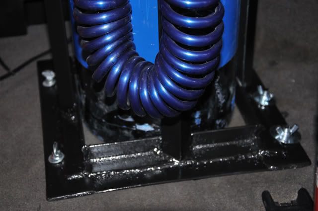

I built a rack for my CO2 bottle to secure it in the back of my Jeep when I wheel. Three wing nuts and 2 thumb screws and it comes right out.
