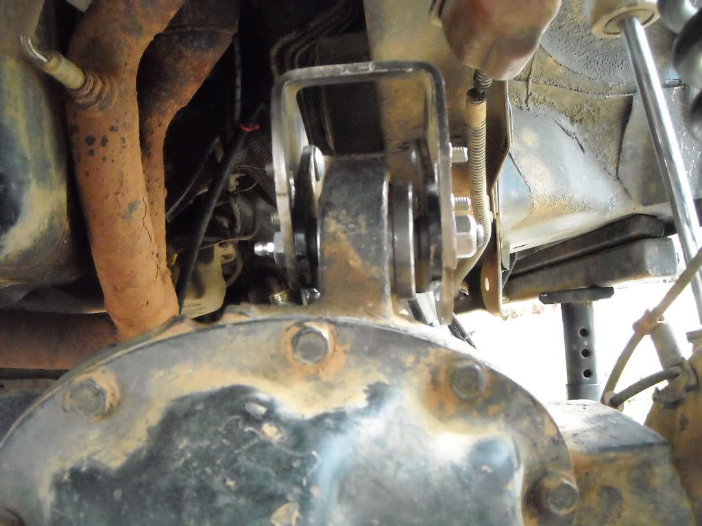

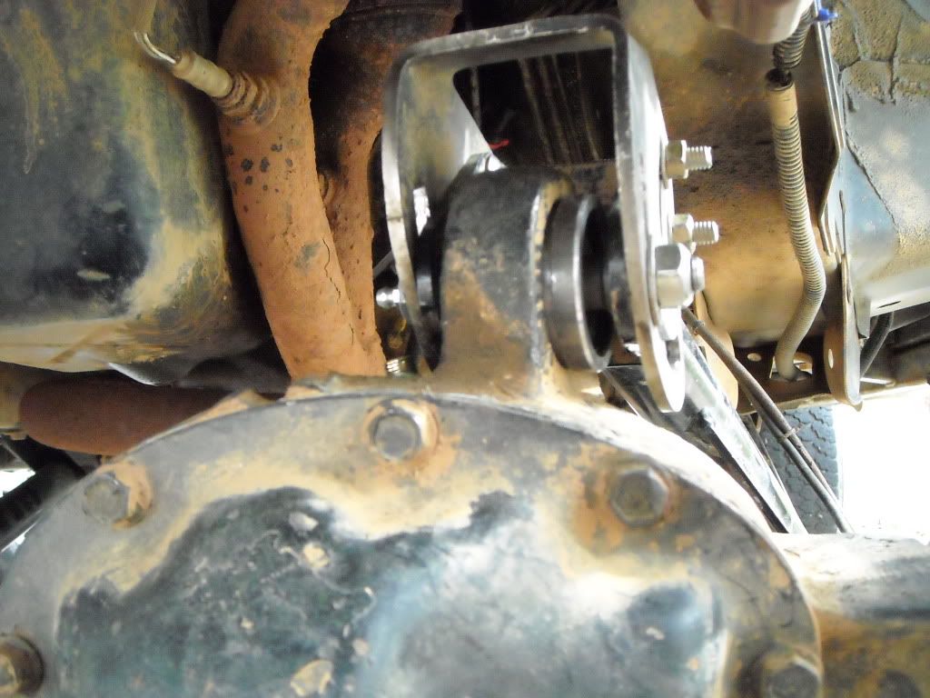

Just added a johnny joint in place of the upper control arm bushing on the diff side of the front axle
Currie Enterprises CJ Axle Parts
Had to enlarge the slots in the IRO long arm camber adjust but that was pretty easy to do with a file and die grinder.
Had to pull the tire and droop it fully to get the spring out. Used a air hammer to remove the old rubber bushing, took about 10 minutes with the air hammer then pounded the new johnny in with their driver tool and a 3 lb hammer.
