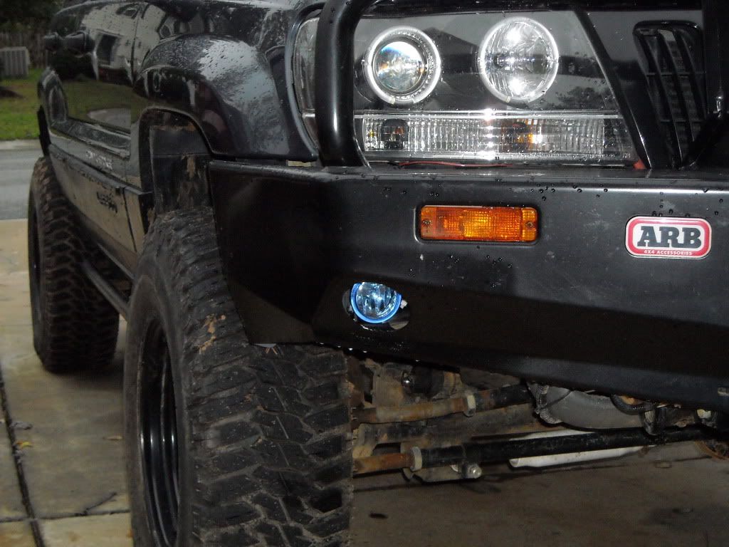

finally added some in bumper lights and removed the ones under the bumper that were all cracked from rocks

I've been thinking about doing the same thing with some lights in my ARB. The marker lights in my ARB are not wired in, so I'm looking at filling the hole and adding some round lights ~ 4" wide. What did you use to cut the hole, just a hole saw?

I just used a bi-metal hole saw from home depot. real slow but effective.
