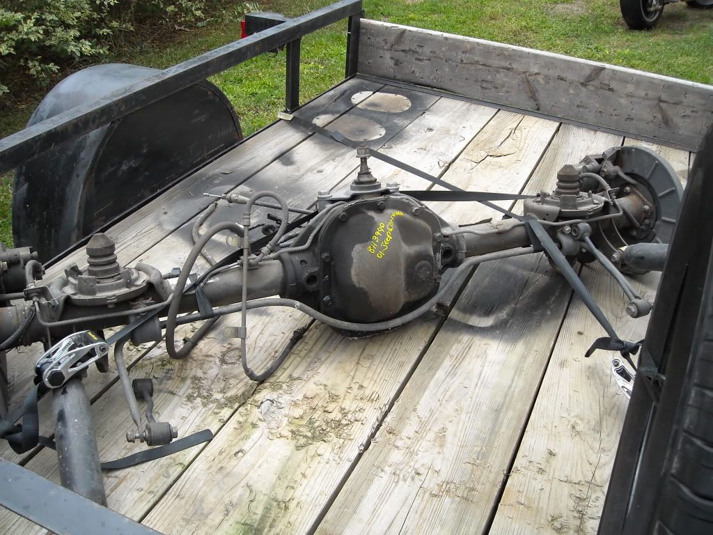

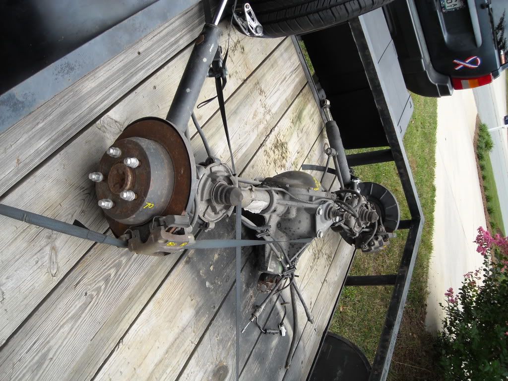

Look what I found at the JY. Low mileage, complete, open D44a.
Going to have to regear the front now, any suggestions on lockers? ARB, Eaton, Ox? Want something cheap and reliable, lunchbox is out for the front since I have fulltime 4wd on the 242 that I like to use in the rain, snow and gravel. Will probably toss an aussie in the rear eventually.

Go for a EATON AKA Detroit Tru-Trac It's an AWESOME lsd Doesnt require Friction modifiers to run and Use's Worm gears in stead of clutch packs and BS Completely seemless on the road untill u slip

x2 for a tru trac

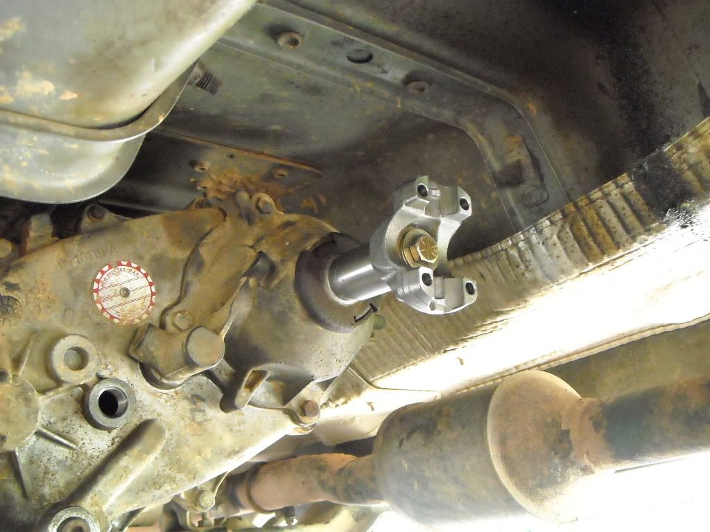

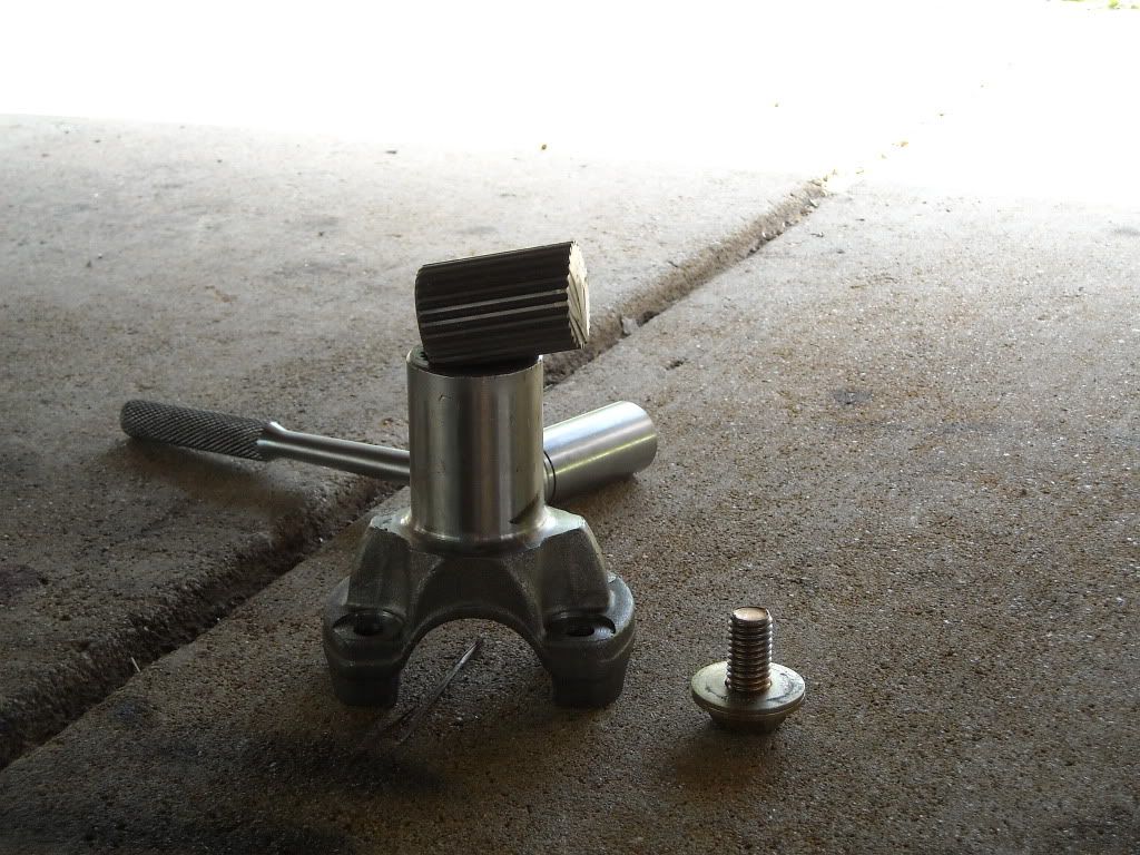

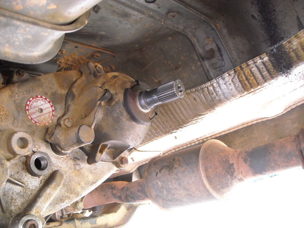

Well I have the D44a installed that I got a junk yard. I think I am going to do the hack n tap on the TC output shaft and get a DS made. Also got a classic tube 5th brake line made so all the flex is now SS Braid.

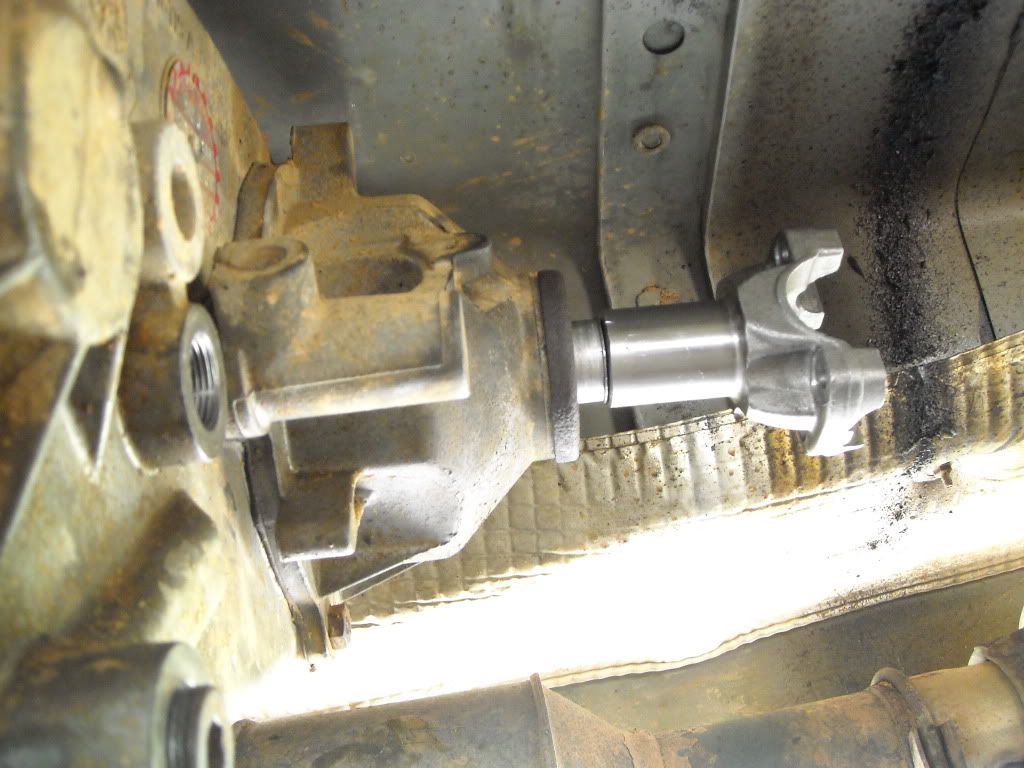

Well just did the Hack n Tap on the TC output. Driveshaft is ordered, double cardan on the output and single on the diff.

Nicely done. What kind of bit did you use to drill into the output shaft? Is that the Hack n Tap from IRO?

yes that is the IRO Hack n Tap and I bought their drill bits and tap for $20. The 242 does not have a fully hardened shaft, it is only case hardened so cutting and drilling was pretty easy.
On the gearing I am not sure, I may regear both to 4.10 got to drive it first and see if 3.73 is enough for trailer towing. I also plan a ARB for the front when I regear, that will happen in the next few weeks.

Good to know about the Hack n Tap. I've kept my eye on it but never really saw anyone use it or say anything about it. It looks nice.
After doing my 44a swap, I still think 3.73 isn't enough. IMO, it still feels about the same. 4.10s would be more appropriate. I'm just waiting to regear both axles to 4.10 or 4.56 and throw a Detroit locker in the front. Just need money.
