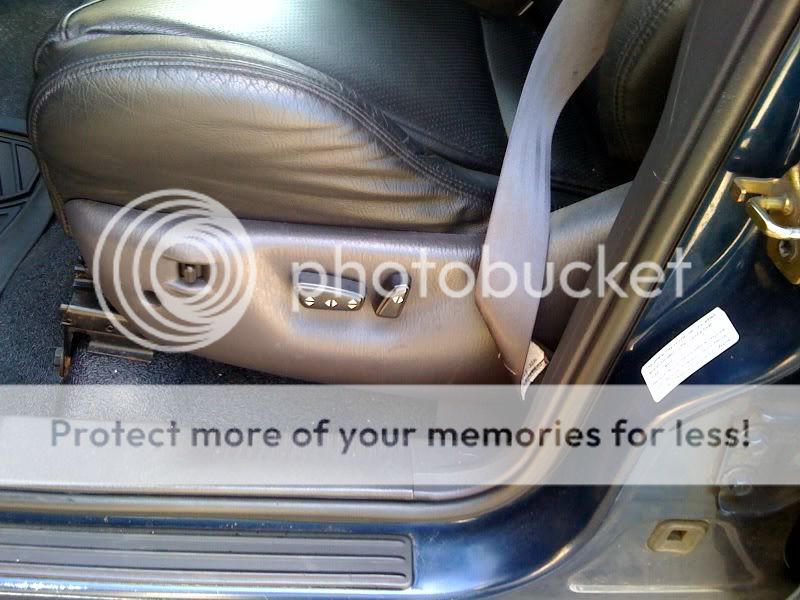

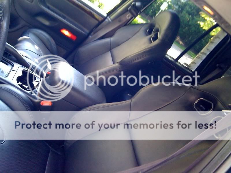

Here`s a few pics , I kept the factory frame bases, pulled the seat all apart. I managed to keep the ten way power and lumbar support....Only now they are Corbeau`s They are awesome on a long road trip.
Factory side covers and controls

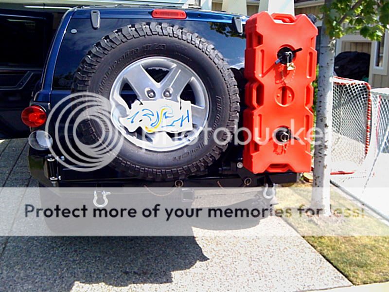

Today`s Project
And a Shot of the Rear
fasteddy47 is offline
How do you like those gas tank things? I was looking at buying 2.

Seats looks good. I was planing on doing suspension seats for offroad more so I'm not sure if I could get mine to fit the stock brackets but yours looks clean.
Snorkel came out good too. Do you have stock intake or aftermarket?

The Corbeau's brackets fit onto the factory brackets, the big thing was the Lumbar and power adjust, I had to tear into the Corbeaus. The bolsters, bottom and back of the seat are all high density...... they really soak up some of the harsh jolts....... Much better than factory seat.
The VX2000 is wide across the base....the inner bolster on both sides touches the console when you're sitting in them.... But I needed a Wide seat for my big Azz.....
