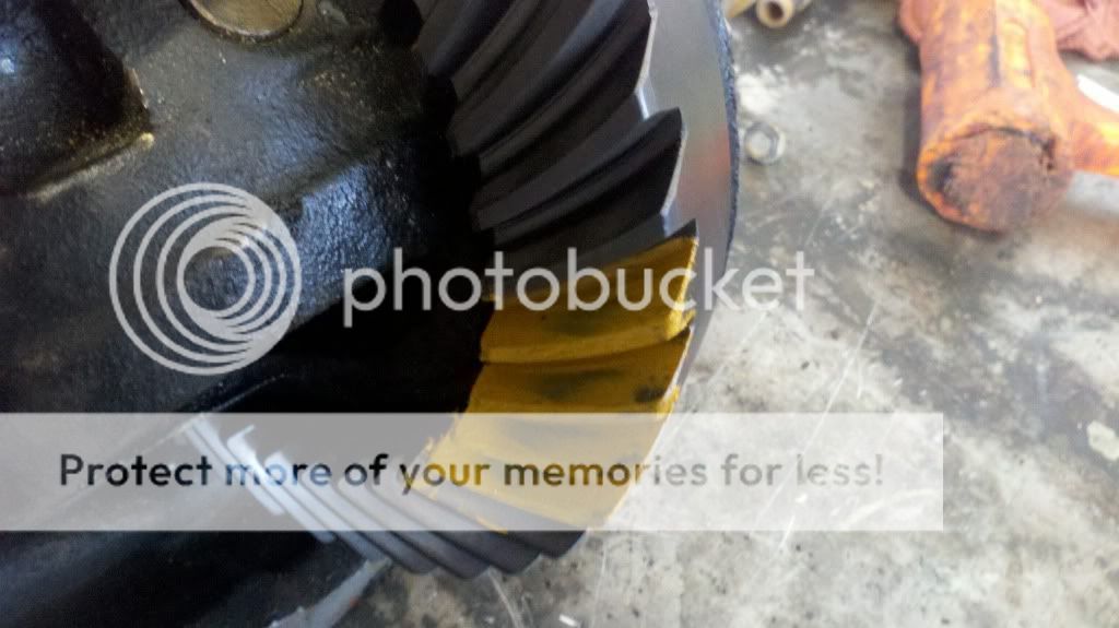

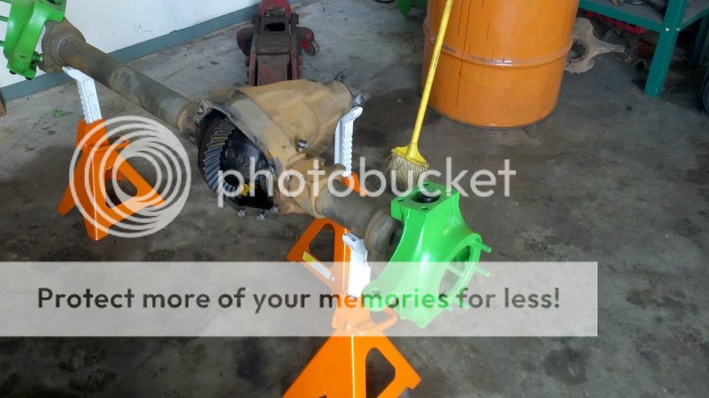

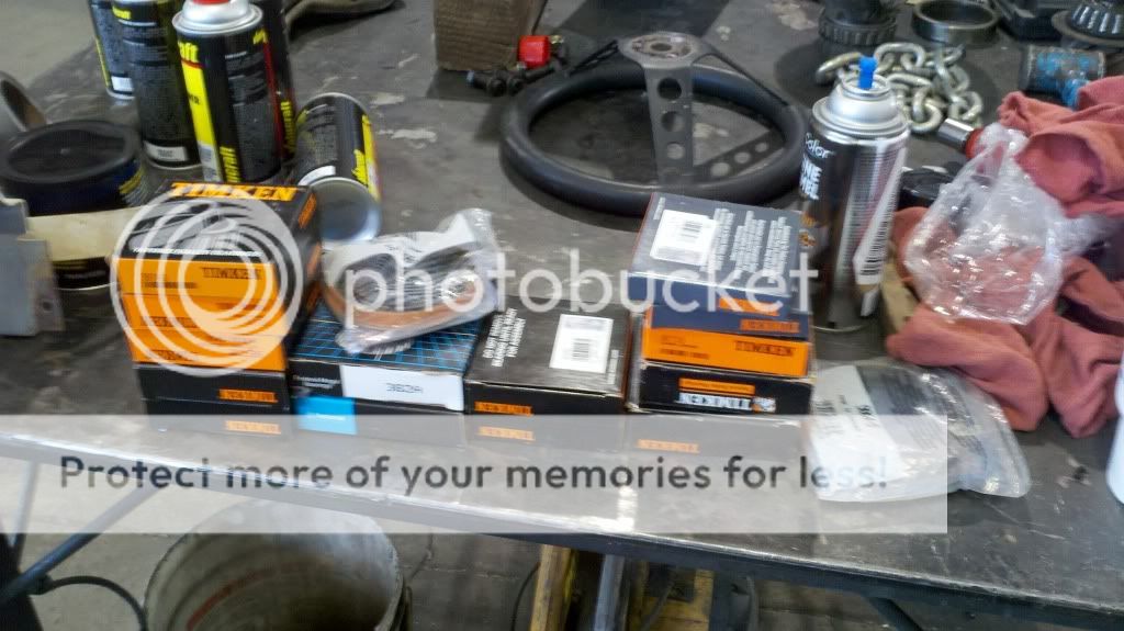

Got a little bit done today. Got all the bearings, races, and seals for both axles.

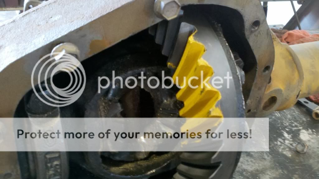

got the gears set up in the front axle.
First pattern looked good to me so im running it.
got my knuckles painted and new kingpins installed.
****in FOA is pissing me off I still haven't received my coilovers. I am also waiting on my ballistic joins.

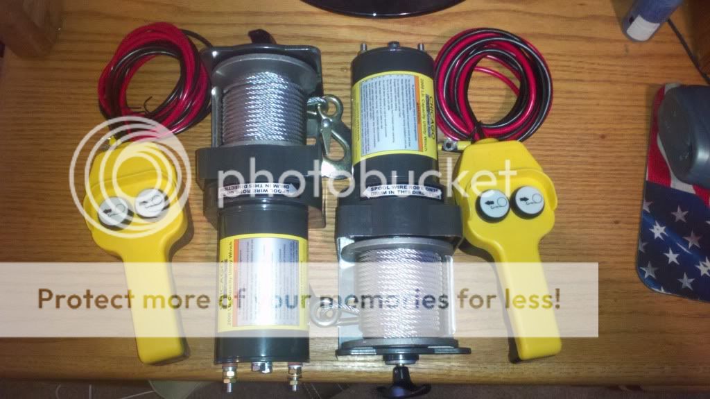

went to the store today and bought my suck down winches for the front and rear.
i will be able to take the winch controller apart and reuse the the buttons that they came with

Forgive me for my stupidity, but I have never heard of a suck down winch. What are they used for?
Edit: after thinking about it I'm guessing they are used to compress the suspension when it may be needed. I just can't figure out when it would be needed.

a suck down winch is used for compressing the suspension on real steep inclines to help lower your center of gravity. when i am done with my suspension it should sit about 8'' over stock and with the 37's it will be way the hell up there. you can also use them to held you get more traction to get over the tough spots on the trail.
