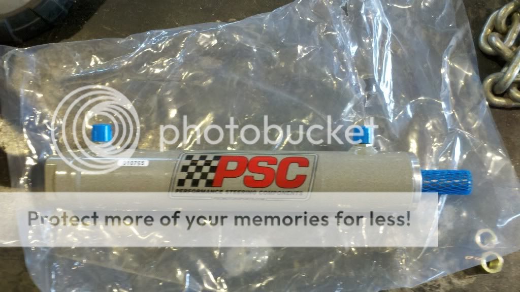

Got a few more parts in today.
And my 37's
tomorrow I will reassemble my axles and get them ready for when ever my coilovers show up.
