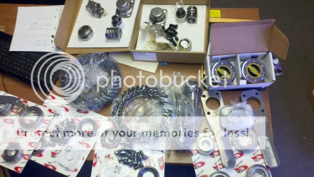

had a ****ty start to my week off. got on days off and went up to the shop to fix my t case no big deal right. wrong!!!! got there went to start it for the power steering to get it in to the shop and the battery was dead, charged the battery tried it again and nothing. still trying to get it running but i did get it in to the shop and go the t case changed out with another 231.
i also got a shipment of parts today
That's gears for front and rear 4.88 install kits crane hi steer arms with caps kingpin rebuild kits and warn premium lockouts.
