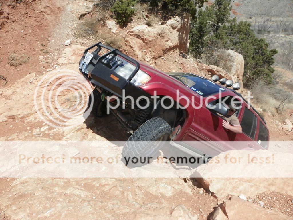

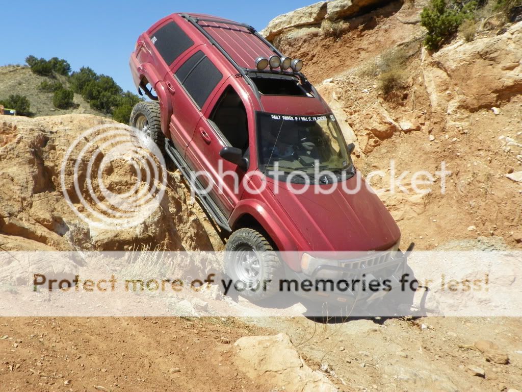

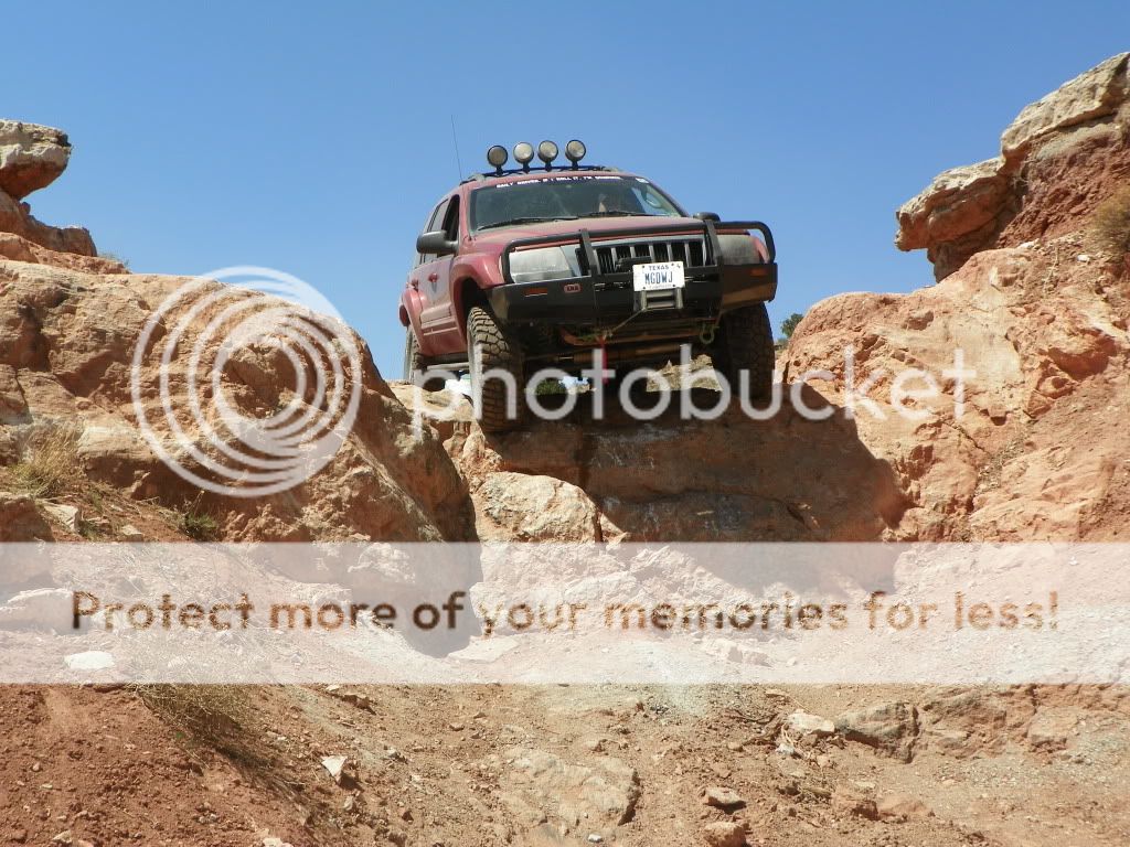

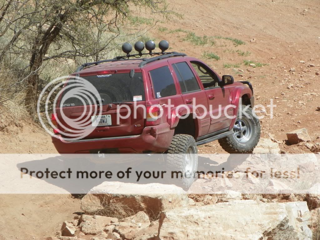

we are still trying to figure out how/why the tcase blew up. i spent about 5 hours wheeling got on the highway to leave almost got up to 70mph started shaking real bad and then came apart. when i swapped in the 231 i measured the drive shaft at ride hight full flex and at full compression. they where all with in the capabilities of the stock driveshaft.
here a a few pics of yesterdays wheeling
