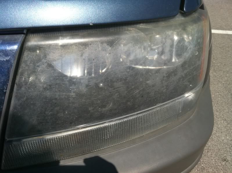

Cleaned her up.
Before and after headlights.
So clean
I'll need to snap some of the inside tomorrow.
I gotta address that clunking noise, it is most definitely the drivers side front and I can shake the Jeep and hear the popping, so I imagine its the shock issue we discussed.
I'm starting to get nervous. Maybe I'm just being overly sensative, but I feel like the tranny is slipping. I guess time will tell.
Oh, and why are there 5 TRE's and not a single zerk in sight?
