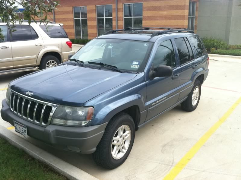

I am the proud new owner of a 2003 Grand Cherokee Laredo!
So this really isnt a build thread. Its more to keep record of progress im making on the new Jeep; maintenance issues im resolving, as well as getting help and advice for future issues.
6-cyl
92XXX Miles
4WD
Leather
Sun roof
NO blend door (whew)
Interior and exterior are IMMACULATE
Recently replaced window regulators and heater issue.
Newer tires
Tranny shifts like a dream
Part-time and full-time 4WD
This will be my wifes Jeep to nicely compliment my TJ.
Now the quick fixes I could use advice on.
1. Slight clunk over bumps - I believe thats a shock issue, am I right?
2. Auto transmission fluid change. Ive done it on my manual, but have heard that its different on automatics. Is it still a DIY capable job, or should I just have it done professionally?
3. Steering wheel gets a slight shimmy between 40-50 MPH, not enough to be worried, but its going to bug me... Fixed with alignment and maybe a new stabilizer?
Thanks for looking and helping, I am super pumped. This is going to be my wifes daily driver, but will be so nice to take on trips and whatnot. So spacious.
