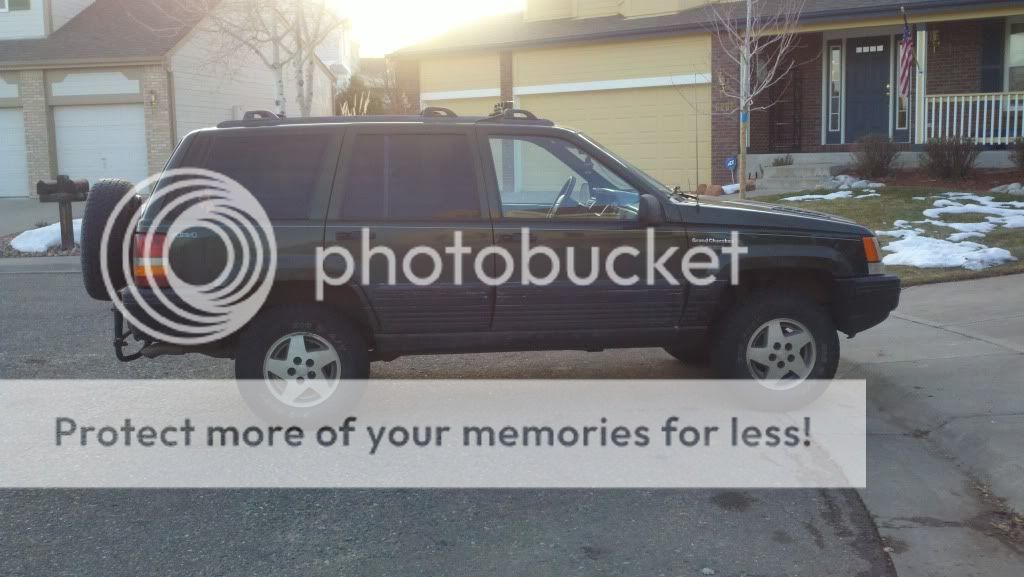

Some pictures from earlier today when I was bored and went exploring:
My Dad and I are also looking at attending the All-4-fun in Salida Colorado:

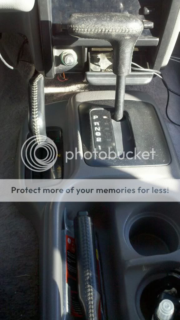

5.9 shifter handles installed

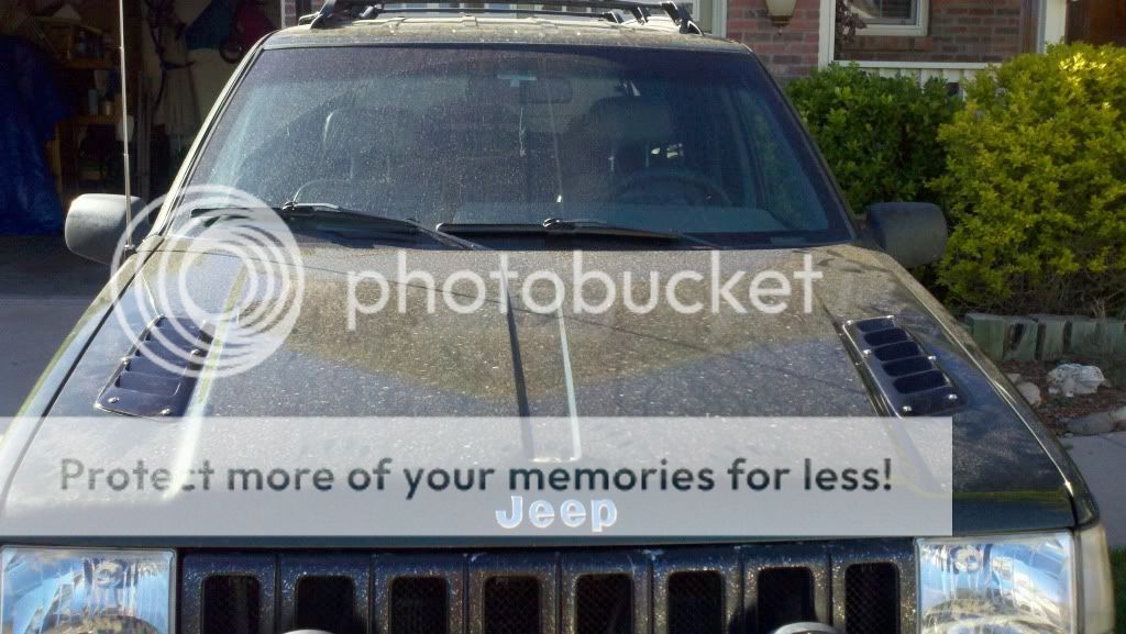

redid the mounting on my hood vents and repainted them
I just drilled out holes where the screws were holding them in place before and used buttonhead hex bolts and nylock nuts to secure them in place because I got tired of the screw i was using to hold them in place falling out or wiggling their way out....and I like the look a lot better.

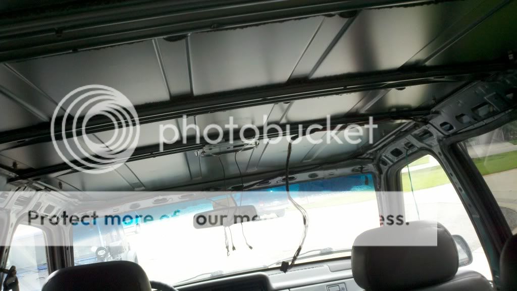

working on installing the sound bar with center support bracket and redoing the headliner
but went a little further with this project
because of:
now I'm looking into which bedliner to get to bedline the floor before I reinstall all the trim

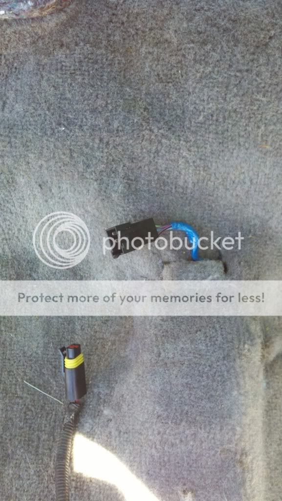

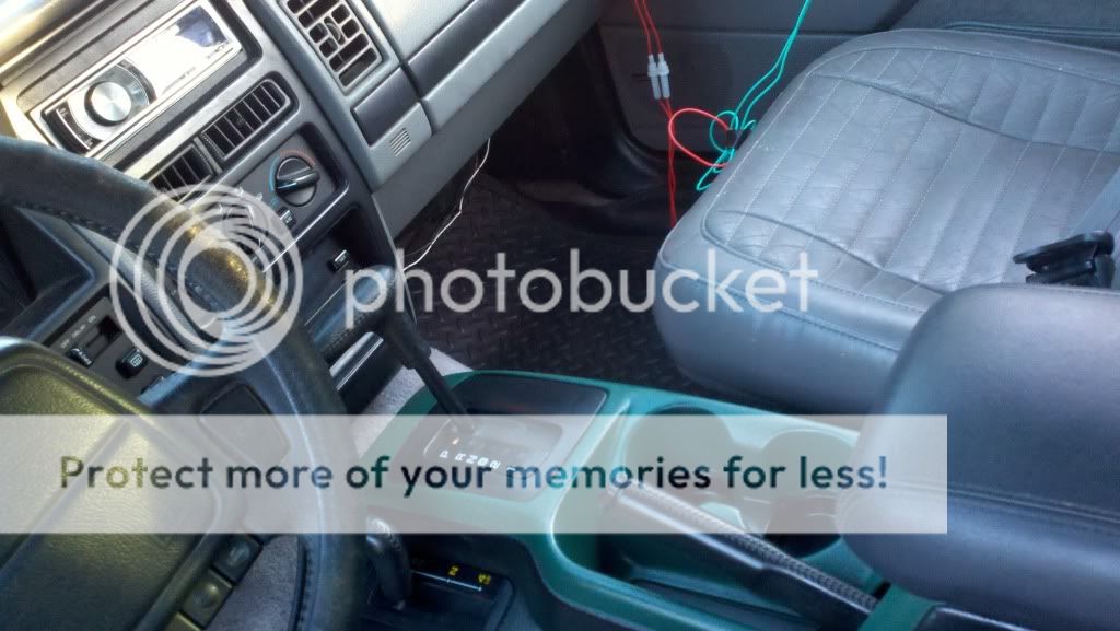

the only thing I am confused about is this connector:
the one with the yellow plugs into the seat, but I have no idea what the other one is and it was only on the passenger side
Got the headliner back in too, but its too dark to take a pic of it, plus I still have a few more pieces of trim to install. I'll post pictures once that is finished sometime tomorrow or the day after

I believe the second connector on the passenger side plugs into the seat as well. At least that's how it works in WJ's. It's got to do with the control or power or somesuch for the heated seats. I only know this because I pulled WJ seats out of a jy Jeep and put them in my ZJ. The seat on the driver's side had some wires that went under the carpet and came out over under the passenger seat, which plugged into it. I think there was just the one connection on the driver's side, and those wires came from it. I'm not sure why there were two on the passenger side.
And I could be wrong as we're talking about a ZJ here.

Awesome, thanks for letting me know....that does make sense that it would be for the heated seats...I dont have heated seats so it makes sense that there would be an extra plug.

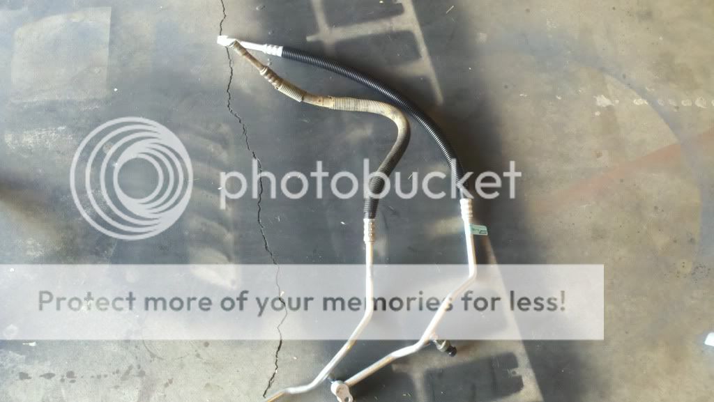

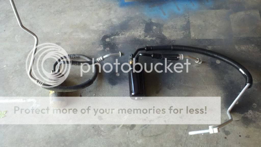

old accumulator vs new accumulator
old discharge hose vs new
fixing the ac wasn't very hard. Only problem I had was once I got to the shop,
they found a leak at the compressor manifold and told me I need a new manifold or compressor since it wasn't sealing all the way down...
all I said was "thanks for trying, looks like I'm going to the junkyard tomorrow"....
10 minutes later they come in and tell me they think they got it to seal all the way and are going to charge my system after they finished evacuating it...

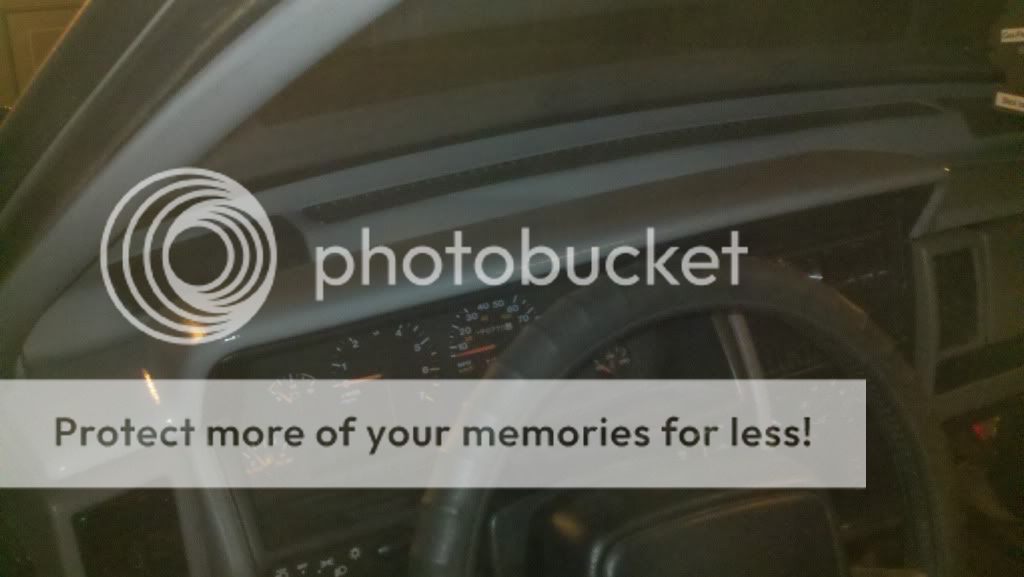

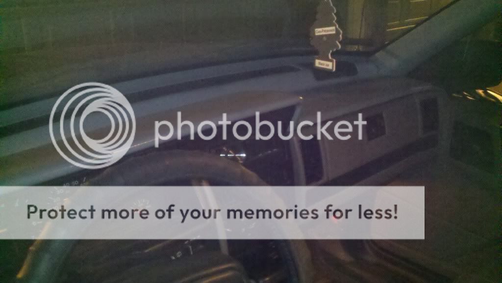

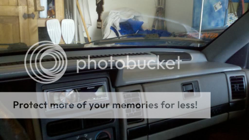

Better pic of the dash:
I decided to paint the Word JEEP on my glovebox the same green as my Jeep:

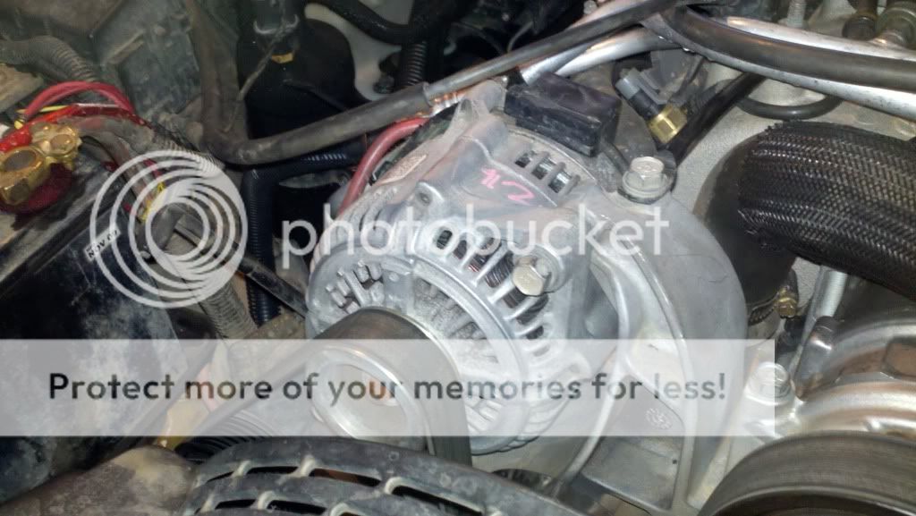

I replaced my alternator with one from the junkyard the other day since mine wasn't keeping up.
This one is a 136amp alternator and has a tag on it saying it was rebuilt in 2008.
At first it didn't sound too great, but I bought it anyways since I have 30 days to bring it back for a refund...
A bearing sounded bad, but I cleaned it up and sprayed some penetrating oil into it, and so far it sounds fine...
no howling bearing or any other weird noises and is able to keep up unlike the stock 90amp I had.

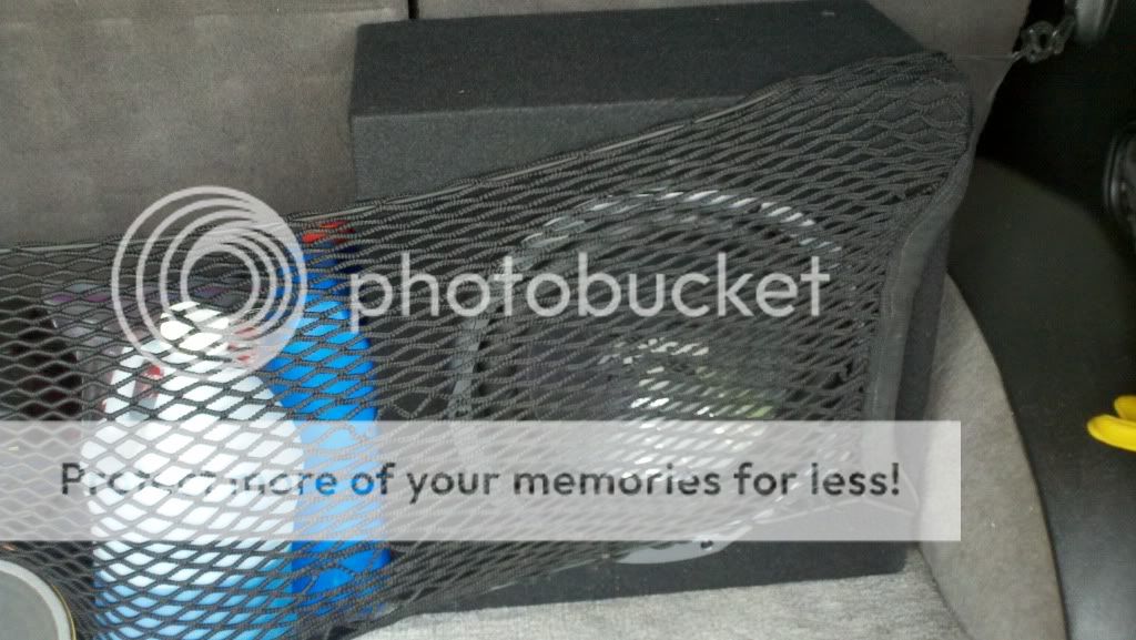

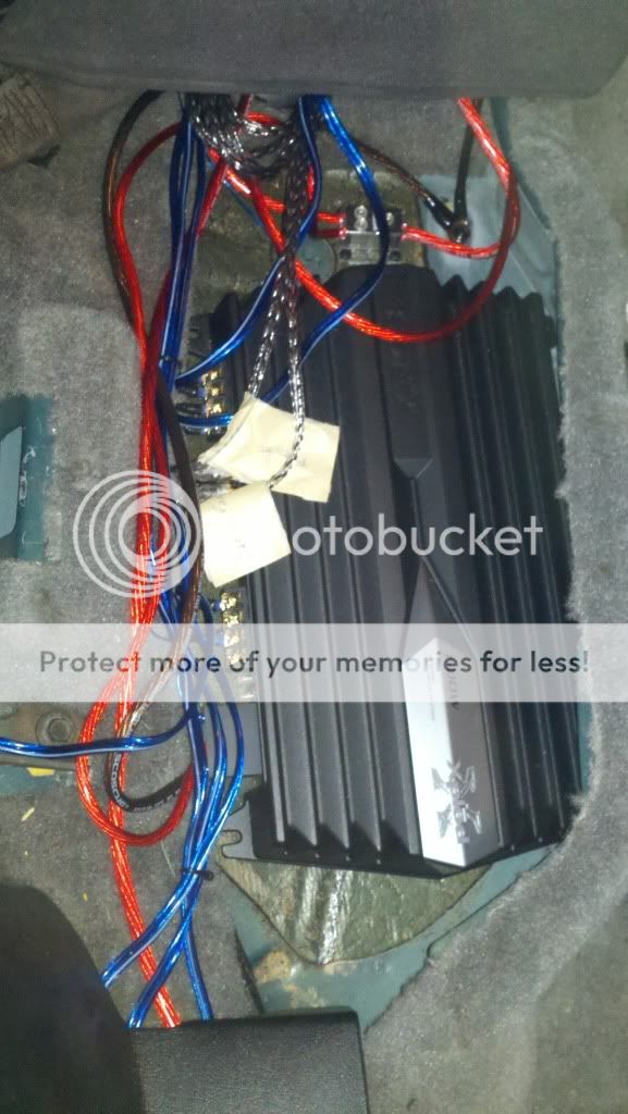

Sound system.
soundbar installed:
This is under one seat, but there is another under the other:
One amp powers the rear door speakers and soundbar, the other powers the front speakers and sub.
I need to clean up the wiring a little more but I'm too lazy right now. lol
sub:
The sound system sounds great compared to how it used to sound...partly because I now have a sub and partly because I fixed a lot of rattling noises in my jeep

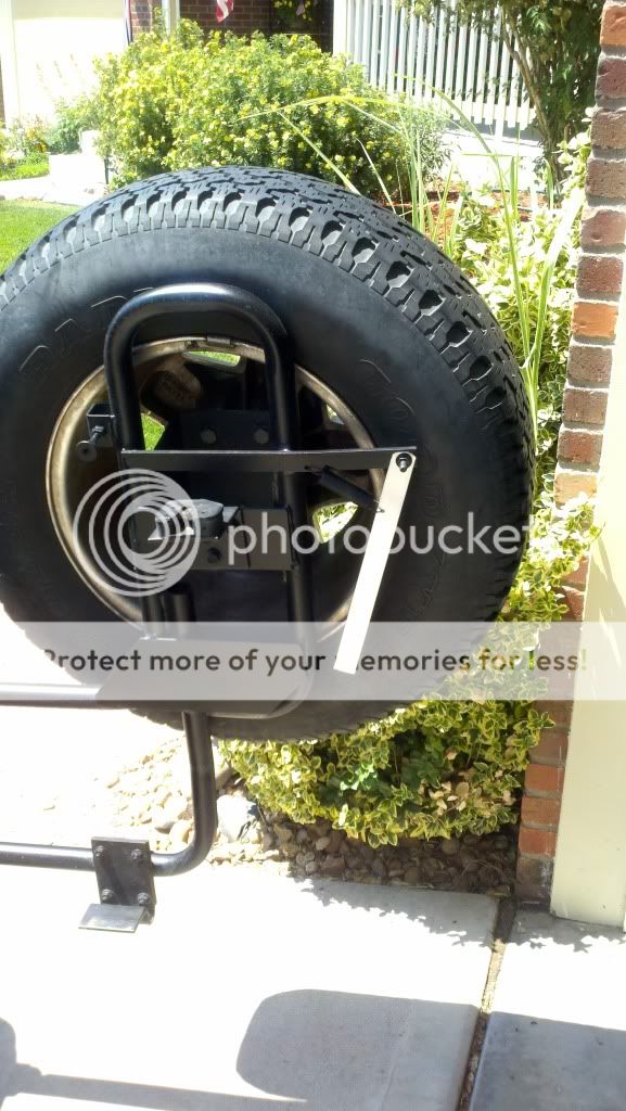

Currently I am finally getting around to finishing up the handle on my tire carrier...
when i got it, the old one had rusted off so I've been working on making a new one from some aluminum from home depot...I'm almost done with it now, just got tired of working in the sun:

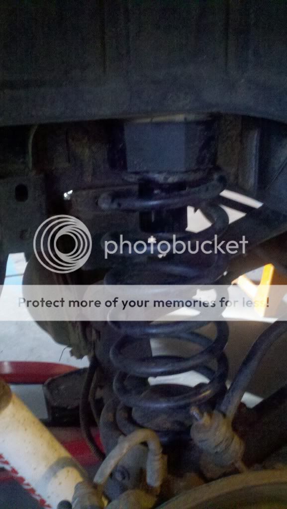

2" BB
extended the rear spring posts

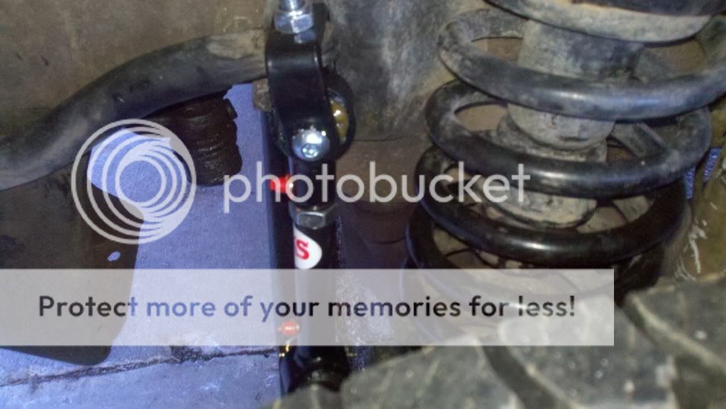

installed some JKS quick disconnects...Just have to install the posts that mount to the skid plate.

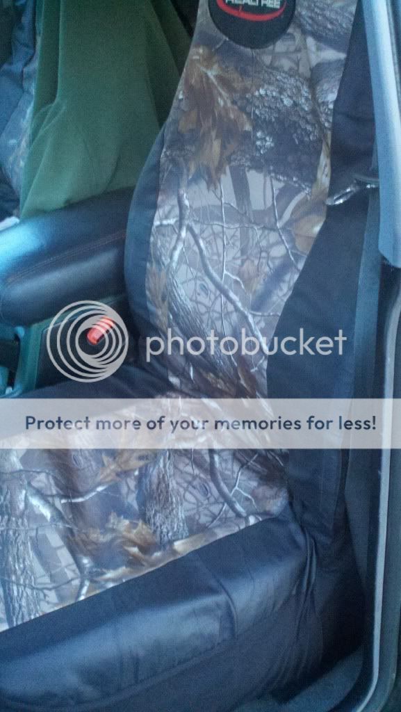

seat covers

just went through this whole thread. in case you havent found/figured out what the connector in that pic was, the one with yellow as stated is for seats, and the other one is the plug that a scan tool such a the DRB2 that chrysler group dealerships would have
