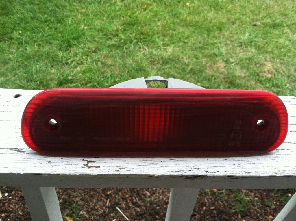

Tinted tail lights.
So this is the first mod I have done, and that's cause it was cheap haha. Felt so good to finally do something to it! And I am happy with the results.
A light sanding with wet 1200 grit, cleaned and degreased.
First coat, 3rd brake light turned out a little darker then I wanted.
Ready for tint.
Wanted a light tint, not black, I think they turned out just right.
Also put a clear coat over the tint to help protect it.
Finished.
Pretty dark, but you can see the light perfectly when brake is initiated.
I used Rust-Oleum tint, I wanted VHT Night Shades, but they were sold out. It worked well though, also used Rust-Oleum clear enamel. It was $20 total, and maybe 2 hours of actual work time, waiting took the longest.
