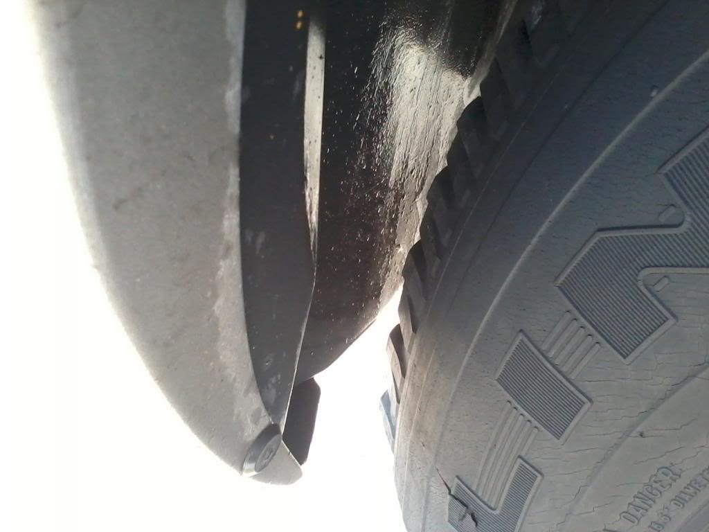

hard to argue when you buy a new Jeep that has "almost" new Michelin tires on it, but these 245/75r16's are rubbing pretty bad during tight turns. Guess Ill just have to live with it till they wear out becasue I will NOT be cutting any on this jeep
