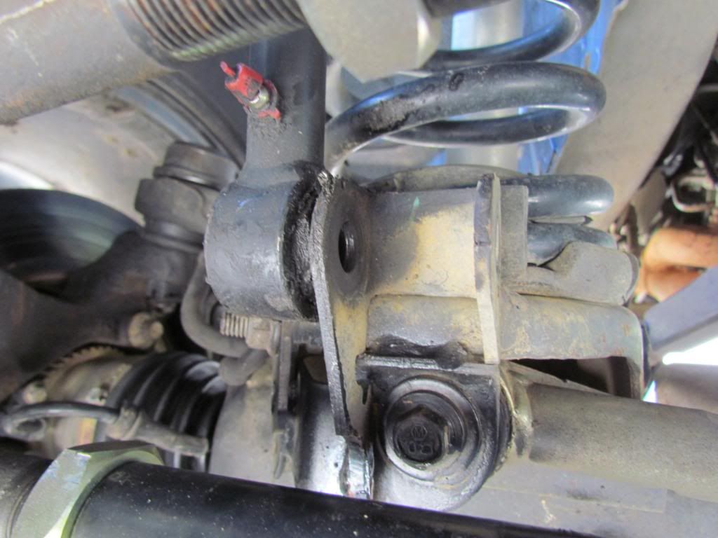

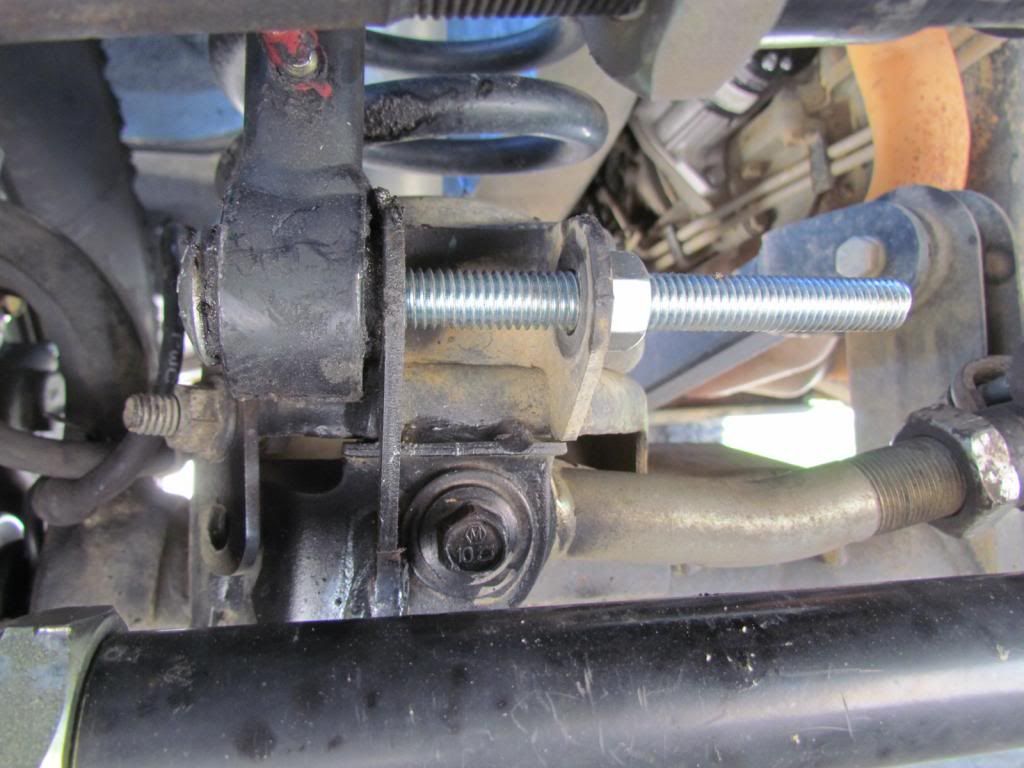

So I went and bought a new Akebono for the drivers side today as well as new rotors. While I was under there, I noticed one more reason I might have been pulling to the pass side during breaking:
I dont know when that fell out but it must have been early on during the week. SO I used what I had available until I can get a new bolt assembly from JKS

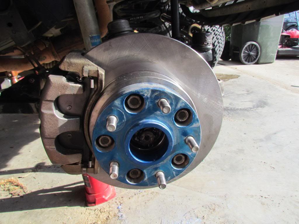

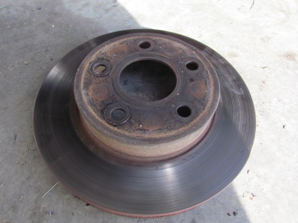

Out with the old rotors
IN with the new

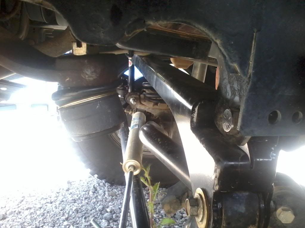

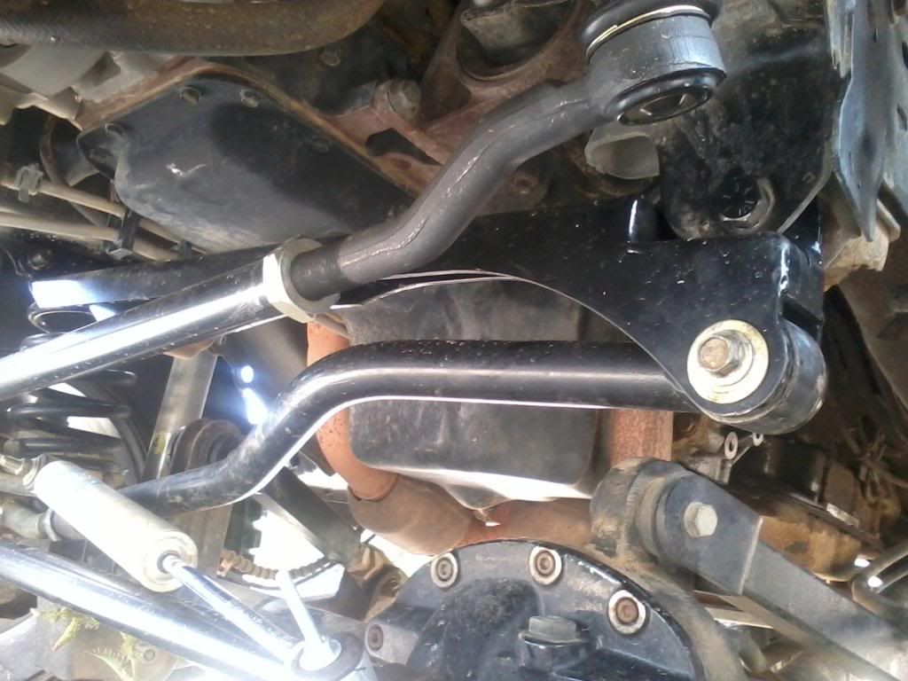

did a quick little flex test on break. didnt have much time so I didnt disco the front. I need to try and find a good spot to test it out this weekend. Im trying to figure out if my JKS trac bar is going to contact the new IRO drop bracket when the pass side is stuffed.
As you can see , the JKS trac bar bends forward towards the front of the jeep. Im thinking that when disco'd and fully stuffed, the trac bar might actually hit the drop bracket limiting uptravel.
If so, Im probably going to torch out an arch in the bracket right where it contacts. Im not to worried about weaking it. Its 1/4'' plate. If I go that route though, ill probably end up welding the bracket on rather than just relying on the 9/16'' bolt........
